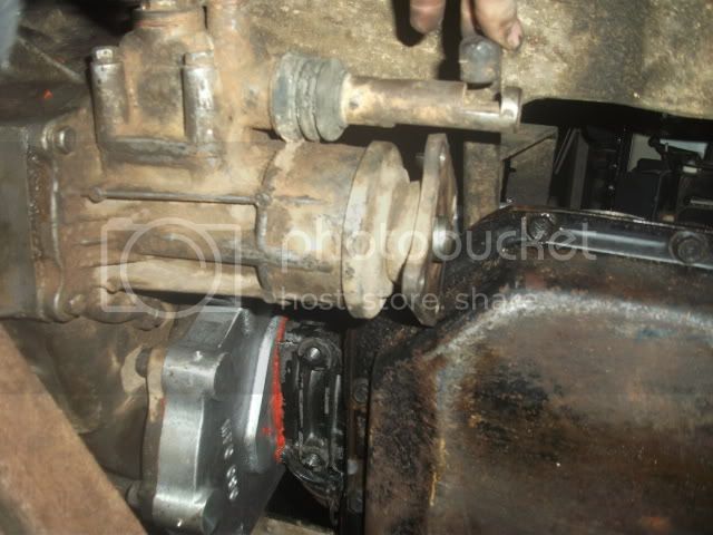

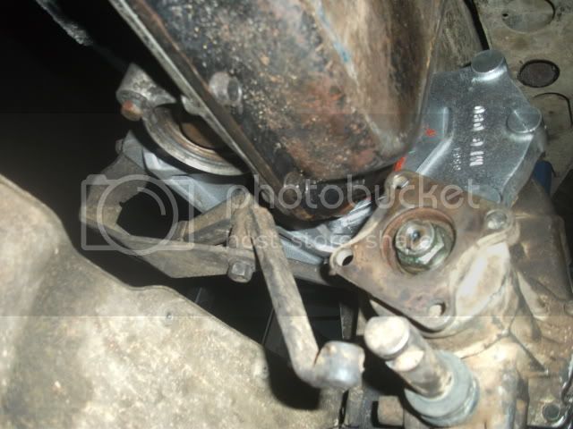

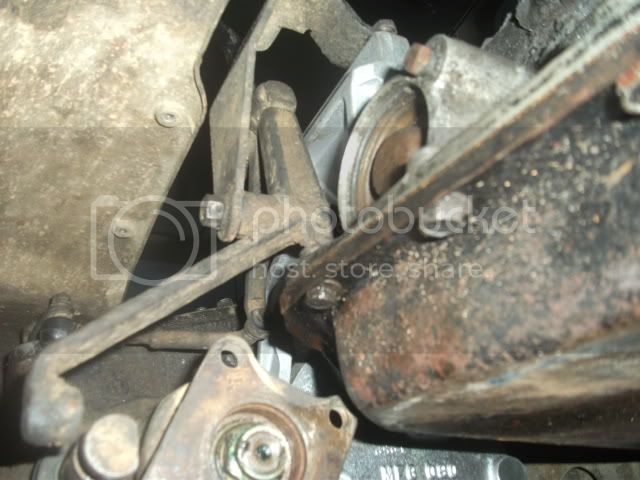

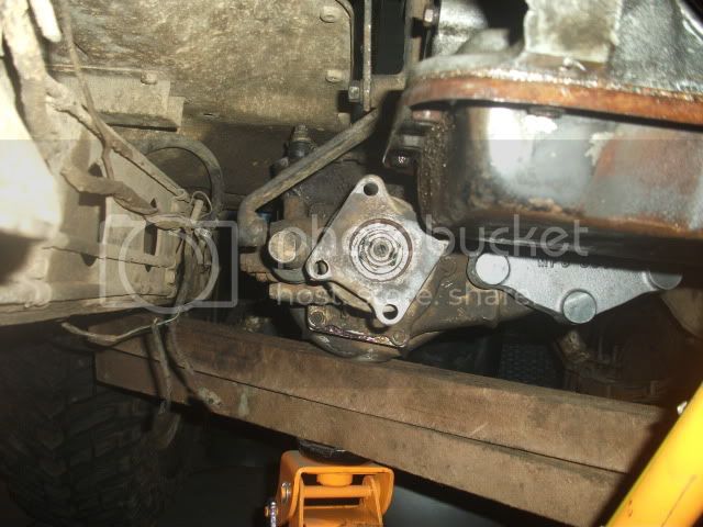

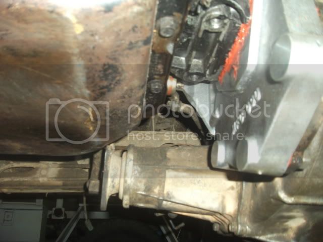

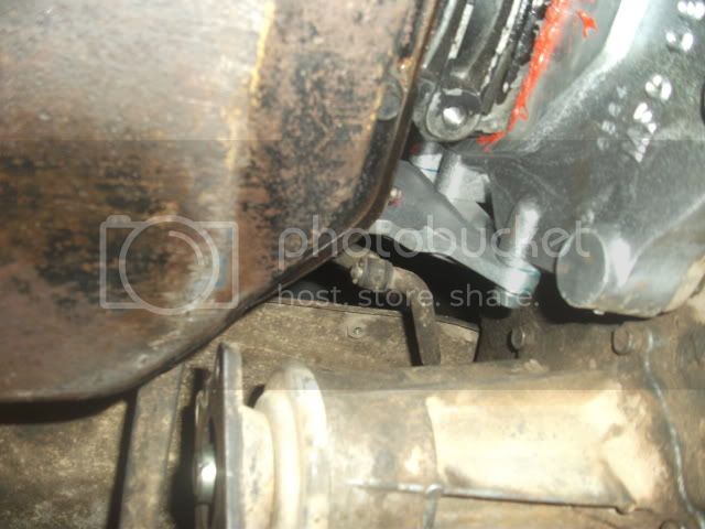

ok slowy doing the swap and would like to see pics of what you have done to fit your front drive shaft
I have seen this done with a hammer. I would suggest that you remove the pan on the TH350 and see how much room you have in that corner to move the pan in and up. You can get those pans anywhere, so you can afford to experiment a bit. Also, Advance Adapters sell a miniature universal joint. I don't think it will handle a lot of rough and tumble, but might help if you are not into major rock stuff.
Don
2X on the smaller Spicer flange and yoke. I have one on my 700R4 and have had no problems, though I did need to do a little more than "dimple the pan".
I just rebuilt my th350 - I have the thin downey - hate it ! the small u joint helps a lot.
no pics now, I wil check later.
you have to hammer out more than a dimple - also use a thin headed bolt in that spot.
but whats gets me is after a while the trans fulid leaks into the transfer case
fieldsken1 - whose adaptor did you use ?
- Paul
- Paul
i used sealant on every think as i have seen just about every one of them leak
i got a front drive shaft made up useing hilux u joint as there smaller then the landcruiser
