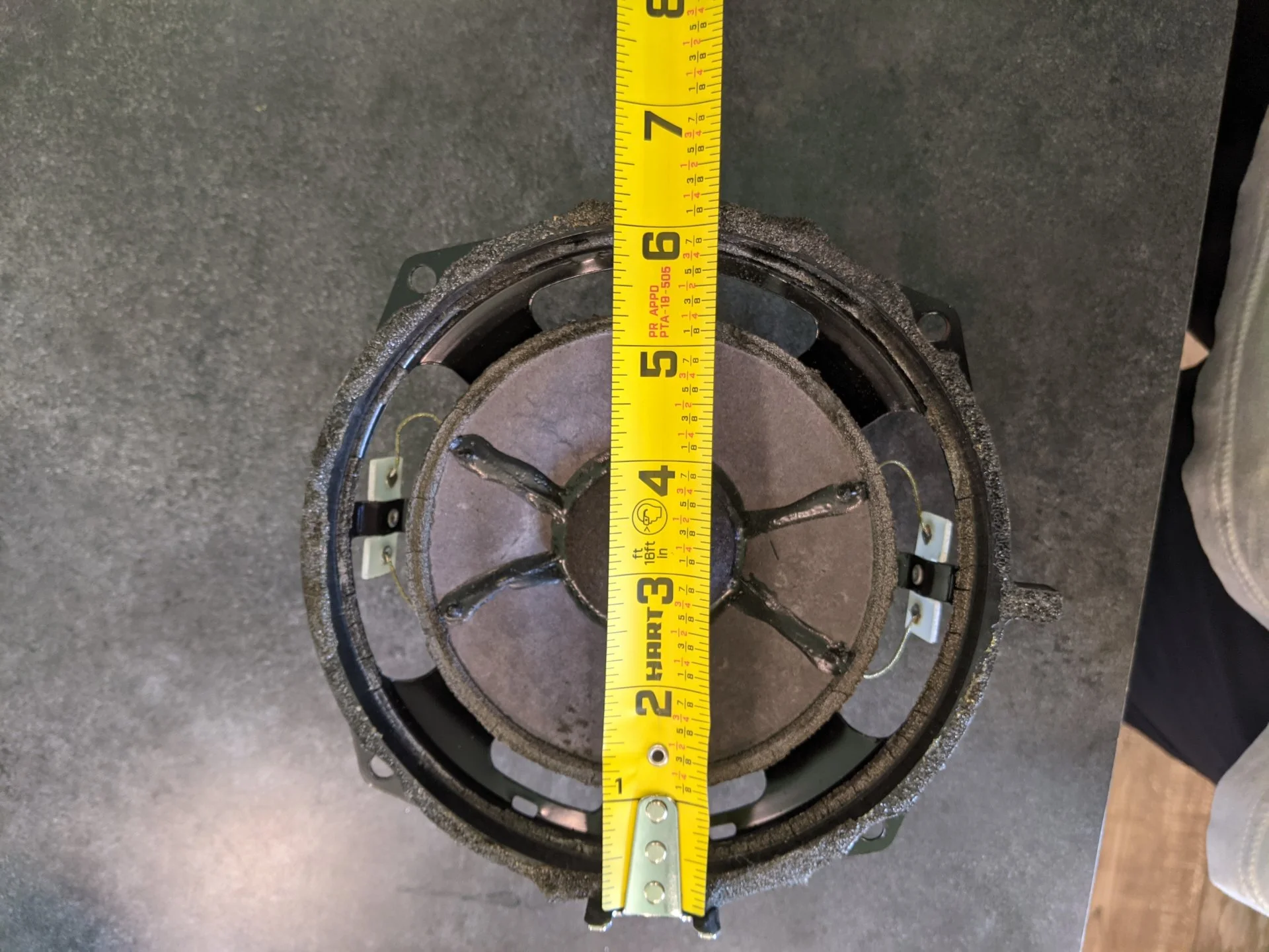

Tell me you need to replace your sub without telling me you need to replace your subwoofer. Also sub sub measurements (1 Viewer)

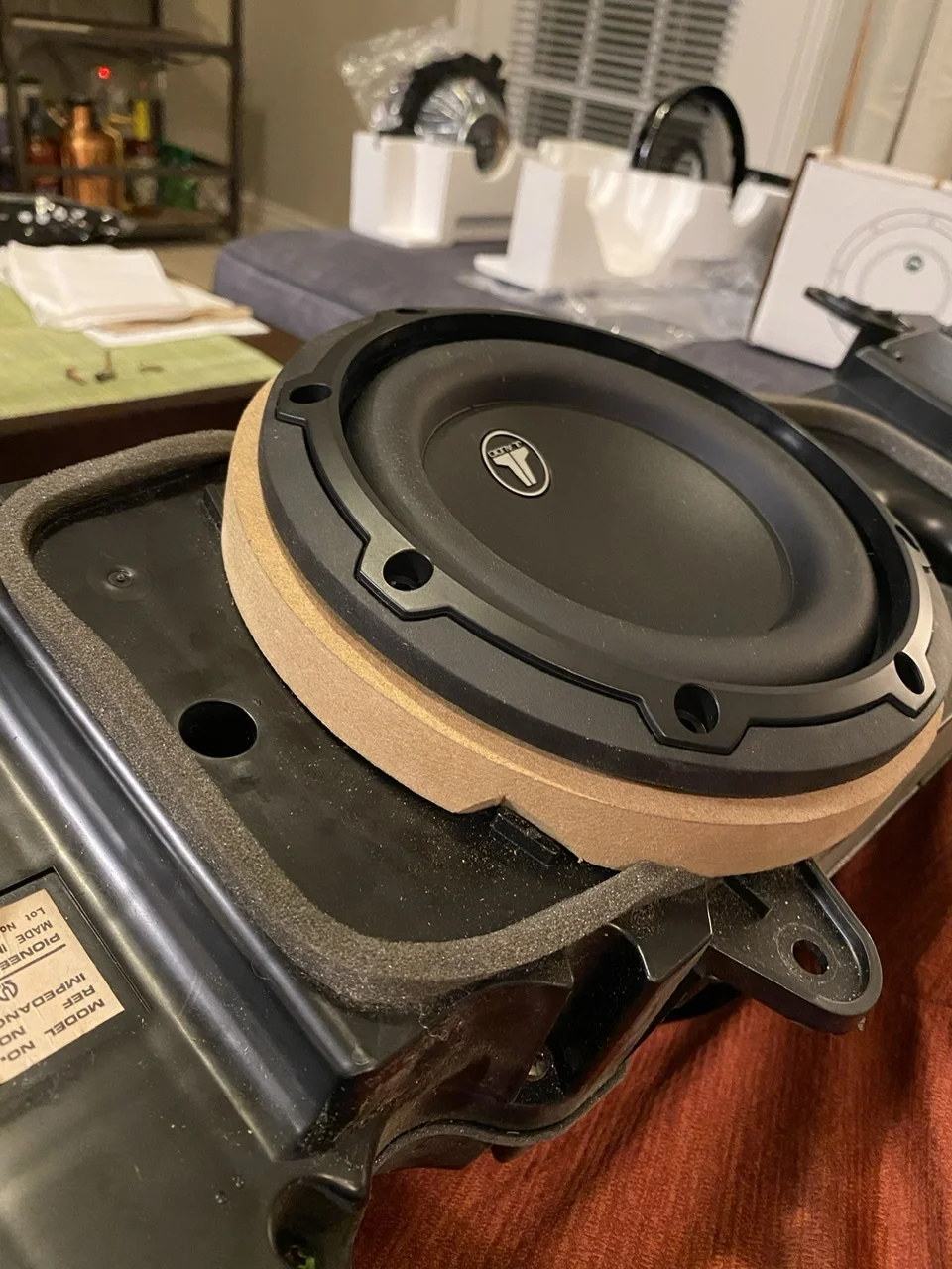

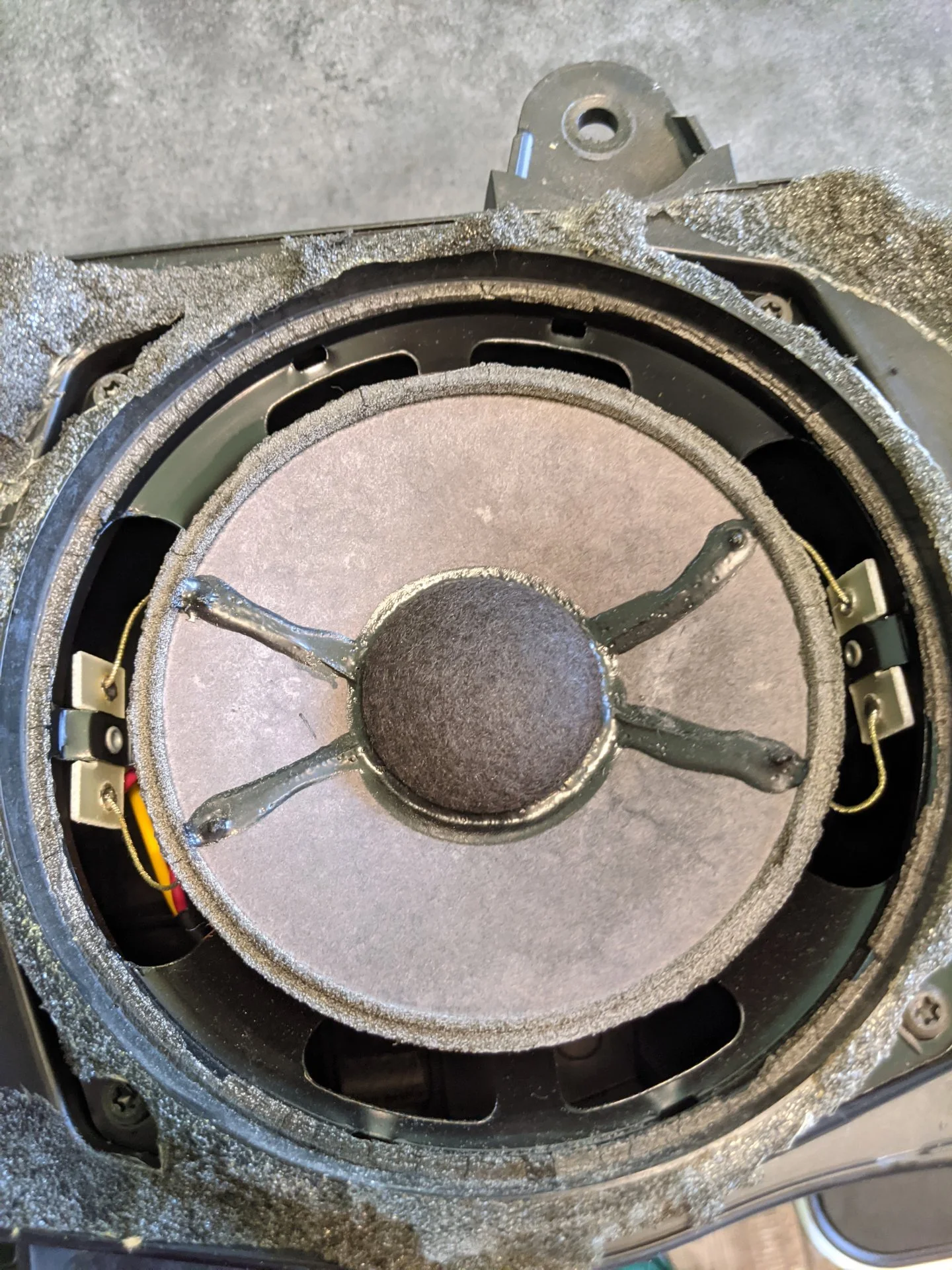

I re-foamed mine the other day. It only had a small piece torn/missing, but sounded like garbage. Sounds great now. Anyone have suggestions on what foam padding to use that goes around it? I tore mine off during the repair process.
Which model JL is that? I'm currently shopping on crutchfield for a speaker.
Did you have to modify your box?
I have the JBL stock box that I'm going to reuse.

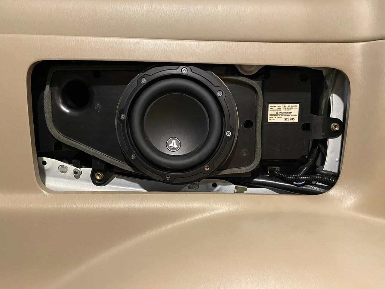

It’s the W3 6.5” I had to add a spacer (1/2” or 3/4”) to get the depth needed to fit in the box and then I had to trim the grill so it wasn’t touching the speaker. I thought I had a picture of the grill after I modified it but I can’t find it.
I didn't know those things existed, but that helps a lot. I just looked some up and they're pretty cheap. Like $10. Okay, now I gotta find a JL speaker in stock.

I'm going to order the new sub and infinity coax speakers for the rear. Should sound pretty good when I'm done.
I think this Kicker shallow mount sub will fit with minimal mods to the factory enclosure.
Yea, that's an affordable option. The only issue I have with it is my amp is capable of driving much more than that speaker can handle. So if I can't find a decent option I'll settle for the kicker.

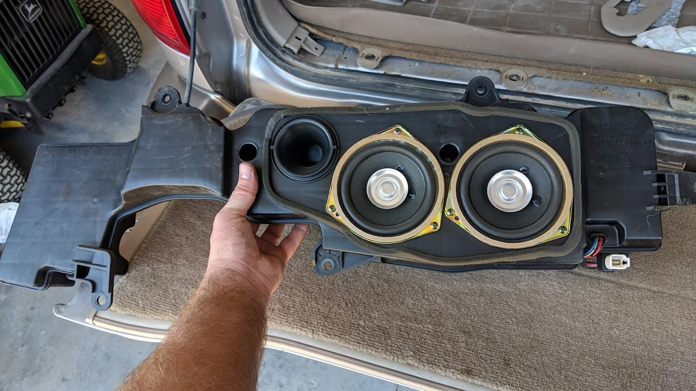

It was way more useful for me to remove this "sub"...
