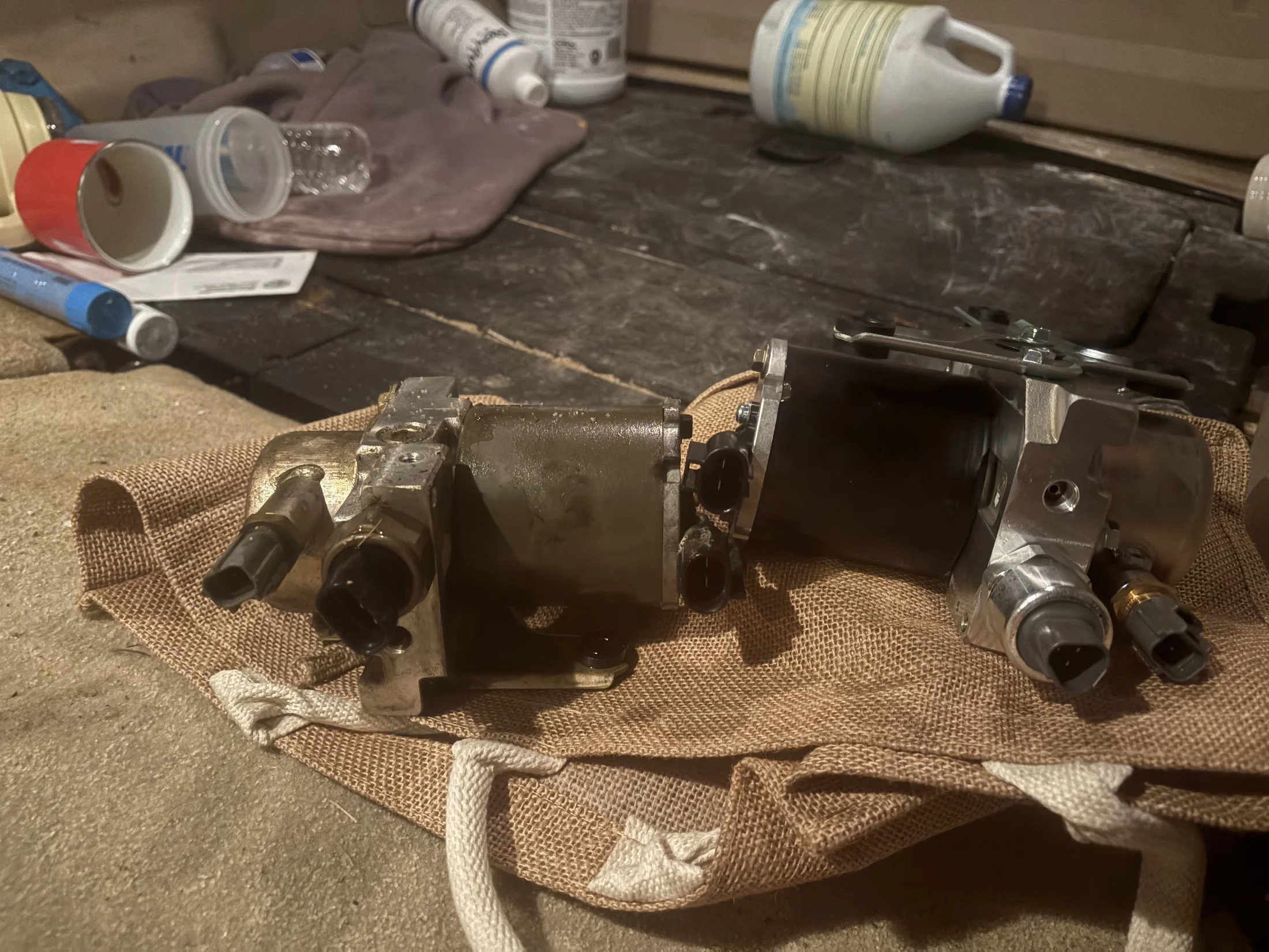

I’m installing a new AHC pump and lo and behold…. I got the wrong model year.
Is there an adapter so I can still use this pump? (The pressure sensor is a different plug shape)

Use the old sensor?
  • Like
Reactions: GTV
Are you saying to take apart the 2 pumps and swap them?
Yeah, is it that large sensor in the pic? Probably identical except the plug. But take the old one out first to be sure nothing unexpected happens so that you can still return the unmolested new one if there's a problem.
Maybe also wait for someone else to chime in in case I'm missing something but If it was mine that's what I'd try.

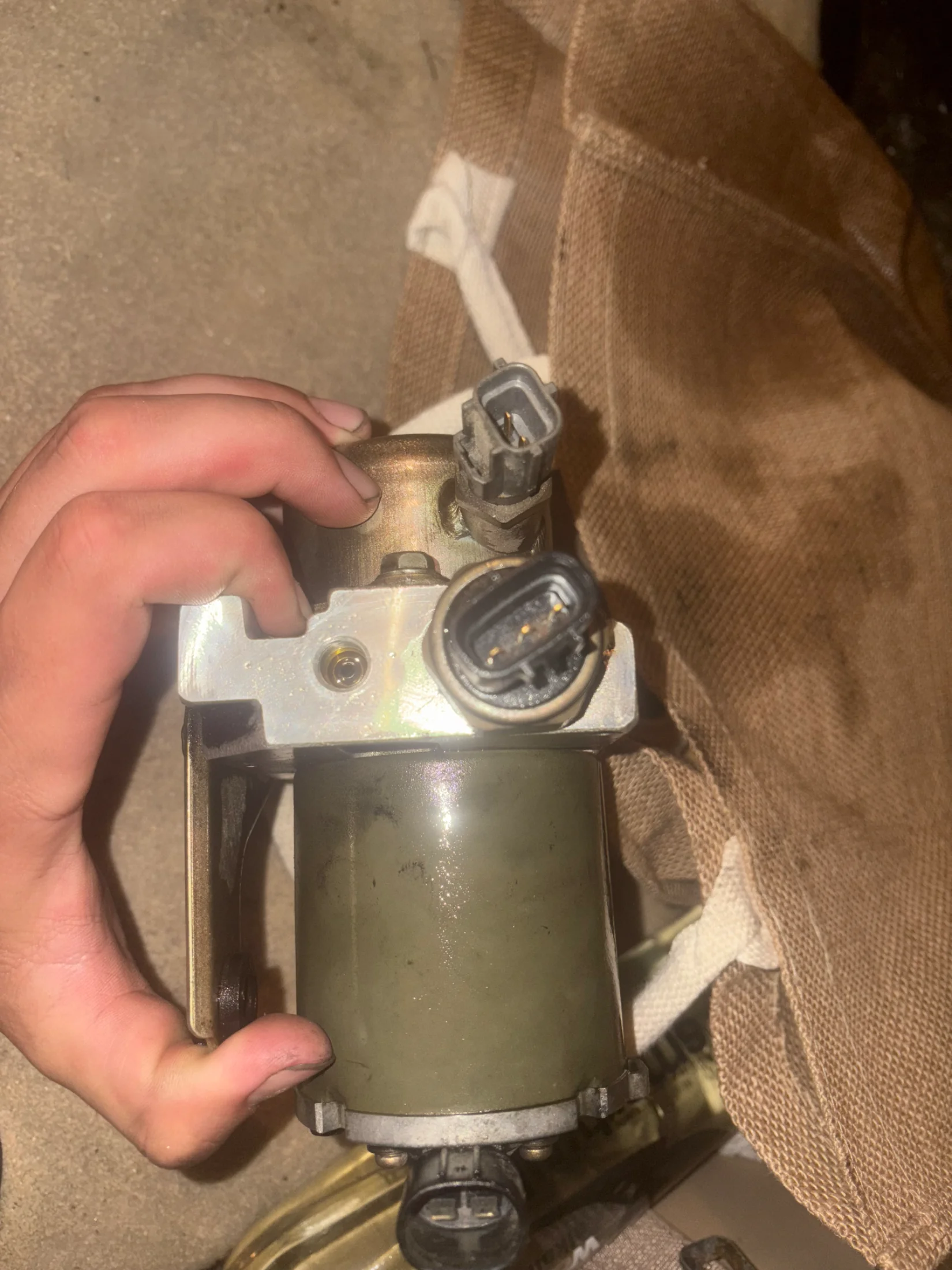

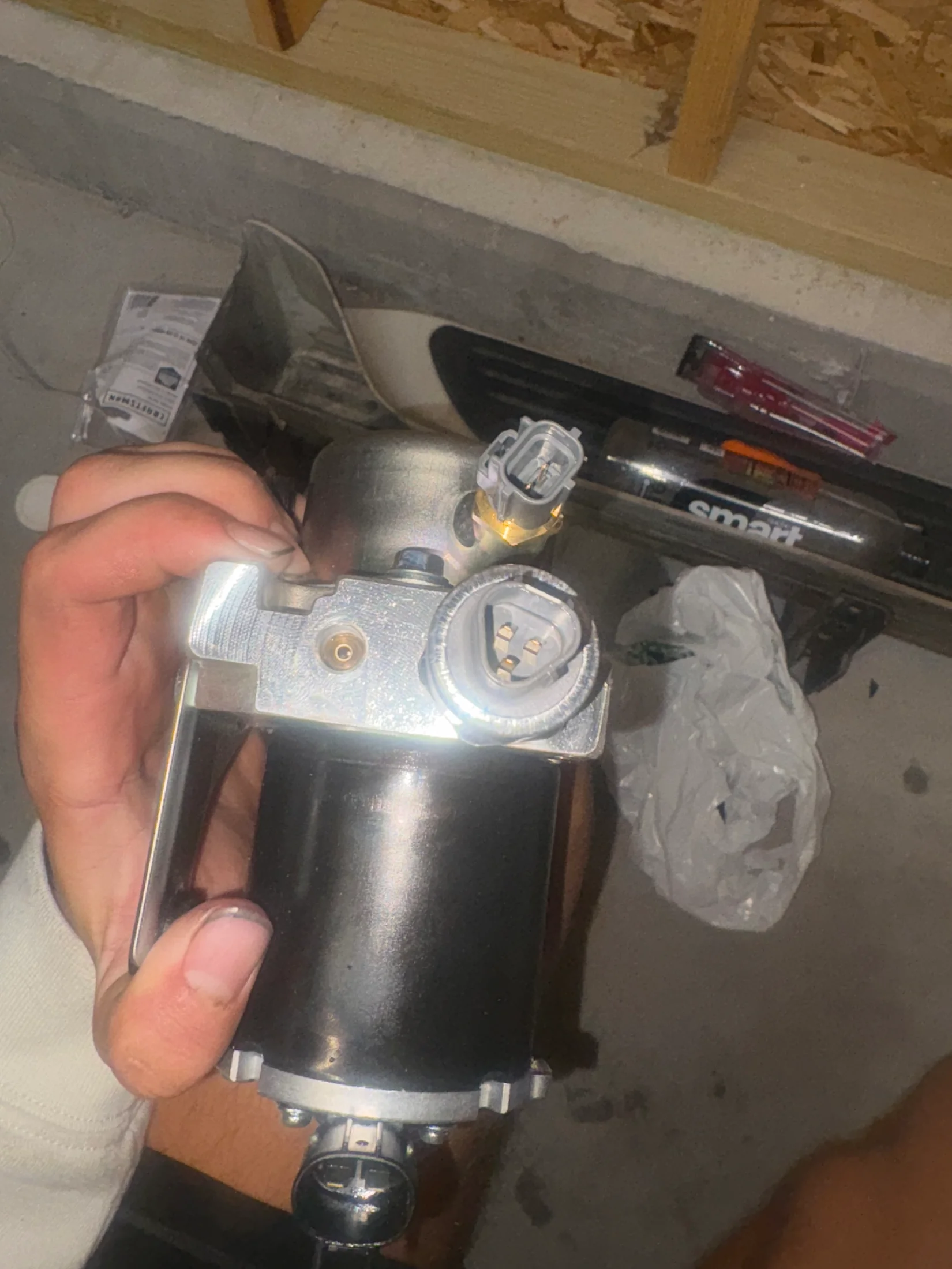

Here’s some better images of what they look like. I’ll hold out for some more info before I get crazy.
I also got this off IMPEX, so no returns. It’ll just go to a mudder on discount probably if there’s no fix
Look the same to me, both 3 terminals just a different plug .

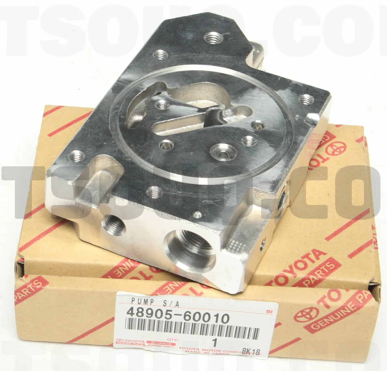

The milled block (Part Number 48905-60010) carrying the AHC Pump on one side and the Motor on the other side, also carries the fluid Pressure Sensor, the fluid Temperature Sensor and the Return Valve (internally). This Part Number appears to be common across Model Years for all LC100/LX470 vehicles with AHC/TEMS, so either Pressure Sensor could be expected to fit in the large threaded hole for the purpose.
Further good news is that replacement of the milled block Part Number 48905-60010 means that the Return Valve has been replaced. It is included inside Part Number 48905-60010. The Return Valve can be problematic -- prone to blockages in older vehicles, especially if AHC Fluid rarely has been changed.

This worked. I just unscrewed the pressure sensors and swapped them. Super simple. Back on the road.
Here’s to MUD 🍺
Yeah, there's no reason for the specs to be different between the two.
But there was no real reason for the plugs to be different either!!!
Glad it worked out for you.
@IndroCruise @RapidRob I take back what I said, I don’t think this worked. My ride has been harsher than normal since I replaced my pump and I decided to check pressures.
When I checked I realized it was throwing code C1718… which is pressure sensor. Everything works fine, but like I said. It’s harsher since I replaced the pump.
I am replacing the globes today but with it throwing that code. I’m just gonna spring for the correct pump at this point. Don’t want to ruin anything.
