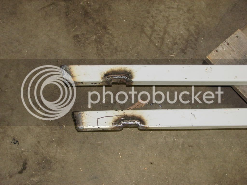

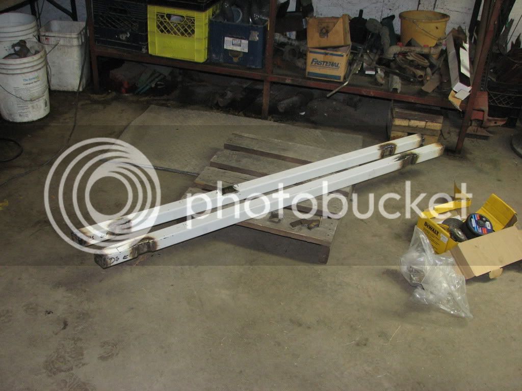

A couple pics of the rock rails. Welds aren't pretty, but I'm getting the hang of it.
the grinder is your friend:hillbilly:
Around where the bead goes, yes. Grinding an angle in for penetration where it is needed too.
