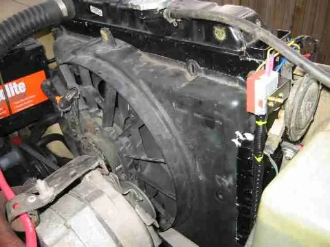

here are some pics of taurus fan installs on the stock 40 rad I have found over time
and some more plus a wiring diagram

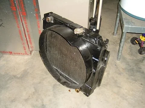

I have never found anythiong close enough to modify, always ended up fabricating my shrouds. More pics.
Top pic didn't cool worth a darn for anything over 80F outside.
Cardboard mock-up
final product with custom aluminum radiator
