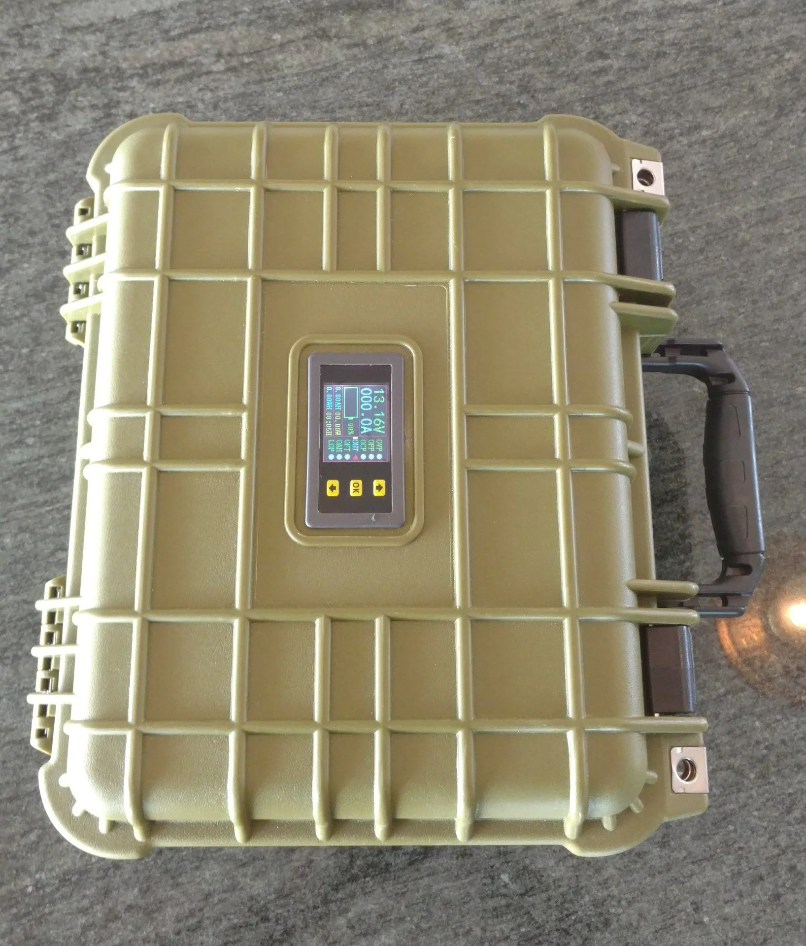

Well test #1 of the new battery charge off my current setup failed miserably.
The first issue is I’m getting a voltage drop at my power port when pulling the 20 AMPS. I ran 10 gauge wiring, I took a guess that I was under ten feet and that should have been good for 3% or better voltage drop @30 AMPS but I’m getting a 36% voltage drop @20 AMPS so I’m going to need to dig in and get that figured out before I try again
Second issue the “Powerwerx CigBuddy, the portable cigarette lighter plug to Powerpole adapter” I bought says it has a 20AMP rating and I set up to charge at a 20AMP max and float charge at 10AMPS so in theory this should have worked fine but in reality it failed miserably. I’m sure my voltage drop didn’t help but the CigBuddy melted internally before it blew its 20AMP fuse. After tearing it apart it was obvious why this happened and the engineer I talked to at Powerwerx agreed they most likely overrated their adaptor and apologized but this isn’t going to help me with my immediate need for a cigarette lighter adaptor that will actually handle continuous 20AMPS.
