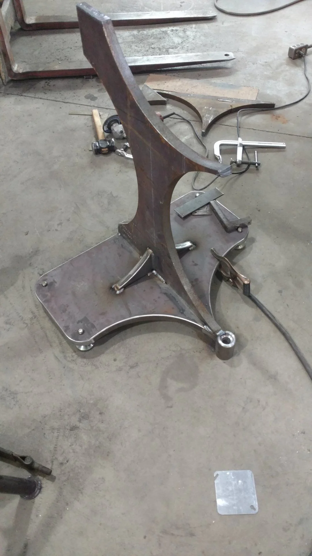

Ha yeah,, I had two 5X10 sheets of scrap welded together, one is an inch thick and the other is three quarter.
I was literally like a monkey making love to a football trying to flip all this over and get it cut into manageable sizes.
Damn I'm getting old.
Although my wife would disagree being a Horder pays off from time to time. Dug through my stash of good parts to keep just in case I might need them one day and found some heavy swivel feet, drilling and tapping 5/8" holes on this heavy chunk of steel kind of sucked but it's done and now on to the fun stuff.
Machined a fitting for the base of the vise and started welding some of the scrap steel together.

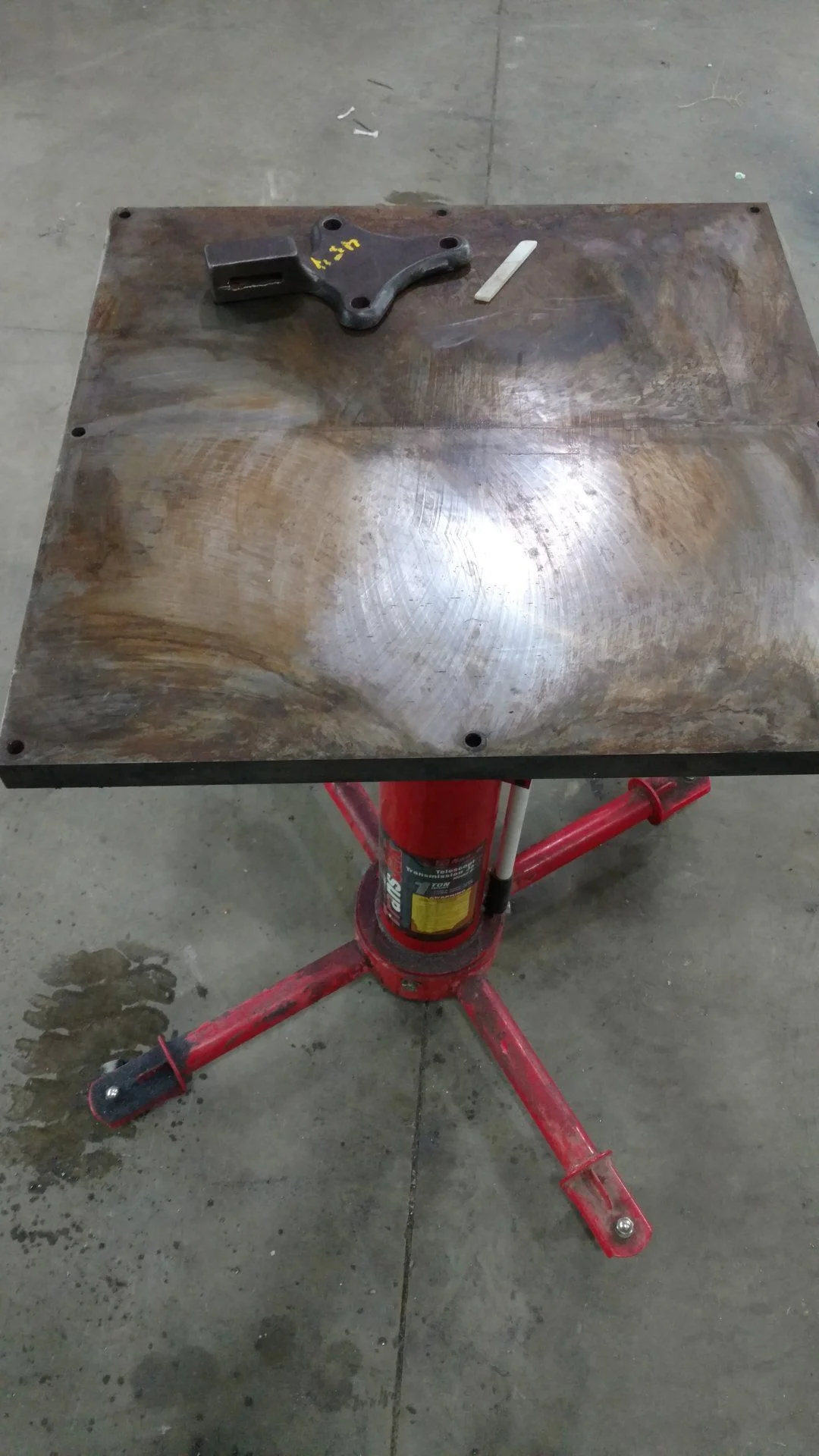

Going to need to rethink my plan, I was going to use a chunk of Blanchard ground 1 ½” plate I have to make the table from but after spending a few hours digging it out and cleaning it up I discovered it is so hard it completely flattened the point on my center punch. I thought it was a fluke so I checked it with a file before I set it up to drill and it knocked the teeth off my file, not sure how hard it is but I’m not going to be able to drill it with anything I have here.

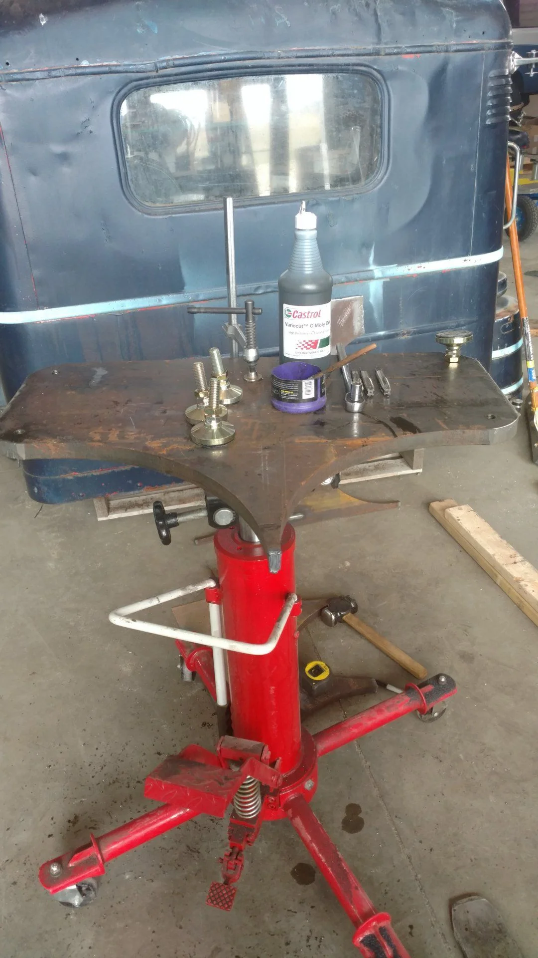

So I was digging around my pile of junk looking for something to make a top from and just for poops and giggles I ran a file on my second chunk of ground plate and it was dead soft. They where use together on a press I bought and I can’t for the life of me think why the one is so hard and this one isn’t, anyway I got it drilled and tack welded in place. Hopefully I can get it welded up and make the aluminum top and move on to some Land Cruiser maintenance.
I was worried about how you were going to move that beast around but then I saw some forks in the background so with having a forklift heavy objects aren't an issue. It does look pretty nice and that vice looks like it has gotten some work hardening love with it's battle scars.
Better plan on using it in ID. Shipping it to AZ might kill your resto budget.
Ha yeah just dealing with the 230’ish lb. top plate was a treat. When I built my other post vise/striking plate combo I thought I made it heavy enough (about 350#) and if you put something in the vise that needs bending and pull too hard it does move around the shop a little too much. I use it often enough just the way it is that made it hard to justify cutting it apart to make something more stable for heavier work, I also find myself clamping parts to the striking plate for welding and it’s super convenient but a little small and low to be ideal.
