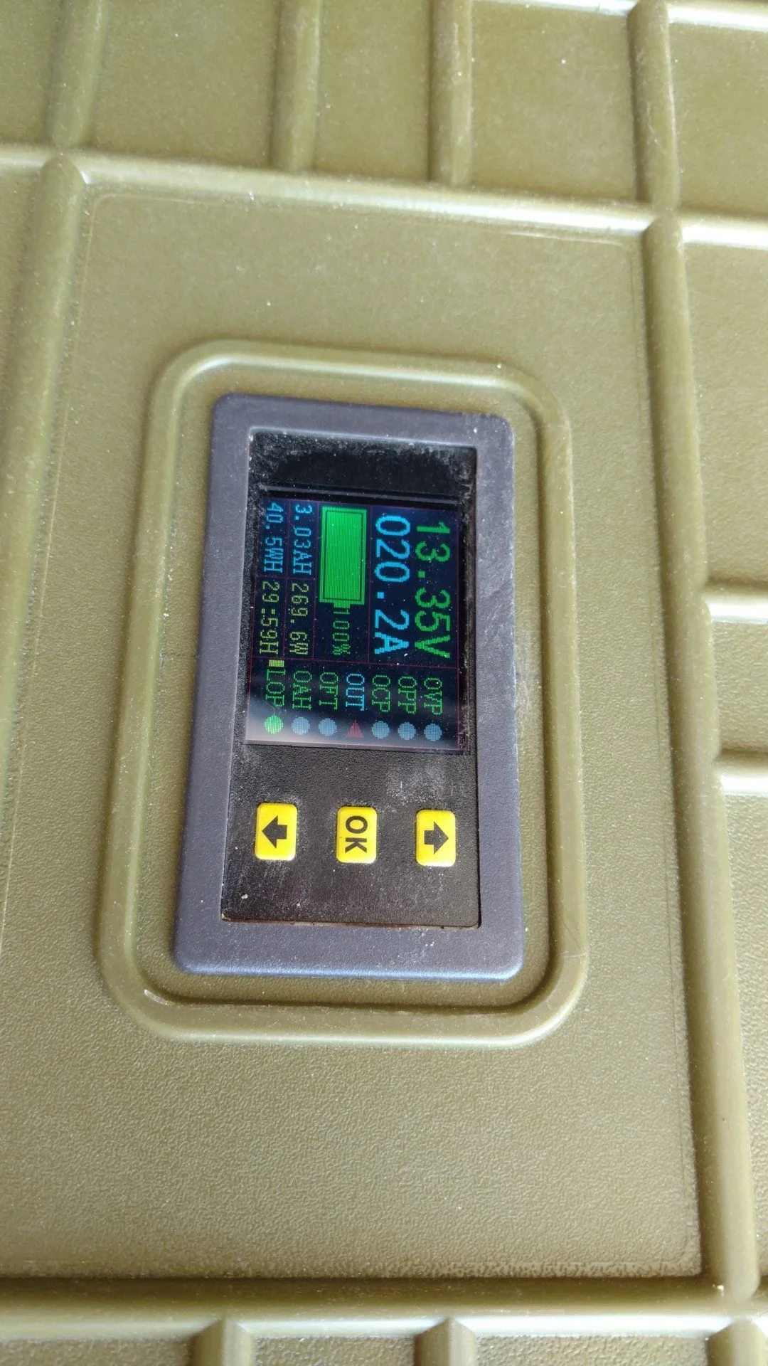

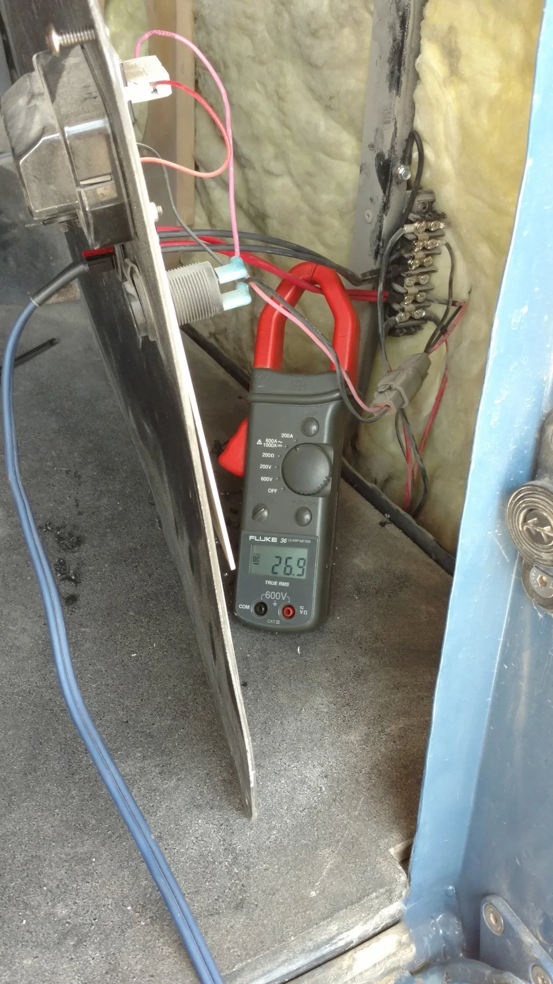

I’ve been through three cell phones in three weeks so I’ve lost most of the pictures I had but I did move some stuff around and add a “Powerwerx panelpole” 45 AMP panel mount housing and now I’m closer to a 3% voltage drop but I’m still pulling between 25/27 AMPs during the charge cycle.
8 Gauge wire would be a better choice for this setup and I’m unwilling to rewire this pig for this experiment so back to my thinking chair to drink a few cold adult beverages and come up with a new plan.
