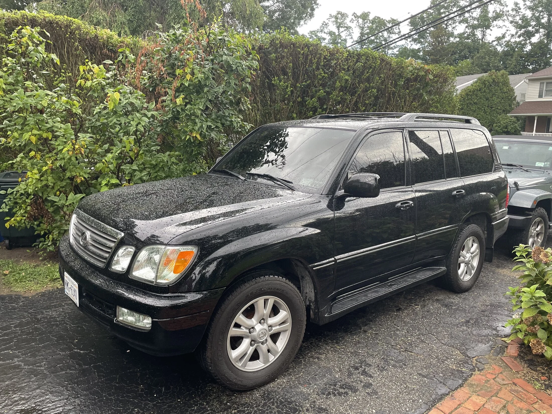

I immediately did the timing belt and started baselining some fluids. Unfortunately I quickly learned that mileage is not the only indicator of wear and tear in the north east and there was a lot hiding underneath that "fancy" professional undercoating the previous owner had applied... Long story short I learned a bunch of valuable lessons with that first rig and got to do a dry run of my first build. After 3+ great years and a few too many thousands invested it was time to part ways and start with a better a base... here are a few shots just before I sold it.

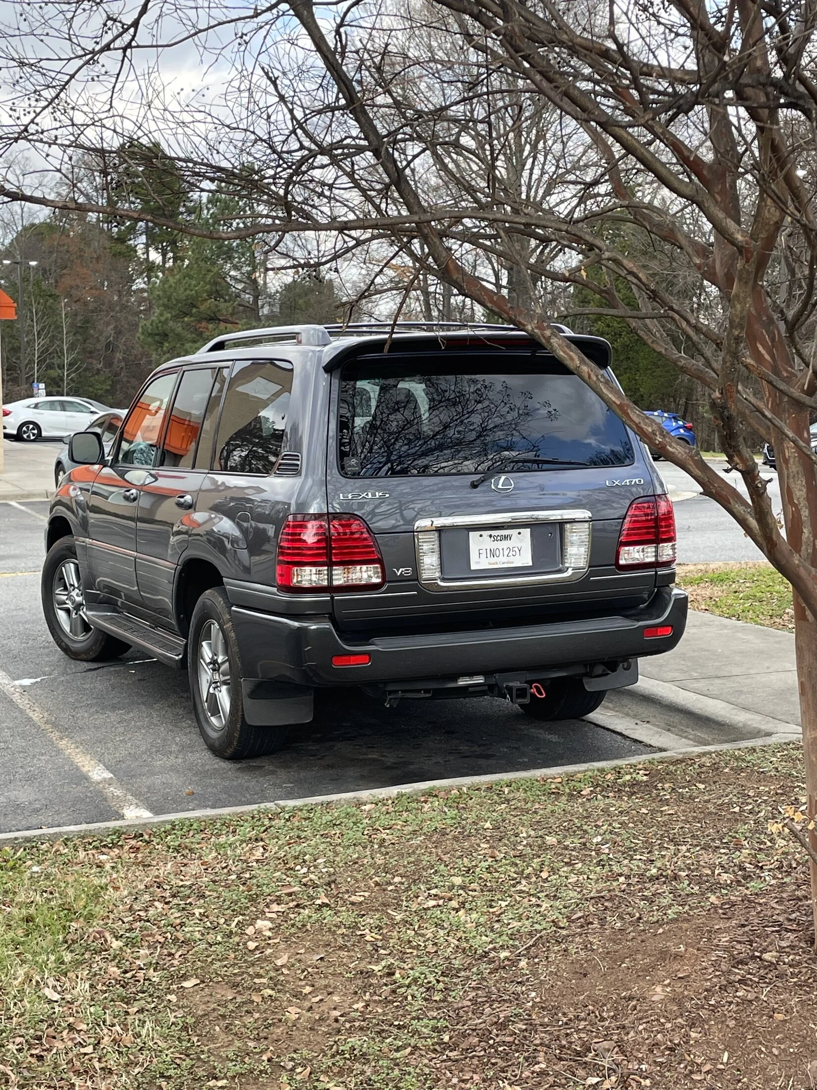

After a few weeks of furiously scouring the interwebs in all of our rust-free regions I finally landed on "Hank" (The next generation of the first rig "Frank the Tank") I snagged him from a cruiser head down in Greenville, SC this past December. Flew down and drove right back up to NY the next day. Here's a photo the day I got him. Not a lick of rust and 208K miles young. Very excited to snag a vvti as well as Hank is a 2006. It wasn't perfect - certainly had a small list of "issues" but I enjoy wrenching on these things. Trading some miles for a rust free rig was worth every penny.

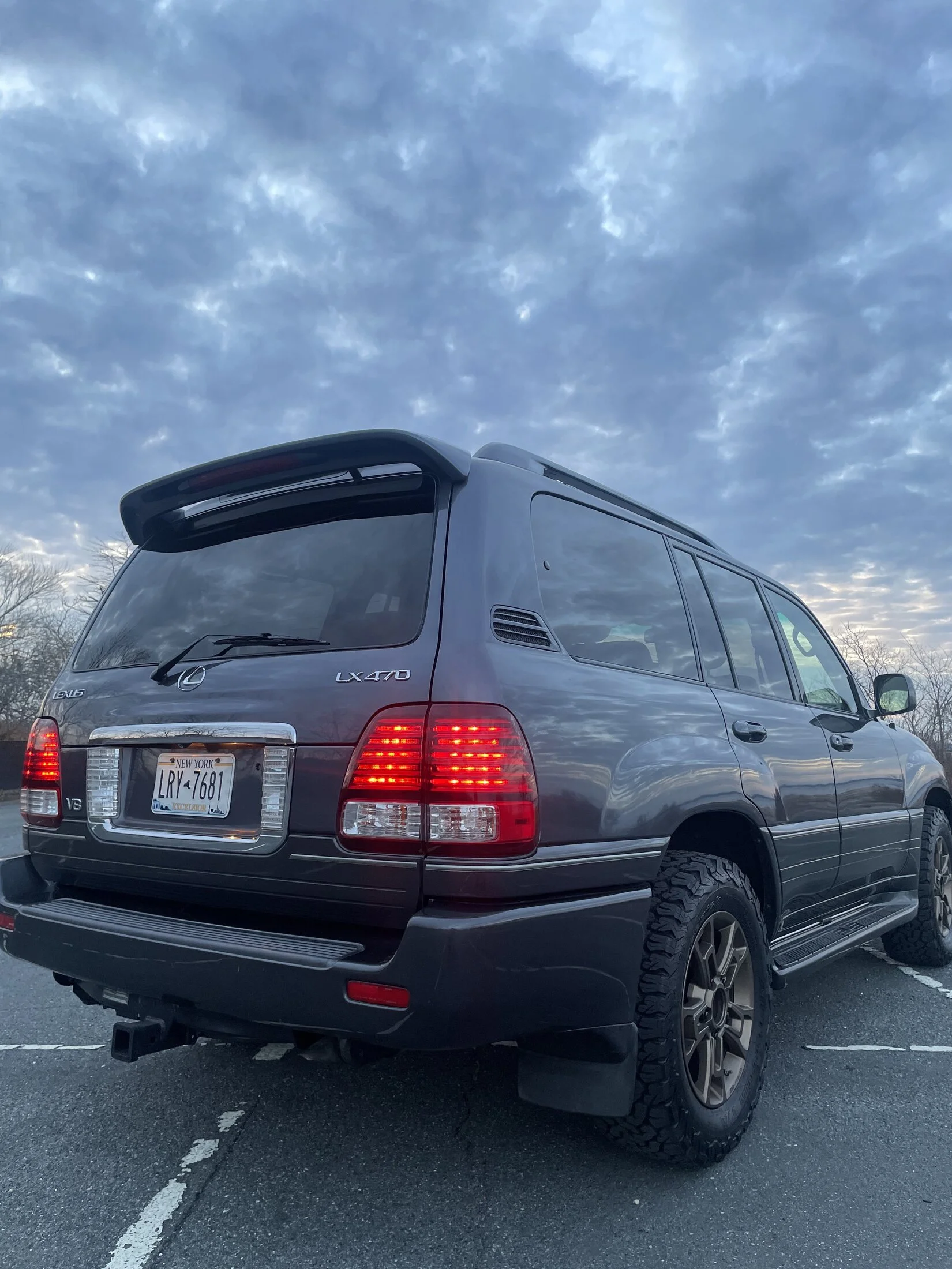

I've got some heater T's on deck as well as some window trim pieces on their way from Amayama at some point. Also waiting for a Prinsu roof rack I ordered last week while they were running a sale. Here's a photo of Hank as he sits now...
