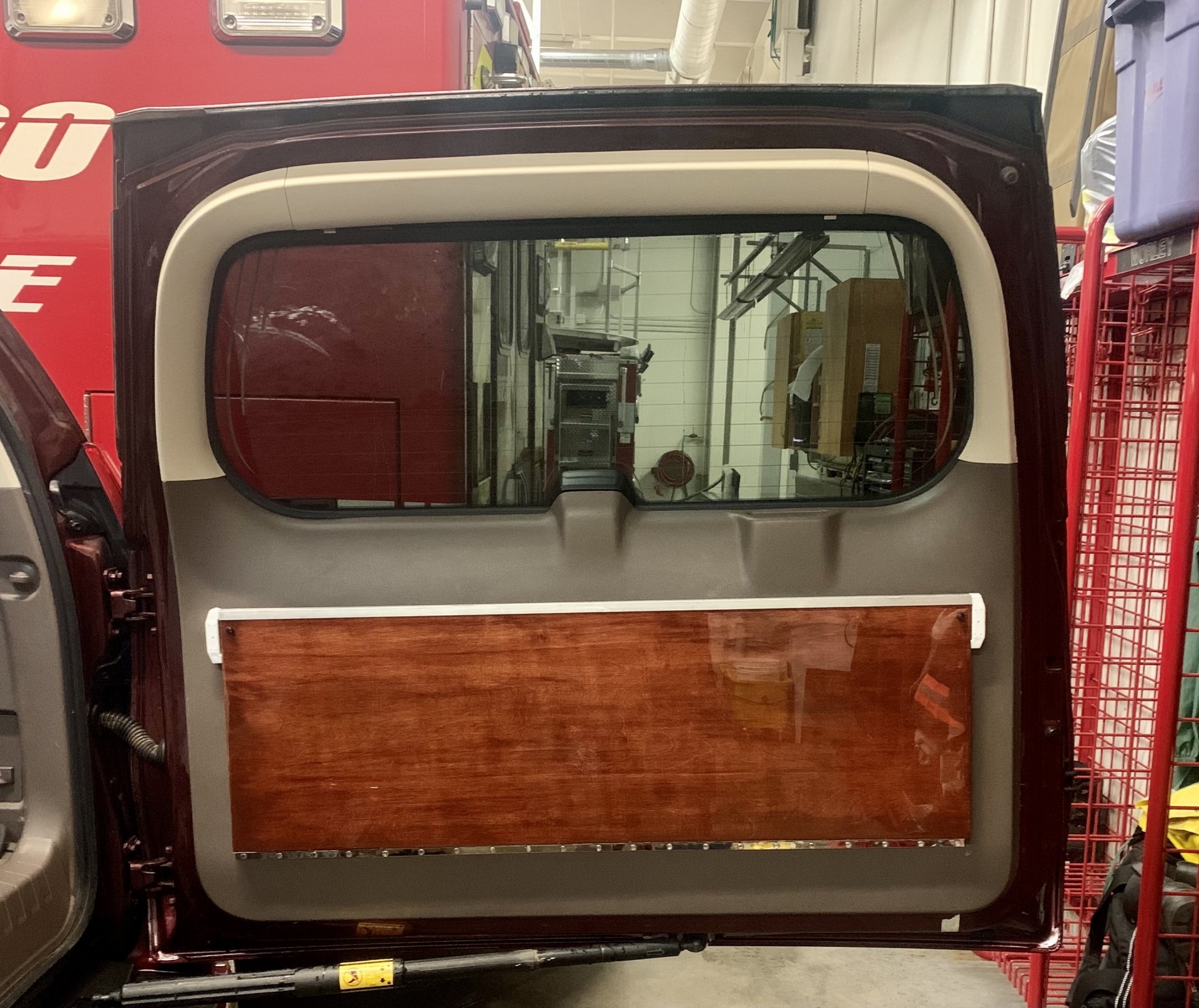

I bought a jeep table from Amazon but ended up returning it because i didn't like it, too heavy, too thick, and too flimsy. Didn't have time to order a replacement before going on a trip so I just cut a piece of plywood and bolted it with some rivnuts and eye bolts. It's been working so well I don't plan on replacing it anymore. Cost = $0. Time = about an hour or two. The only thing I've had to modify was drilling the top eye bolts all the way through to the metal so the anchors are a little stronger.

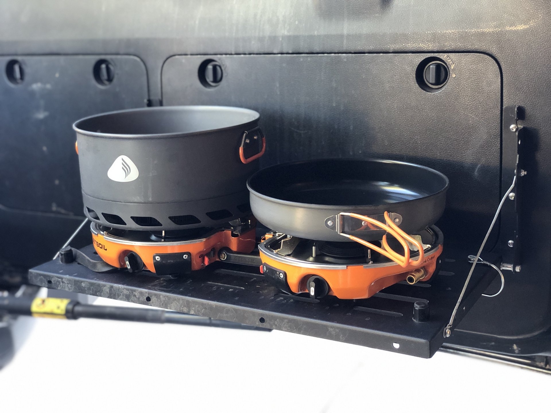

I saw one of those JetBoil stoves last time we were camping with our club. On of the guys was using it and it looked pretty awesome!
Large pots and pans, cooks fast and compact!
We have the Camp Chief Everest, and that thing whips up boiling water in almost no time at all!
I never miss an opportunity for self promotion... : ) We love ours. Third season with it now. It's a bit bigger but not when you consider the large pot, frying pan and two burners all in one medium sized bag. I'm usually cooking for 3-4 so it's quite compact when you consider what you get in the package. Not cheap though.

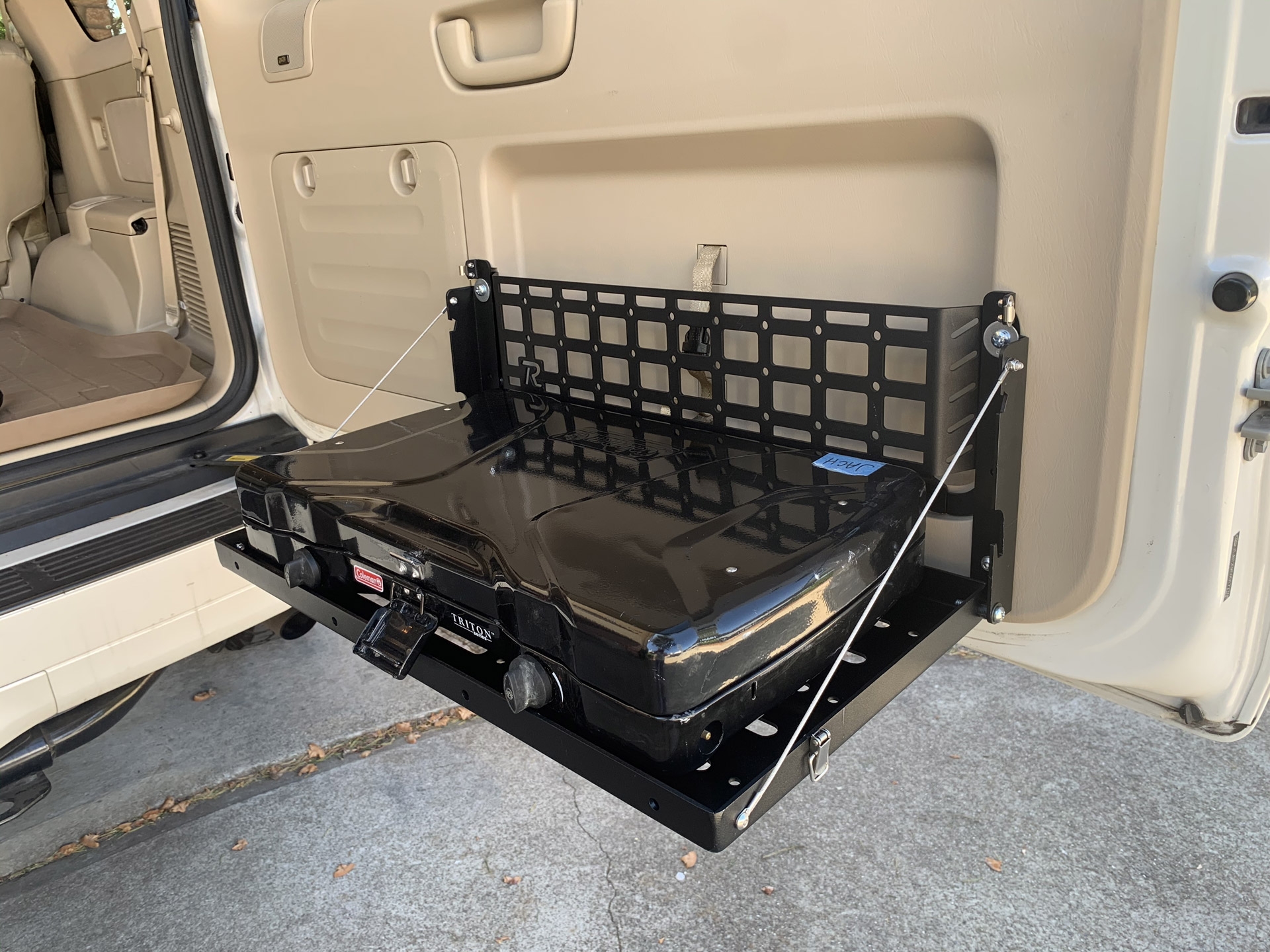

This is the ebay Jeep table I purchased, it pairs perfectly with the Rago cargo net replacement
