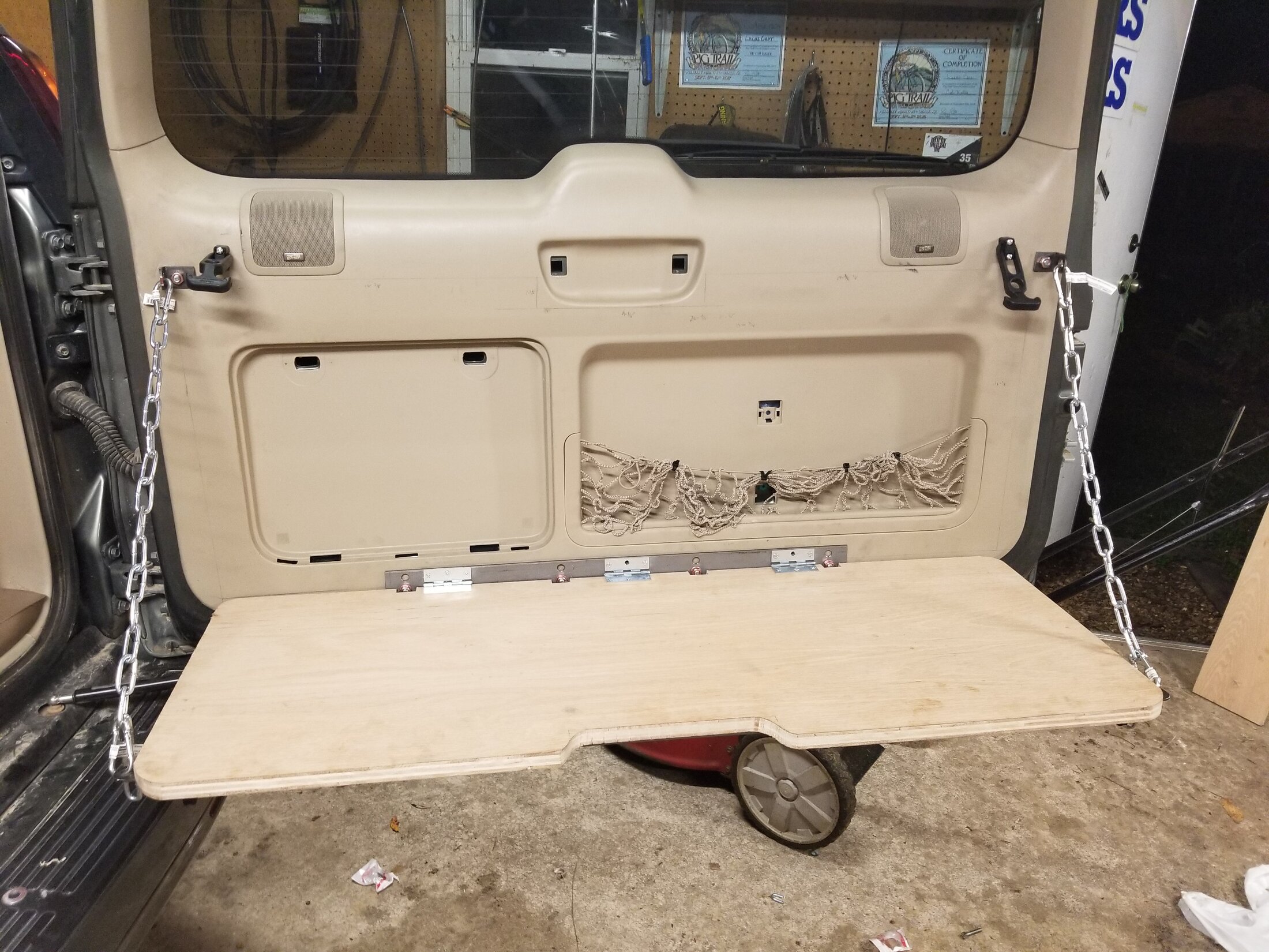

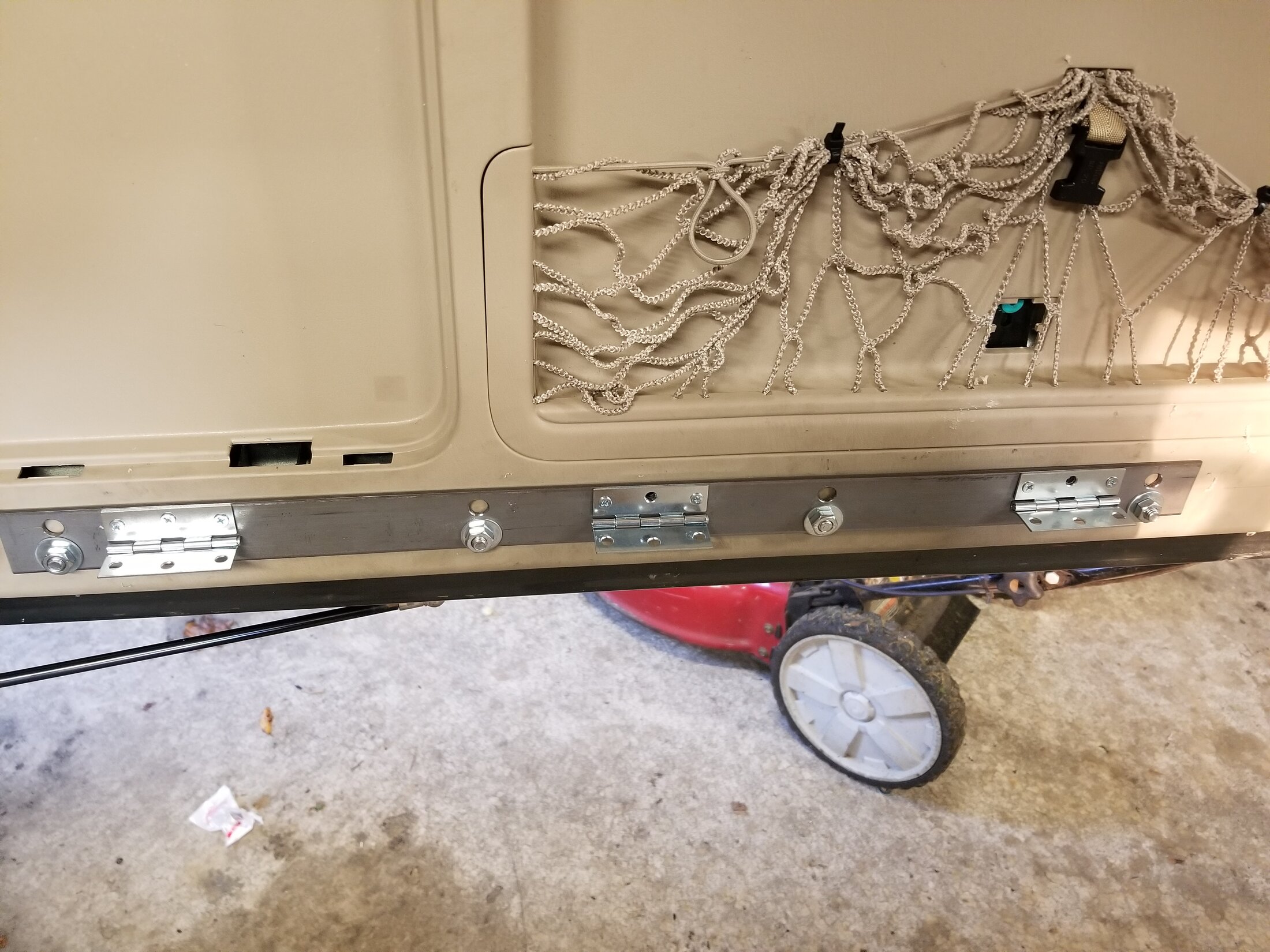

Here is one I did on my 470. No reason it can't be replicated with a 460. Attachment on the bottom uses several M8x1.25 rivnuts installed into the factory door metal, M8x1.25 studs with spacers, then a piece of flat stock that bolts onto the studs and holds the bottom hinges. I have a similar attachment style for the upper brackets - M8x1.25 rivnuts, studs, then the bracket. At first the table was suspended with chains, now I use some friction tie-down straps. This is a super-sturdy table as it's relying on the metal door frame rather than the plastic.

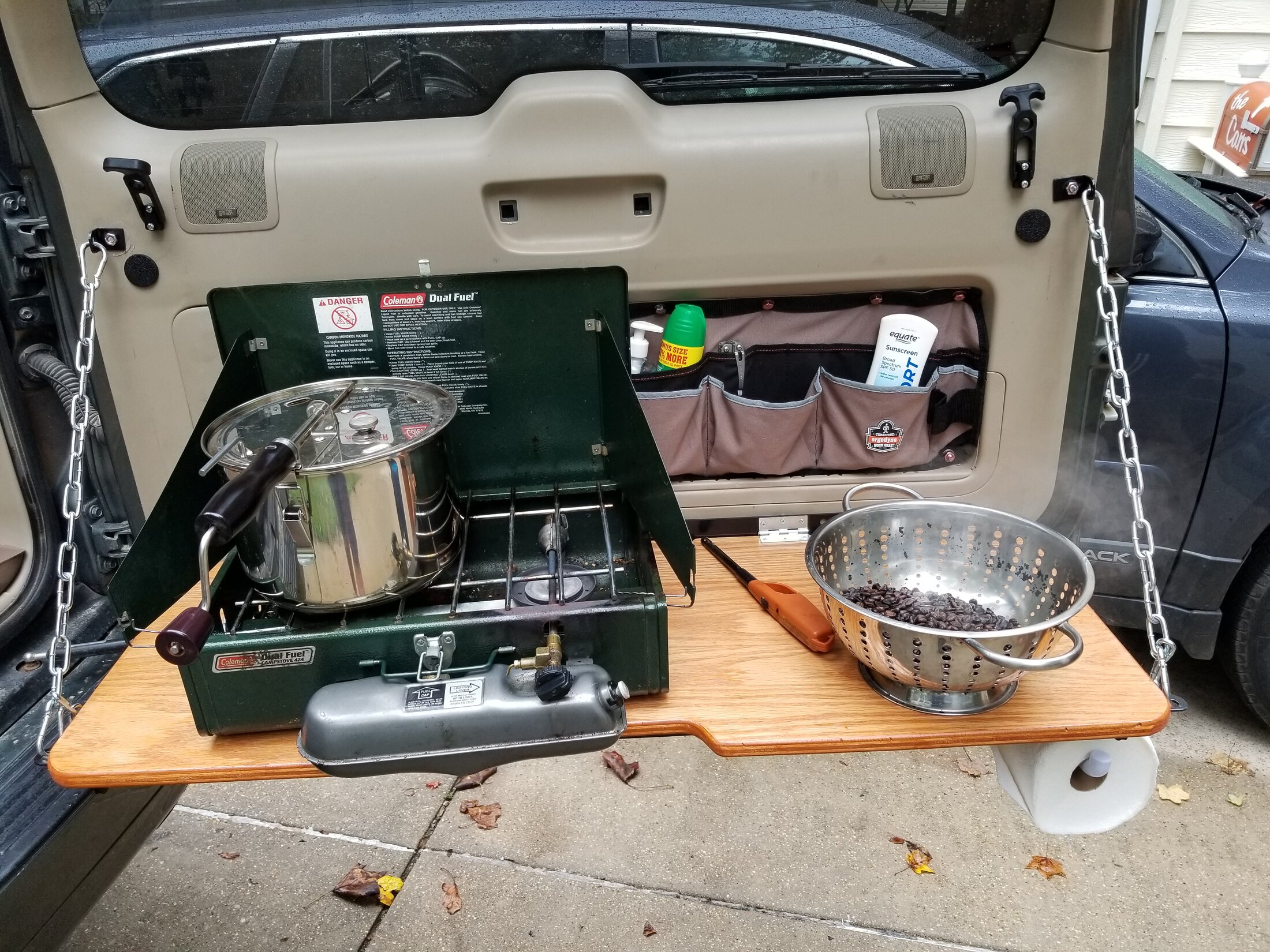

Also I'm old school and still use a Coleman 424 :). I've had it for over a decade and it's also used for weekly coffee roasting. I like the use of liquid fuel ($13 of white gas lasts me a whole year), ability to adjust pressure manually based on temperature and altitude, ability to run unleaded gas in a pinch, and not having to mess with cylinders. I also use white gas for my smaller backpacking stove.

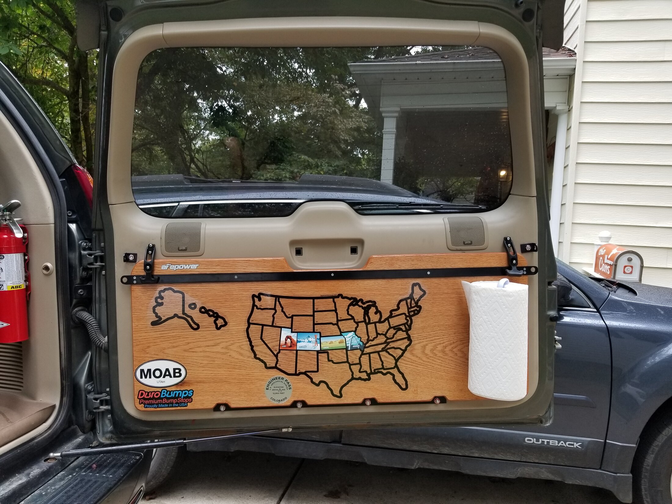

Great way to record your travels! I've been thinking of a way to record ours. Do you just take a picture and stick it on there or do you lacquer over it?
It's a RV sticker we got on Amazon. No lacquer since the stickers are exterior vinyl and pretty tough.

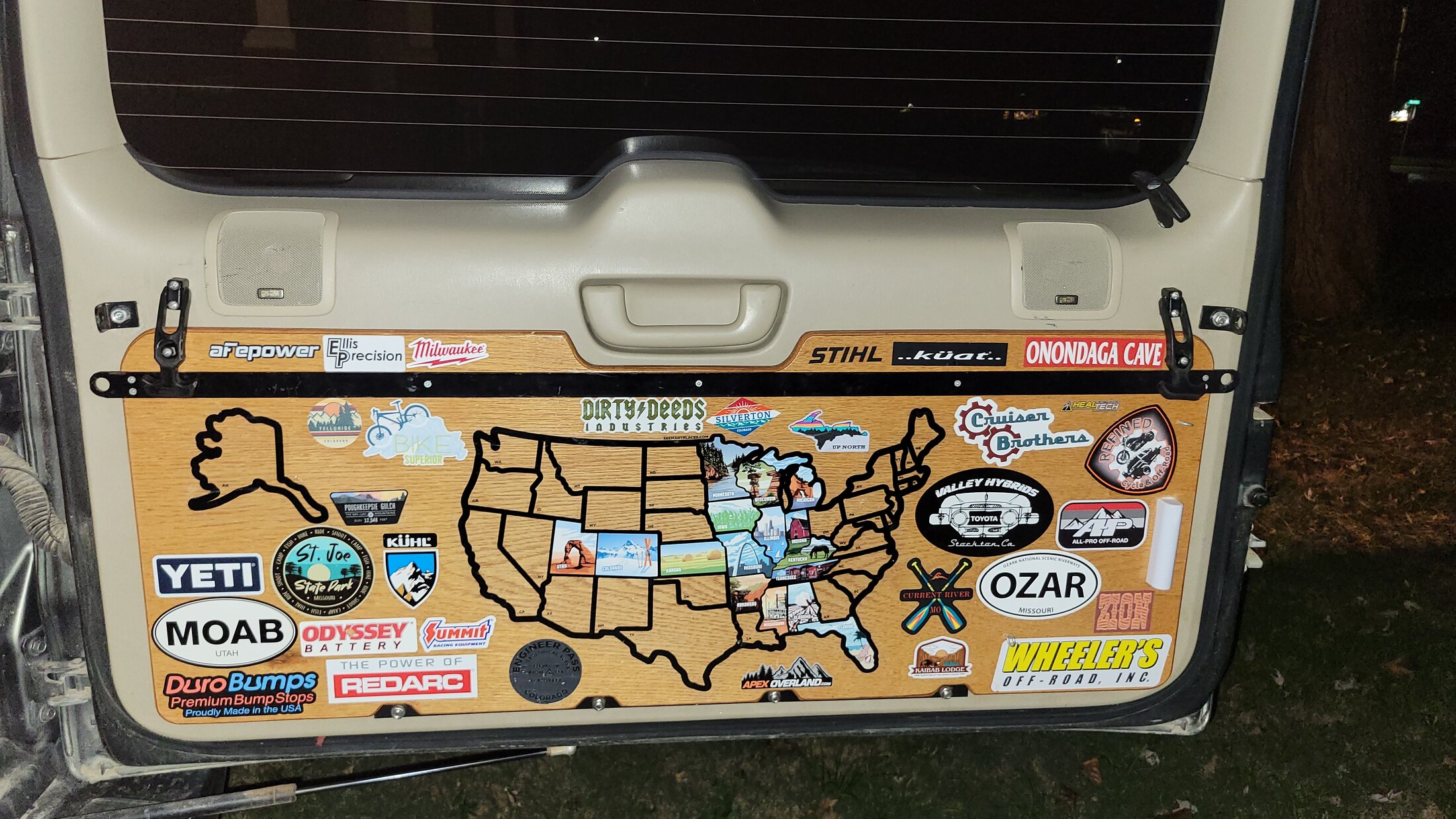

Also, here it is today. Will tag 4-5 more states next year.

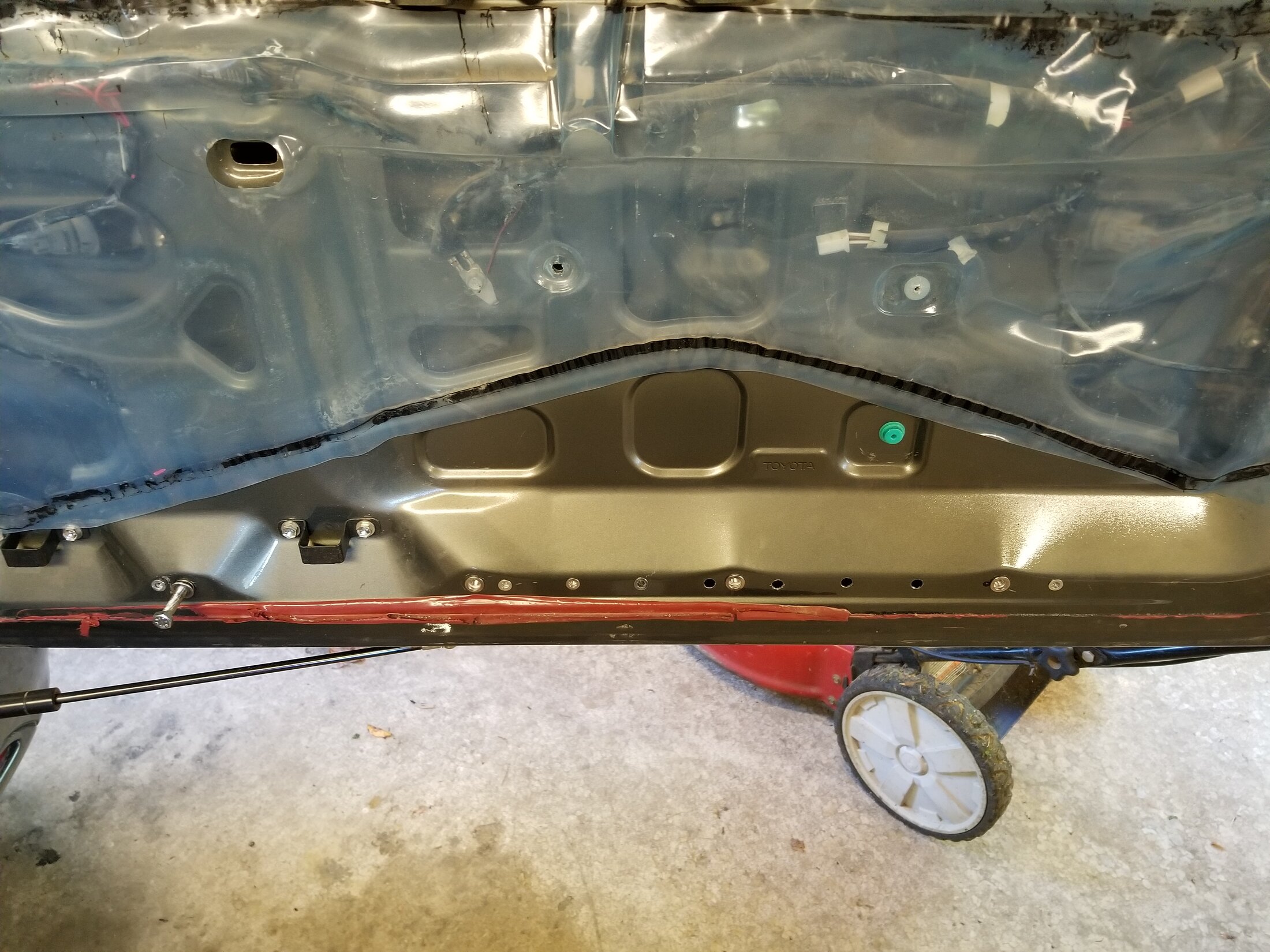

Got any tips on aligning the rivnuts with the holes you're drilling in the panel?
I did it with a bunch of measurements, including drawing some pencil lines on the panel and then transferring measurements over to the panel. It was a bit of a pain but turned out good. It was also 3 years ago that I built it, so my memory is a bit fuzzy :).
I'm kind of a measure once, drill twice guy... I generally just overbore my holes now to allow for adjustment after the fact... also I have stock in Hillman Co's 'hole plugs and variable depth fasteners' division...
Found another photo, and I did over-bore the holes for the M8 studs, since the bottom metal plate covers the holes in the plastic anyway. I also had to make some relief holes behind the screws/nuts that attach the hinges to the metal plate, since the protruded into the plastic. They aren't show on this photo as this must have been prior to test fitting.
All our visited states are on the west cost (including Alaska and Hawaii), a few in the middle and east coast.
