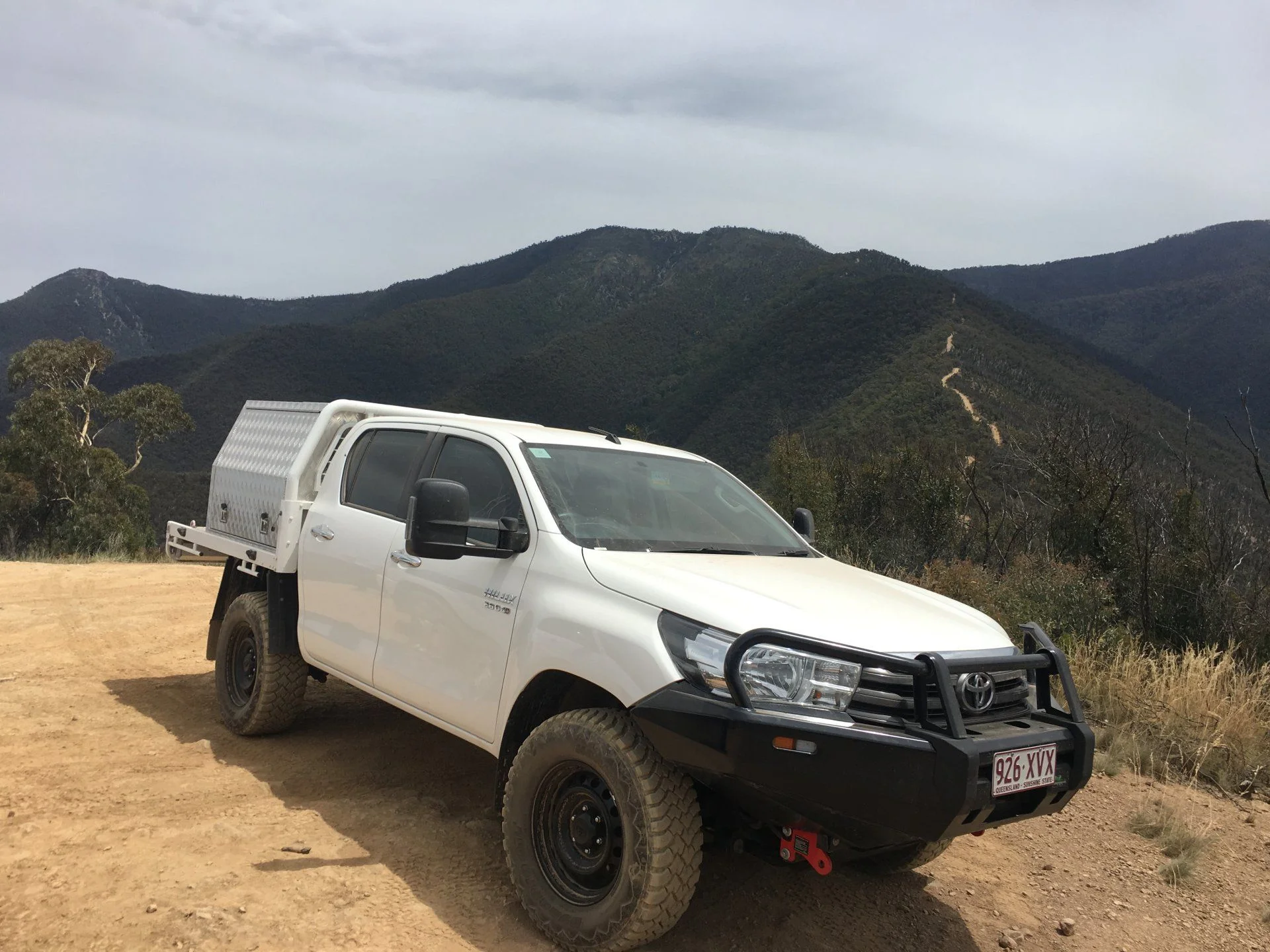

Since there’s no Hilux section and the two vehicles share many similarities I figured I’d post my little build in here.
I have a 2016 that started life as a cab chassis, it was built with an Ironman bullbar, 2” lift and bash guards. The tray has been excellent, but now that I no longer use it for work I am switching it for a tub.

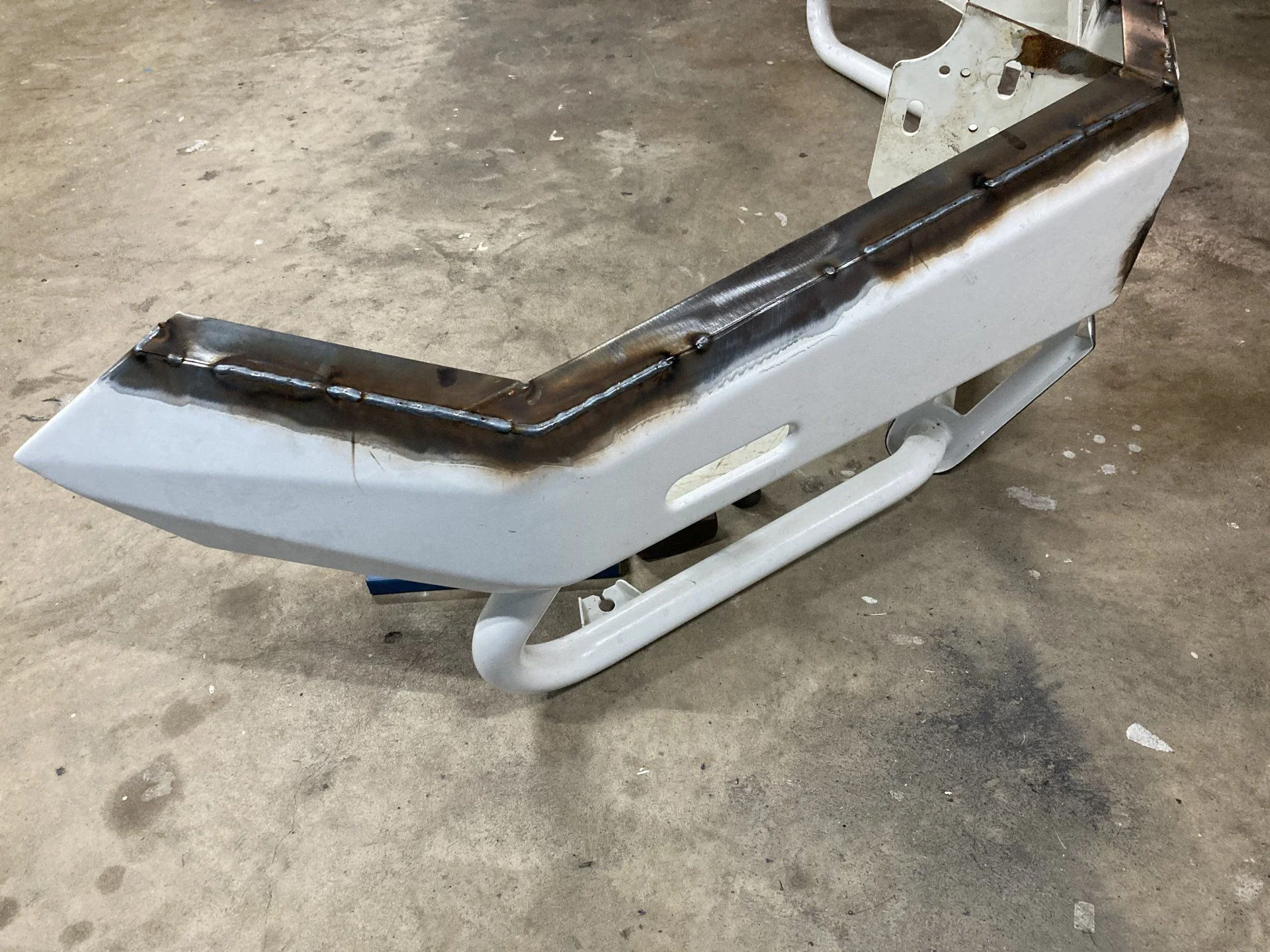

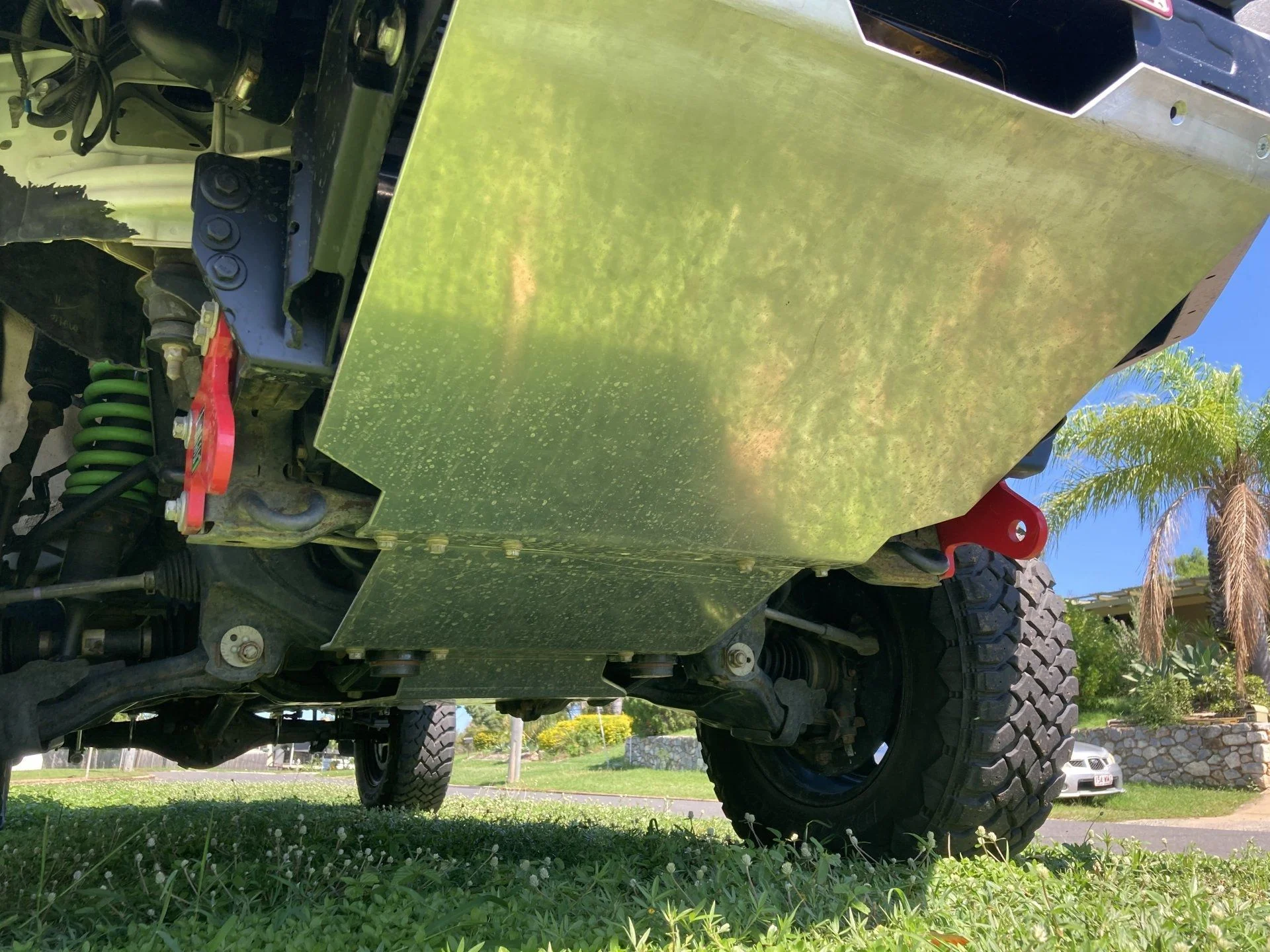

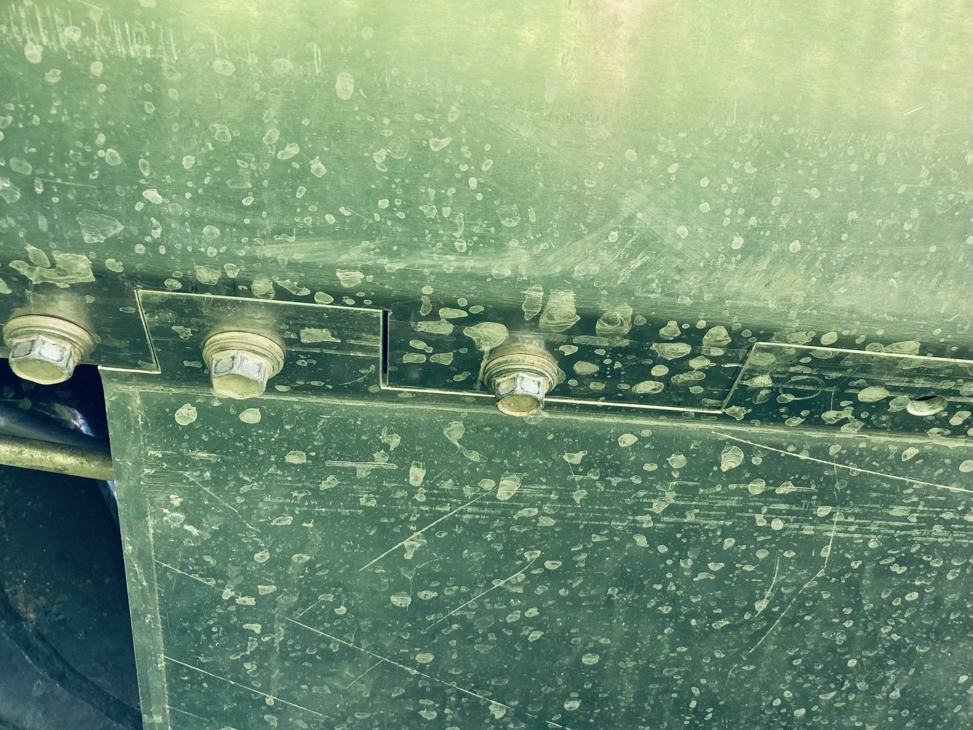

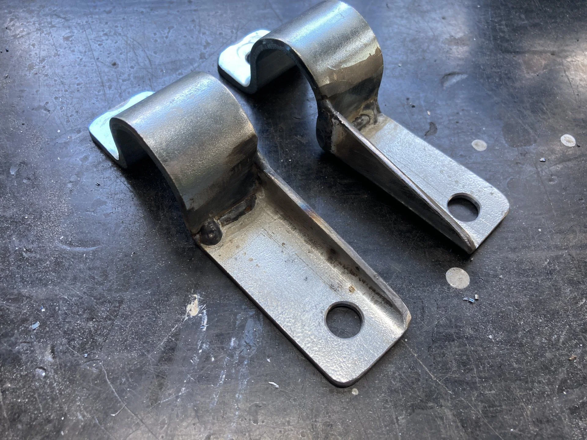

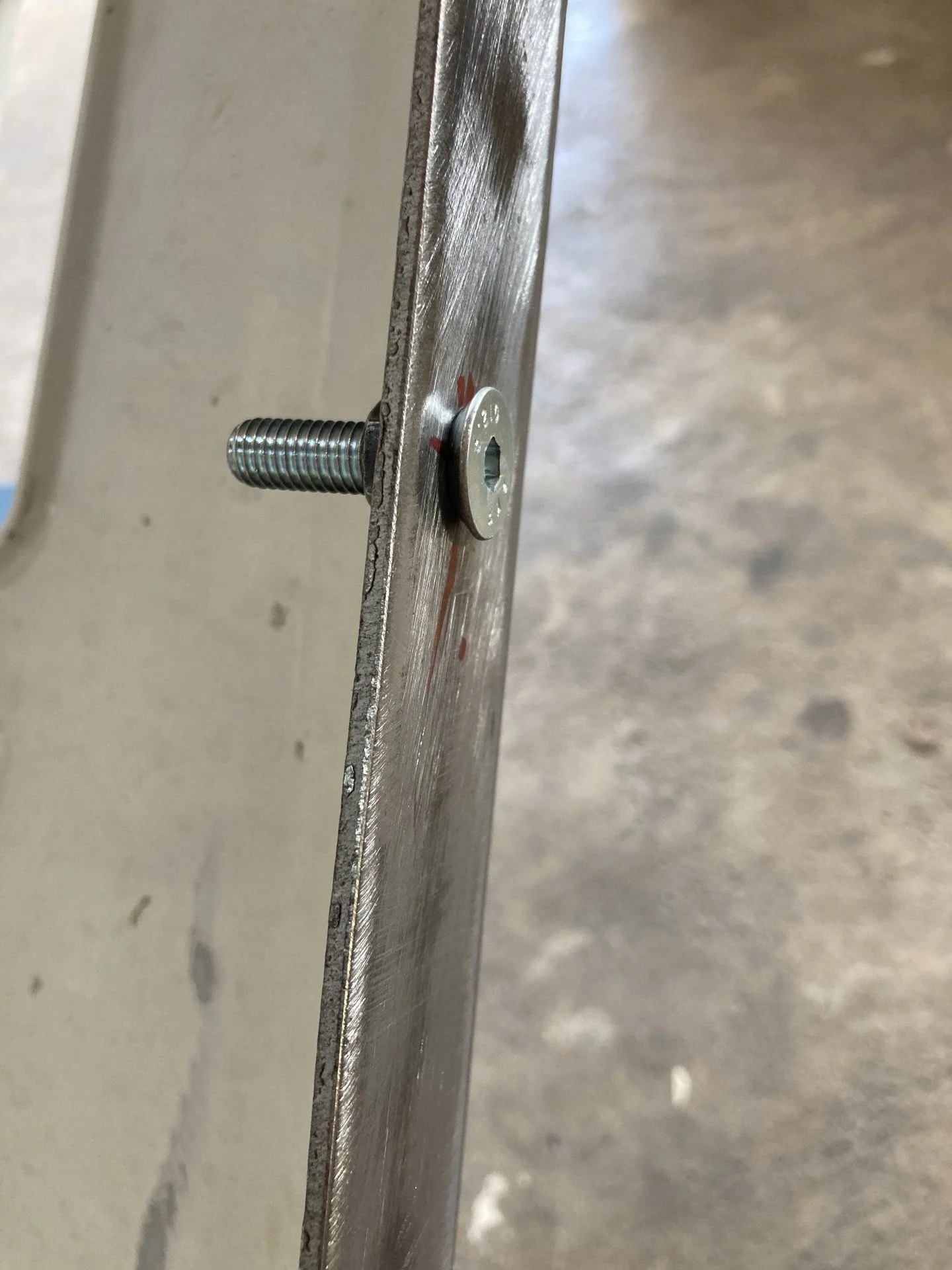

Started with modifying the bullbar this week. Gave it a bit of nip and tuck, so I can fit a higher clearance bash guard. These things have a woeful approach angle.
Welded in new support strips and nuts to bolt the side plates to.
I’ll be sending the bar in for powder coating next week while I work on the rest.

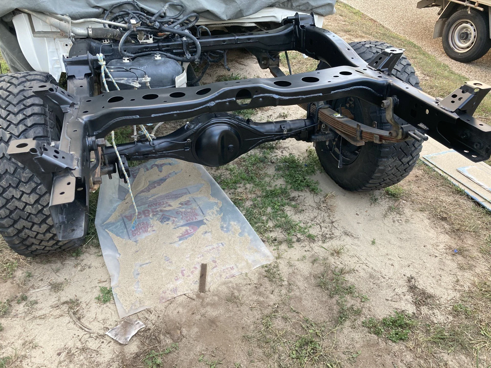

So yesterday I got the tray removed and started cleaning up the rear chassis.
Pressure washed everything then started sandblasting the rust patches. Had to give up in the afternoon as the humidity messed with my air compressor.

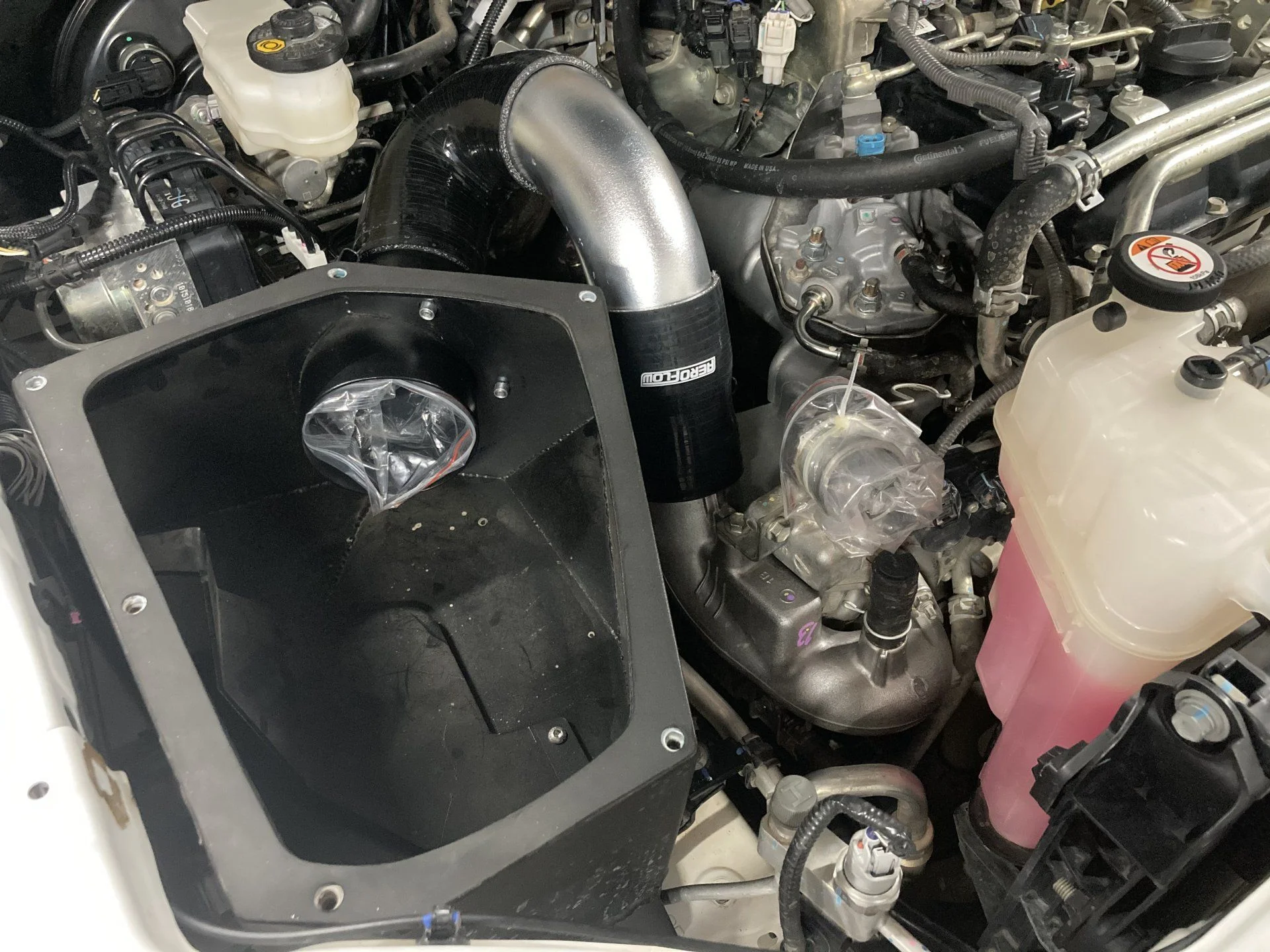

Made slow progress I n between the crazy heat and humidity. I managed to get some paint on though.

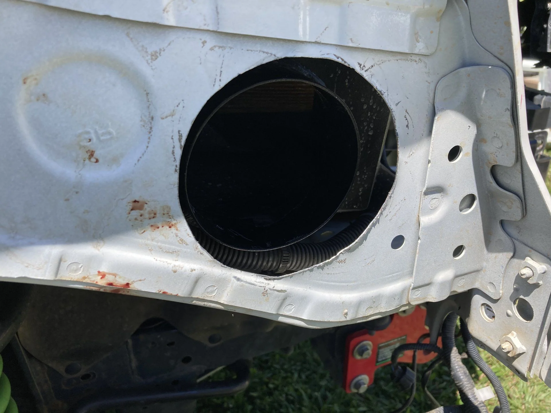

Also expanded the hole in the inner fender for my air intake. The nibbler attachment for my drill works a treat, now the metal just needs painting and covering with pinch weld.

So the humidity finally dropped enough to finish blasting and get some more paint on.
Time to get it in the garage and start installing new parts.:bounce:
