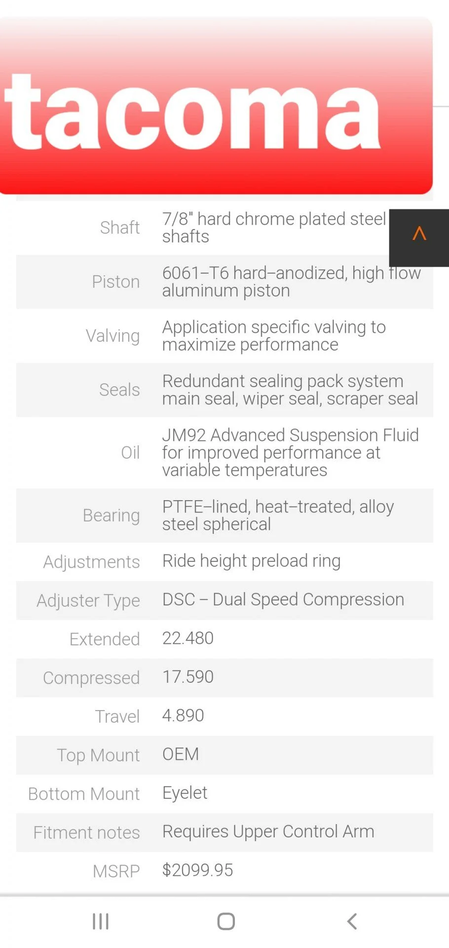

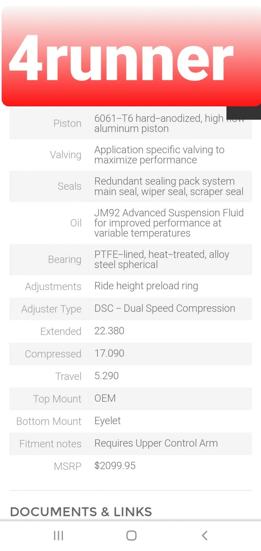

hey guys, I have been searching everywhere for fox 2.5 for the fronts but they are backordered everywhere till late march/april. I found a set but they are spec'd for a tacoma. I know the bolt patterns are the same and a direct bolt in. my question is, when i looked up the specs they are obviously different. can someone look at the specs and tell me how it would affect ride quality, height, travel, etc? thanks
