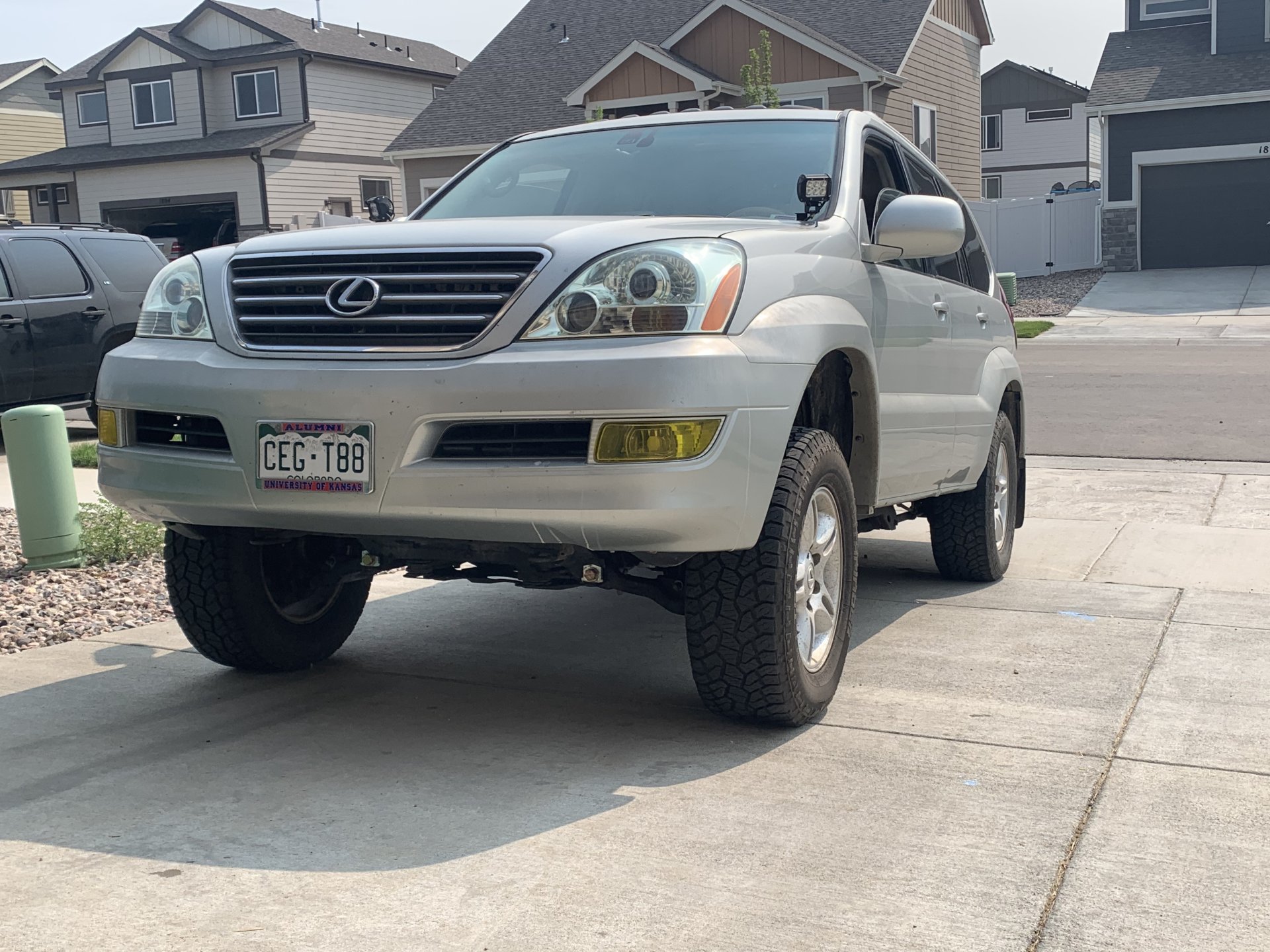

Thanks! I finished up about a week ago and really like the product so far. Time will tell, but the consistency of the setup seems much more appropriate than the more complicated system of adjustment. How are you running yours? I’m centered up front and full outboard on the rears. Alignment this week.
