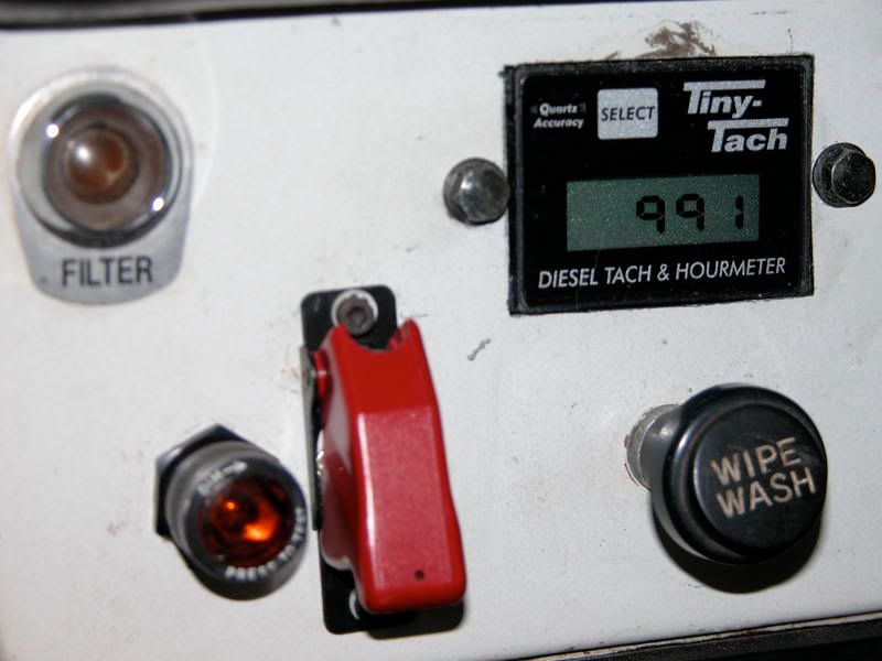

What model and part mumber tachometer would be suitable?

Otterav; thanks I saw the TINY TACH in one of your posts but could not find it. Now have the link
