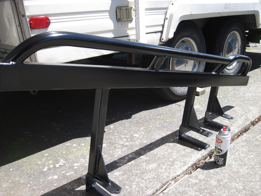

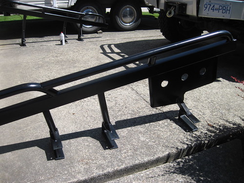

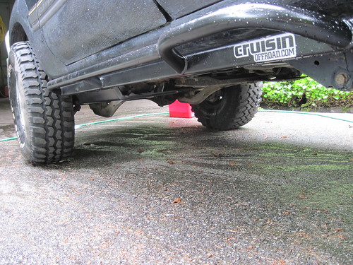

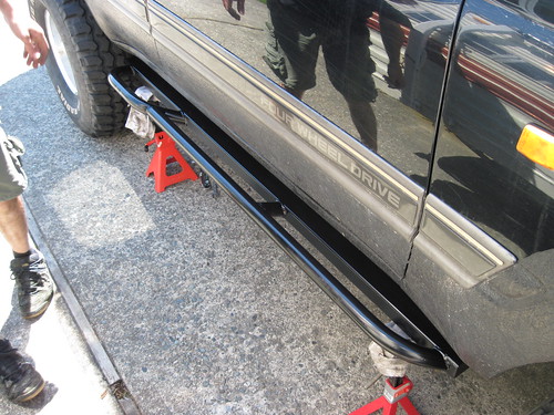

After a long search I was able to find a local fabricator here in Vancouver BC to build me some custom sliders.
He's built a bunch for the FZJ's and HD81's but this was the first for a 3fe truck and he nailed the fit, first time.

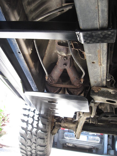

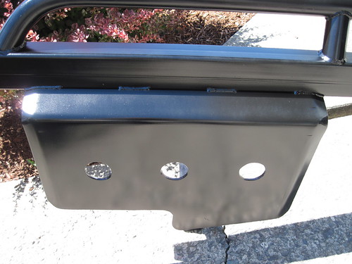

They are sturdy and incorporate a sweet skidplate for the cats. Bolted on in no time. This is Jay's site, I am not affiliated but like to support a small business and a nice guy.

Hey Guys. Glad you dig them, I am super Happy. My last few trucks have all had sliders and you get kinda spoiled, not having to worry about damage, or being super picky about your lines on the rocks. Can't wait to hit some of my favorite trails that I've been avoiding.
I got kind of a special price as he quoted me last year, and they were the prototype for the 3FE, but yes it is in Canadian dollars, so works out to a bit less.
Saved me from welding to the frame. I was going to do some Trail Gear sliders, but I don't weld, so they would have cost the same in the end. Hoping to get a Diesel some day, so now I can just unbolt them, modify one side and move them to the next truck (if that ever happens lol)
The big deal here is that the only other sliders I could find for a '91-'92 were Man-A Fre for $1200 or something like that. For me it's plus shipping, duties, taxes, would be crazy expensive!

Does the bolt that goes in the bracket sit on the top of the framerail, or what exactly is going on there?

The bolt that goes through the top of the bracket sits just a hair above the frame rail. It basically pinches the top of the bracket so the slider can't move.

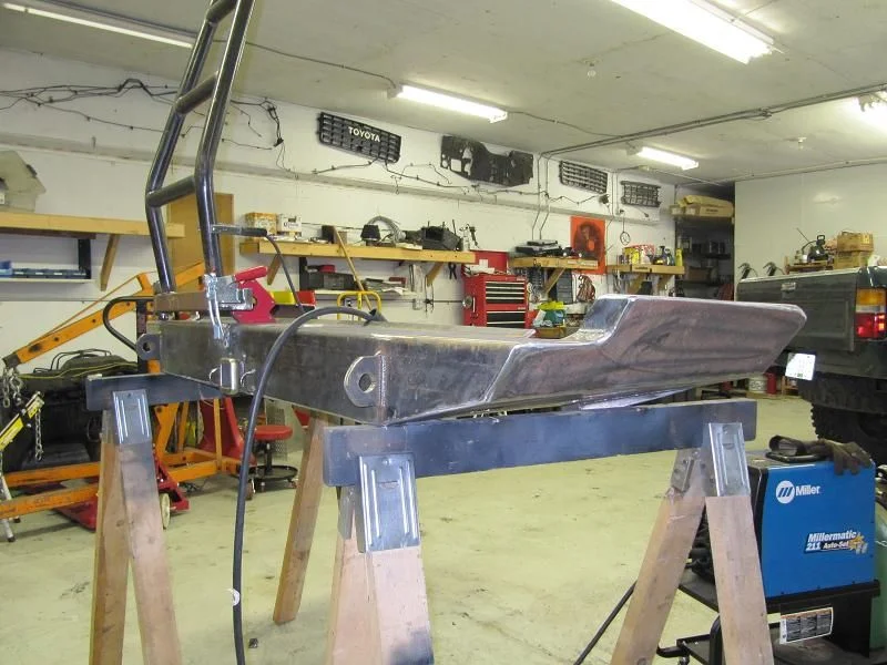

Here's a little teaser shot of the bumper in development. I'll post a fresh thread when I get it painted and on the truck.

Wow - that's exactly the side wing profile I want, and a integrated class 3 receiver is also what I've got planned, plus after a look at your sig linked shop, I'm really liking the transfer case plate too.
