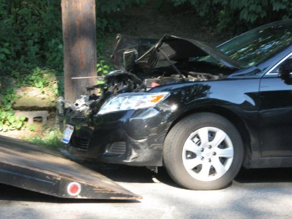

Why didn't the airbags deploy?
You didn't stop fast enough,
pretty common on high side hits that goes over the frame rail. You hit the core support upper and light and cooling and all of the other soft bits rather than the unibody rails that the sensors are mounted too.
Hope you are ok
You have to think about airbags purely in terms of deceleration. You have to be going in excess of 18mph and stop with the appropriate amount of force the bags will not deploy. its not about how hard you hit with airbag sensors it is purely on deceleration.

My wife thinks she was going between 20 and 30mph. She doesn't think she even hit the brakes. Went under a Ranger bumper.

Likely not a total, 8-10k depending on parts usage.
Glad she is OK but not surprised at all at no air bag deployment.

They are at about $11k in damage, parts are ordered and should be ready to go by the end of next week. The rental Chevy equinox is a POS.

I got the Camry back on Monday, just under $11k in damage. Lots of stuff replaced, drives like new imo, paint work looks good. I think it was over $7K just to the Toyota dealership for parts.
