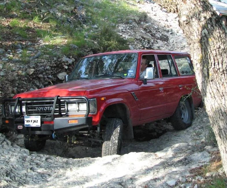

Here is a pic' of our '89 from last summer. Riding 31" tires, open diffs and the sway bars connected. The only thing in the suspension not stock is the OME shackles up front.
Yeah, I scrapped in some places, but most I got through more places that I thought I could, including this one.

You'll find other things with your rig that will hang you up first...like the big ol' rear end on these rigs. Use this outing as a discovery for what is capable on a stock rig and don't smash your rockers!
