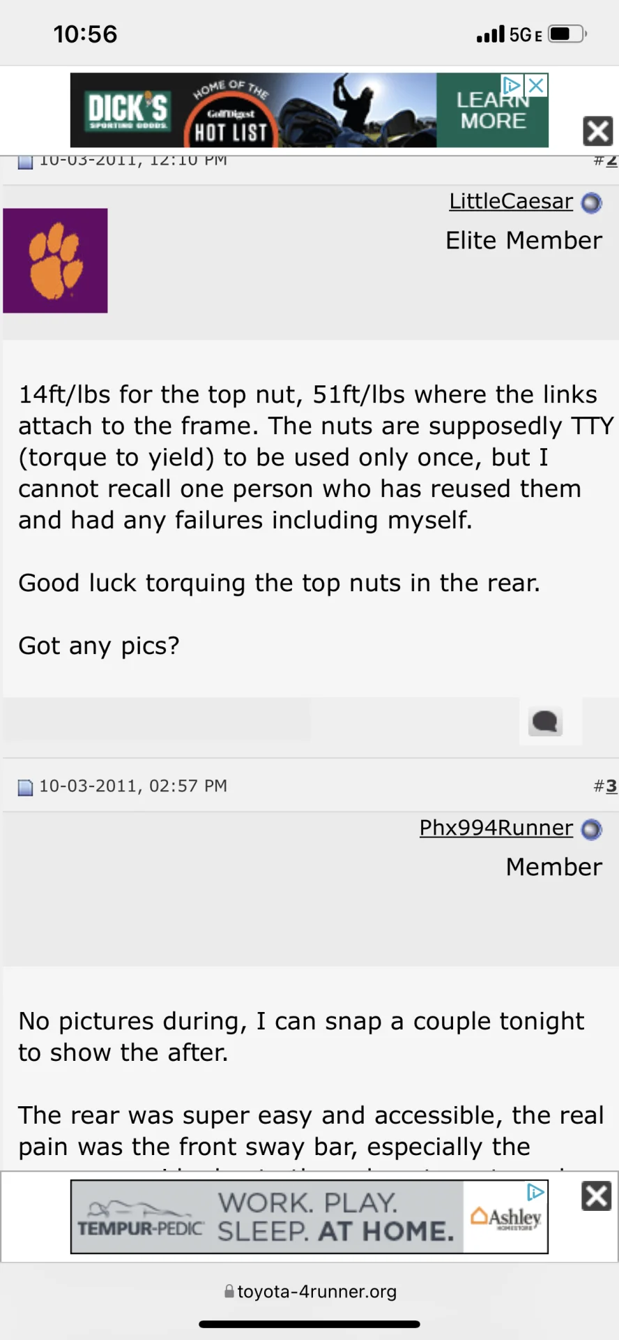

Done and done! Was at Advanced auto parts this morning when they opened the doors. They had a set on the shelf. I got an 11 am for tires so I replaced that one this morning. When I get home I’ll pull it all out and replace both plus the two that hold the sway bar to the chasis. Thanks. Any idea how tight or torque specs. I’m finding a bunch of info but seams a few conflicting things. 14 on the top nut where the link connects to sway and 51 I believe where it comes nexts to the chasis. I screen shotted this this morning.

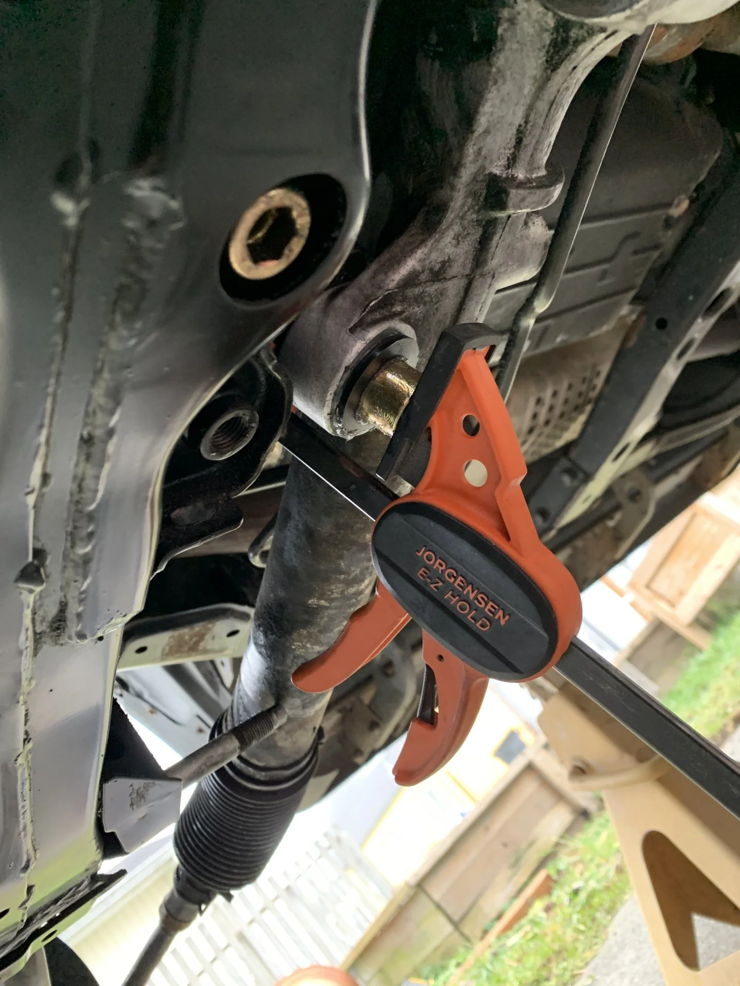

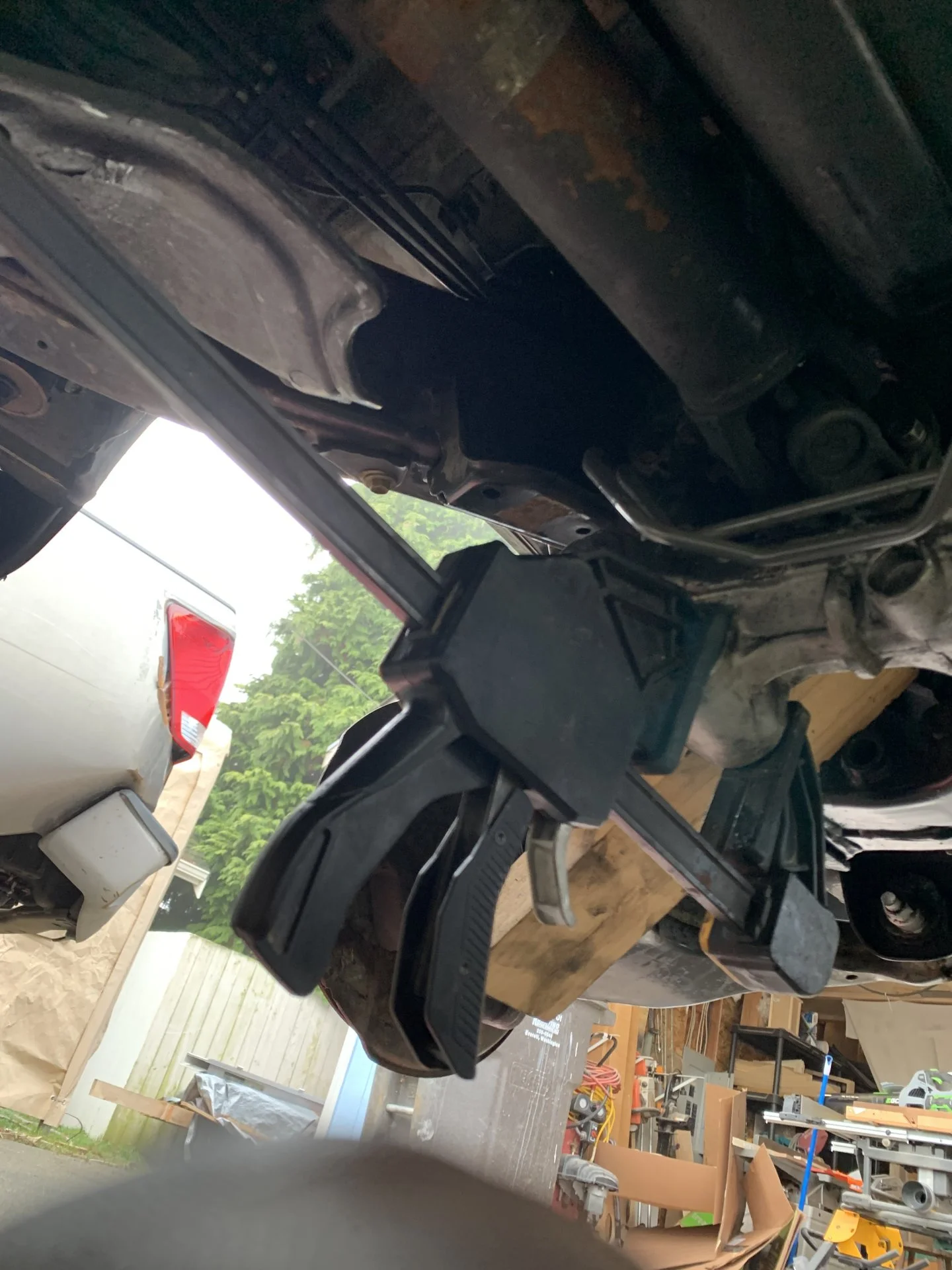

Well, it wasn’t pretty for a hot minute. Took way to long but I got her done. Advanced auto had a set in stock. Went ahead and got them and installed them. Now I can figure out springs and shocks. I figure I may have to change them out anyways later. I was in a time crunch. Installed with the energy suspension bushings. Did the steering rack bushings as well. Used every tool I got. It was a sh*t show. 🤦🏻‍♂️ Will be posting next about body roll and advice on path forward.
