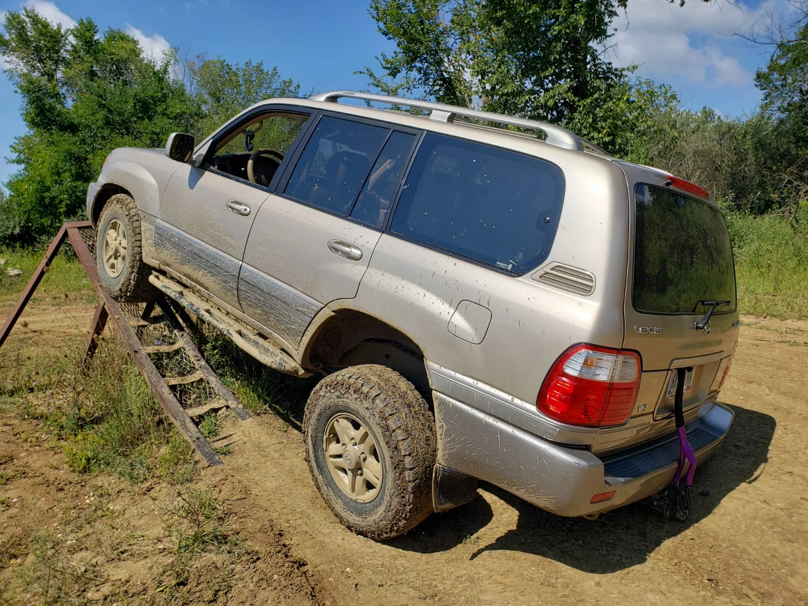

Any input would be greatly appreciated! Here's a pic of my LX as it stands currently - It's also going in for paint, and I could potentially be putting even fewer miles on it if there is some overlap with the paint shop and the shock service, but I'll still need some kind of shock on there while it's in for paint.
