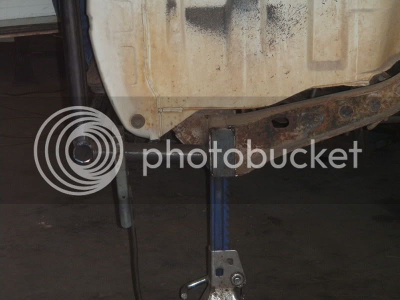

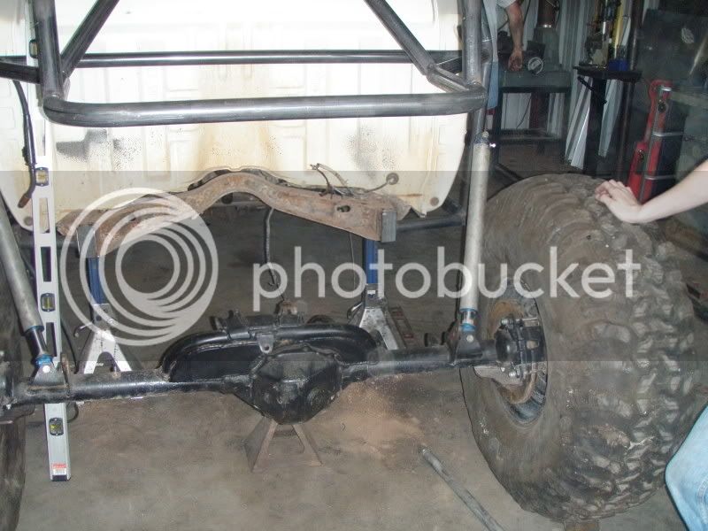

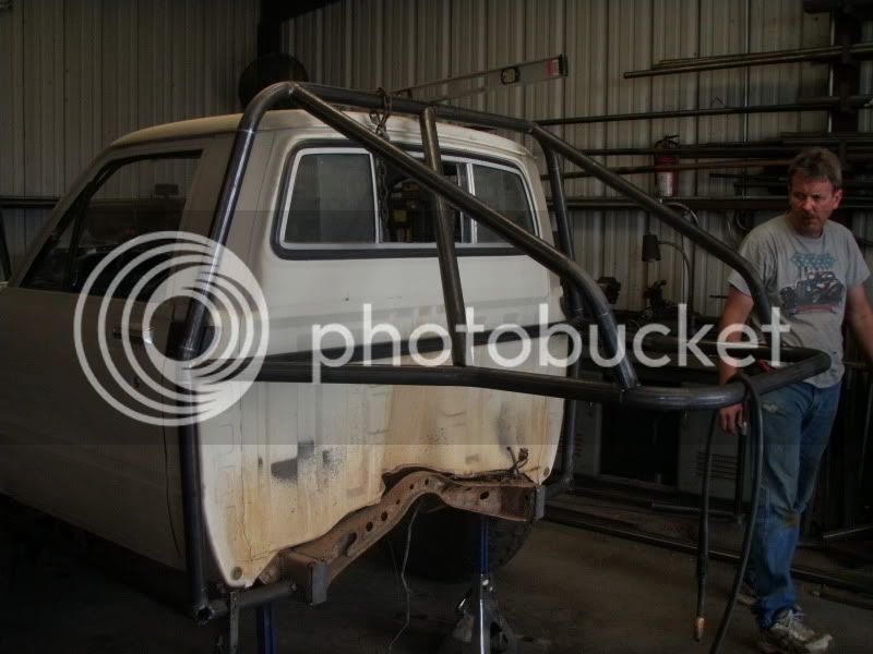

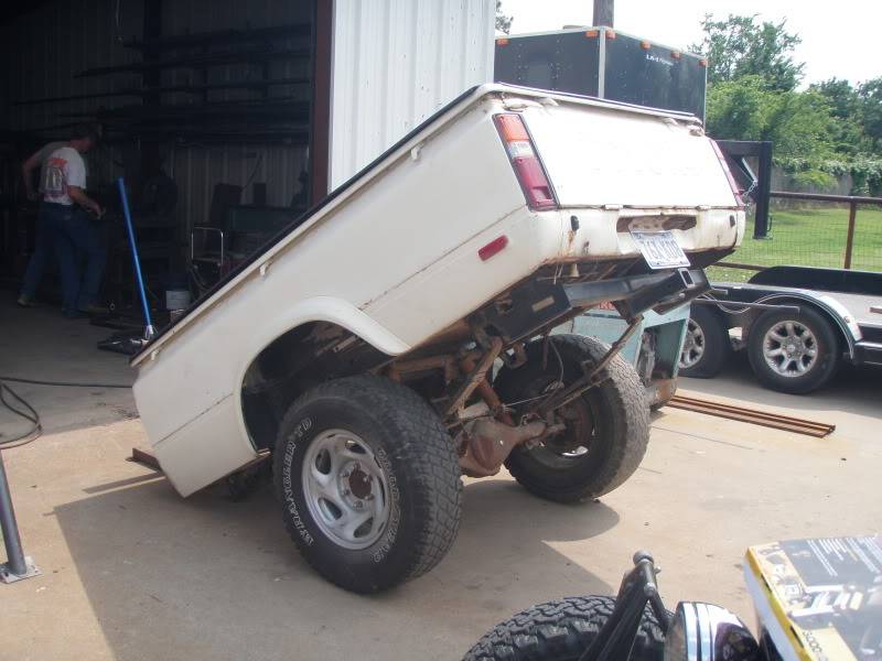

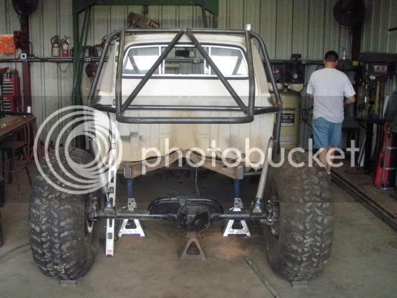

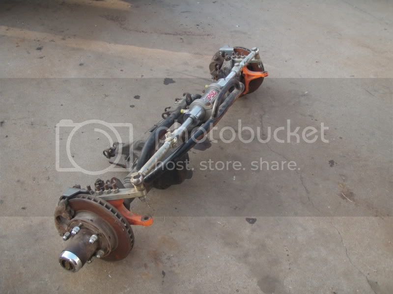

Well it's been a long time but I have been gathering parts and still lack a few. Hope to have all I need and put in here real soon. Two big parts are radiator and the automatic transmission. I have located the auto just need to pick it up and go out and buy a new radiator. Here are some picks of the work so far.

That slushbox will up the ease factor for wheeling, but the overall product may still be doggy. You may need steeper gears at the axles.
Good luck!
For a dedicated crawler, I'd slap that 22R up to an SM465 with one of these:http://www.advanceadapters.com/products/pn-712556/
and never bother with any gear above third.
