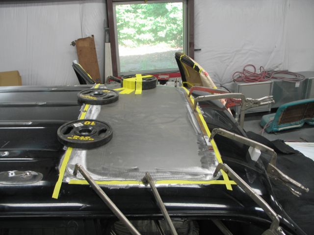

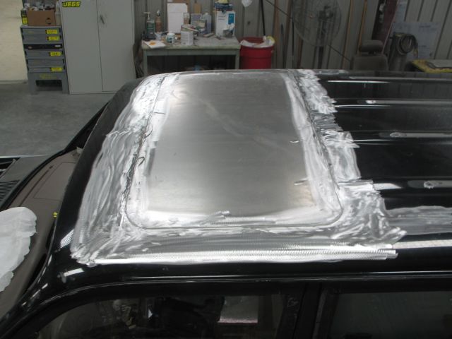

Not really the body shop did all the work. Cut and profile the panel, weld in, skim some bondo and paint.

We deleted the sunroof on the UTE project. 14gauge steel. really easier than I thought it would be. almost straight. For the headliner, we took extra headliner material and placed it above the open sunroof hole, then took some of the brown door edge material (open your door and look at the top half covering the seam metal and trim) to finish it off.
Really does not look that bad, for a free fix. I had found a thread were someone had covered their headliner with other fabric/material, and was planning to do that; however, this turned out fine (is quiet) and really how often do you look up?

I plan on using Automotive panel bonding adhesive then blend it in with filler and then Monstaliner. No welding no rust I guess.
