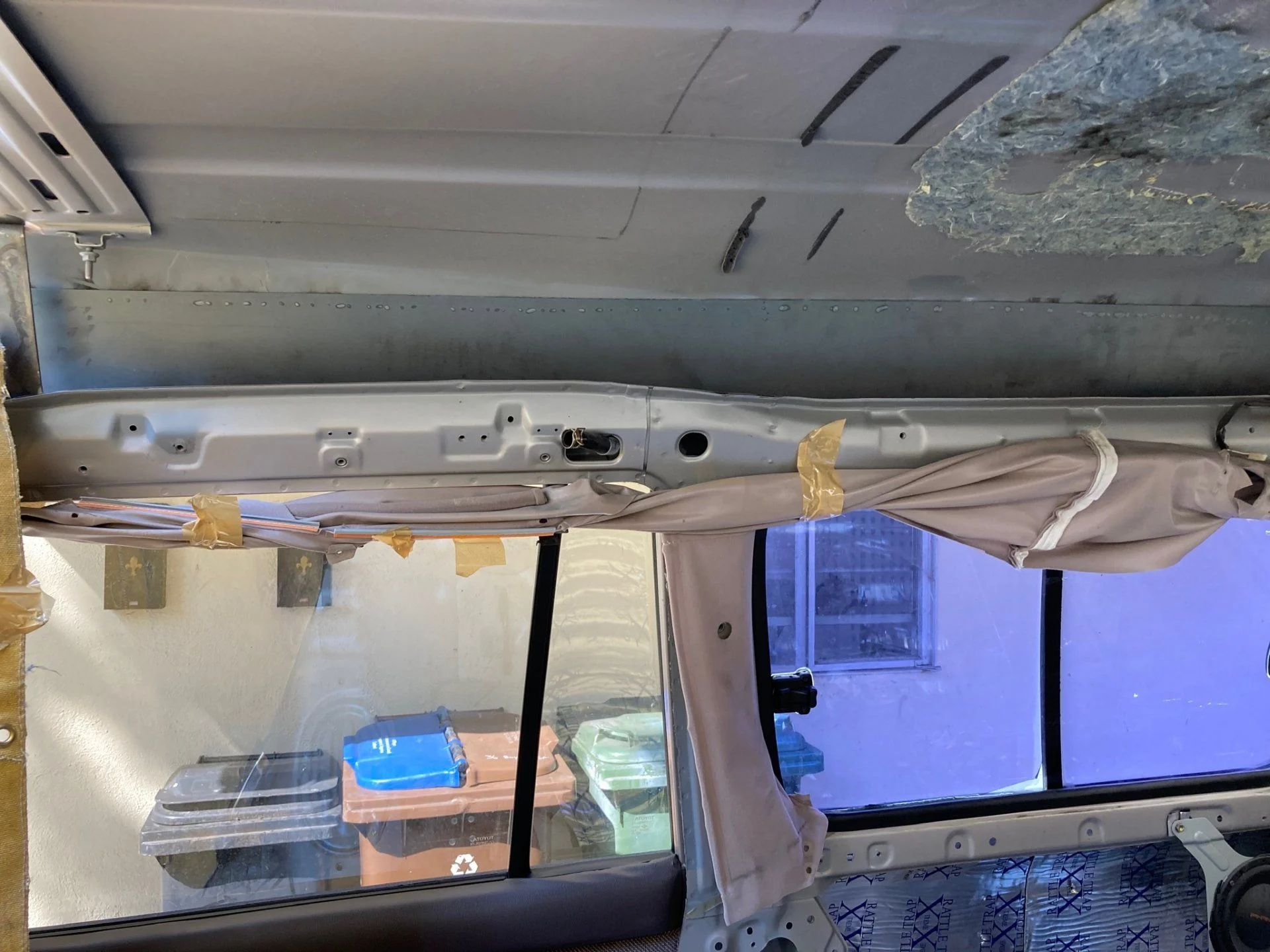

Hey all, I just had my sunroof deleted and the body shop has called to ask about re installing the headliner and re attaching the lights and such. They removed the entire assembly, so there is no place to reattach the lights anymore. My options are leave it as is and try to get someone to modify/make a new headliner that sits flush with the roof and allows me to reattach the lights, or have them reinstall the tub, minus the window, so that everything bolts back together. I'm thinking the latter makes sense so I can just close everything back up for now. Any thoughts?

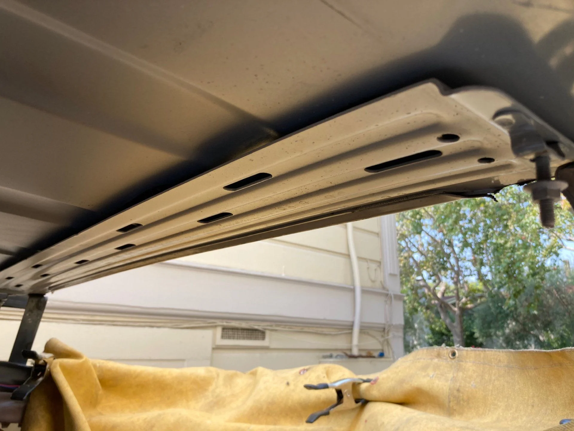

yeah- tell them to pull off the roof crossmember brace and reinstalll it. the rear one is drilled for the light assembly......abd the front one has room to be drilled.
Looks like the one in your pic is at the back of the car. Are you saying pull that one? Or pull one from the sunroof tub? Could you explain further, I’m a bit confused which one you’re talking about.
i just put the light back up with some 3m tape. i also used velcro to hold the sunroof slide cover in place so it all looks stock. i keep a few guns on the new plate with magnetic mounts now where the sunroof was. nice to have options.
the front one could be drilled just like the rear one is and you could have an install point. or just 3m tape it up and you are good to go. I ended up raising my roof 7" so those pics were from removal and reinstall of them albeit higher up.
