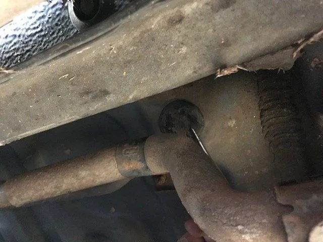

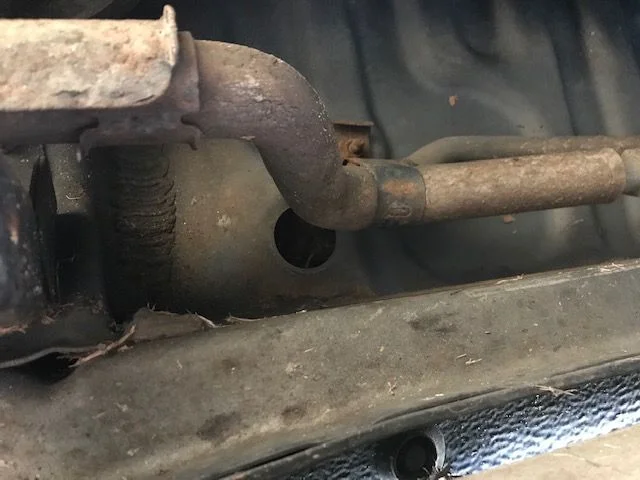

I've read all the sunroof drain post I can find and I understand everything in theory for series 100 sunroof leaks. I checked out the drain holes up in the sunroof tracks and they look real clean. I've used compressed air to clean, but what I'm really confused about is these post about going underneath and pulling out the plugs. Many folks say I should be seeing debris / dirt build up that is causing it to not drain. Today I looked underneath and did find a ~1' rubber grommet. I was fully expecting to pull this out and see a bunch of leaves and build up, but all I saw was the black rubber tube running by and insulation foam. All looked well. I also stuck a small screwdriver in the little slots everybody talks about, but nothing really found there and they seem so small I can't imagine heavy build up in those.
Am I in the wrong spot and need to go somewhere else to unclog where the water ends up finally draining out?
Here are pics from the DS and PS.
I don't recall drains there. They're more like slits in the metal. Pour some water in the sunroof tub, you'll see the drains.
Wrong spot. They drain out of the seam in the rocker panel. Unless you're block up, doing what camino70 said will show you.
Pour water down the drains, crawl under and when water gets in your eyes you found them.
But the drains drain into the rocker panels. There are slits in the rocker panels to let the water out. Those slits clog. Rocker panel rusts out.
okay...thanks. So poking small tool in all those little slots helps? Seems like any debris is still going to be floating around in there. I'll try poking and clearing up as much as I can in those slits.
Am I on the right track if I do that? I def have all the symptoms of clogs sunroof drain lines so trying to end this water falling on me and really bad fogged up windows.
