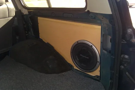

This is what i did for my 94' Land Cruiser. This was my first attempt at an enclosure for the LC and its has its ups and downs.
1. The details
- 10 inch Pioneer sub (TSSW251) It is a shallow mount needing 3 inches basically.​
- the box is 3/4 mdf ... could have gone 1/2 but didn't. the front is flat but the back starts to taper in just before the top of the sub.​
- i don't get any vibrations and the panel snaps fully into place minus a couple bottom clips i took off as the box was in the way. (very bottom next to floor carpet)​
2. Space Lost
- Ashtray: I should have made the box a bit shorter length wise as it made its way into the rear ashtray space. About an inch shorter and i wouldnt have needed to remove that.​
- Side storage:There really was no way to keep the side storage space... I could have made the box even smaller but i think the sound quality really would suffer.​
- I am going to paint the box black and you can see the mdf through the stock speaker grill​
3. The amp
I am not sure where i am going to mount this... right now it is just laying in the back. There is room on the other side behind that back panel above the stock jack. I think this is where it will go unless i get a smaller amp. The amp i have is roughly 7" by 8" by 2" ... and is 300 watt bridged rms.​
4. The sound
- the sound is different than i would have expected. The low end is HUGE. if you want low boomy bass than this size seems to do it great. Where it lacks is hard hitting higher frequencies. Not 100% sure but think the small box size and sealed enclosure make it hard for the sub to move quick enough for that fast punch (could be way off here ??)​
I think i will try for another version next making it a bit shorter so i can put the ashtray back in. I may use 1/2 MDF this time. Also there is quite a bit of space right below the sub in my picture. This box ends right below the sub (basically at the rear floor level). I think i can extend the enclosure so it goes down into that space below the floor 3-5 inches maybe. I haven't calculated the exact volume of my current box but expect it is around .5 cubic feet or most likely a bit less which is right in line with the spec for this sub in a sealed box.
Overall i am happy with it, but wish it had a bit more punch at the higher end of the lows. It has great boomy lows as is and surprised me tons for a 10". i used to have 4 12"s in a pathfinder and then 2 12"s in grand am. I don't really care for super boomy bass anymore and really am just looking for nice clean sound. I would even be curious how the pioneer 8 would sound...
Anyways i thought everyone on the forum might like to see what i did as i know a lot of people are interested in what to do for a semi stock like sub replacement.

I bet you can mount the amp on the in roof(inside). I have seen installs like this when room is at a premium. It would be just like mounting a roof rack upside down. There are support beams up there to attach it too. If i would to do it, i would use an aluminum plate since it would be lighter and stronger than wood.:hhmm::hhmm::hhmm:
