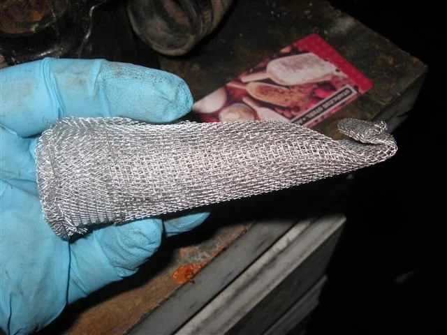

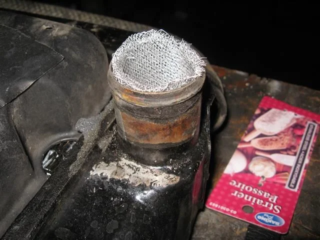

When I replaced my rad I wanted to flush the system as well so... I made this out of some screen door mesh I got from the hardware store and folded it into a cone.
I then put it in the intake of my radiator to catch all of the crap.

I used a strong rad flush solution and followed the directions. Most of these things are acid to dissolve the minerals that form inside.
I turned my heaters to cold to stop circulation to them (or they will become your filter trap) and high idled my engine to get it nice and hot to open the thermostat. You could just remove if you wanted.

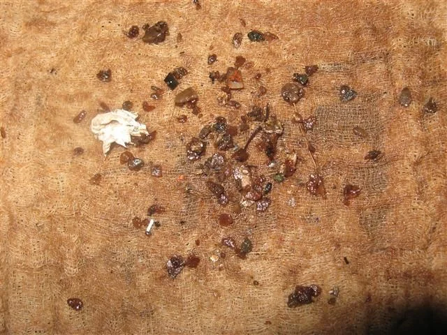

This is just a protion of what the rad trap caught. That white thingy is a big piece of silicone.
Some of the larger pieces are about half the size of a pea. There was tons of crap in there. After a few clean outs of the filter, and there was no more dirt, I opened the heaters and let it circulate. I then back flushed my heater cores with water and compressed air (10psi) and got alot more dirt out. I used 2 plastic jugs to catch the return fluid. The heaters have 2 inlet hoses and 1 return so its actually easier to do than it sounds, its just a messy job. After using the compressed air, I hooked up a pump I had laying around for pumping water in an RV and finished back flushing till it was clean. You could use one of those cheapo pumps that attach to a drill from harbor freight or something. Heaters work awesome now. Guess they were quite plugged.
On a side note, just so no one tries to sue me for horrible burns to their face and genitals. Please don't undo rad hoses or open your rad cap when your system is hot. And... if you just said "why", please dont try this rad flush thing at all.
