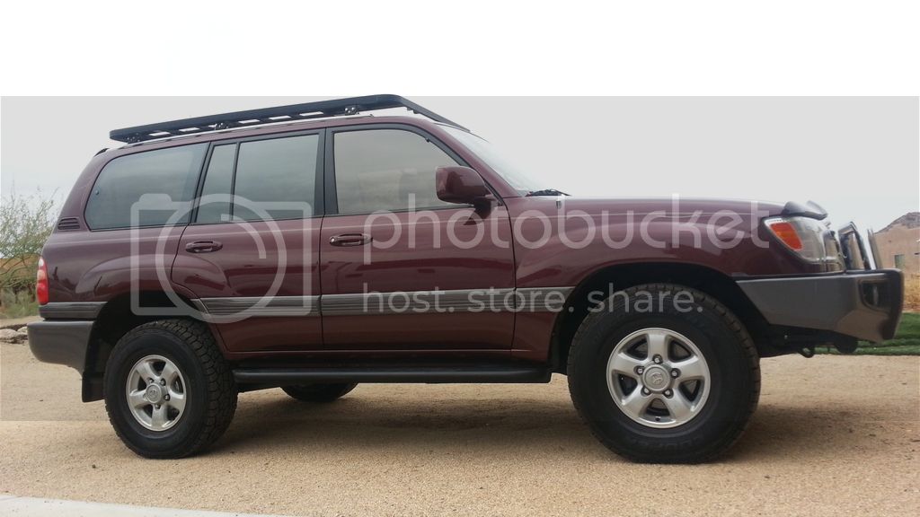

I've had the Michelin LTX M/S as well as the Nitto TGs, both great tires for what they were. Now running Cooper ATP in 285/75/16 and so far very pleased. I believe these are a Discount Tire private label Cooper, not 100% on that. In any case, they were quite a bit less expensive. So far I love them. Not the best tire shot but here's what they look like mounted on a 100.

Nice looking 100! I have those coopers in a 275/65/18 on the wifes 2004 100. They seem to be doing very well. Definitely a good choice from what I have experienced so far.
Nice set up.. How many inches of lift?
Thanks. Barely any lift - OME rears and stock torsions cranked a hair.
In the pichure. I see that in the left that was the nttos. What were you running before that.(on the right)
They were worn out BFG ATs....
