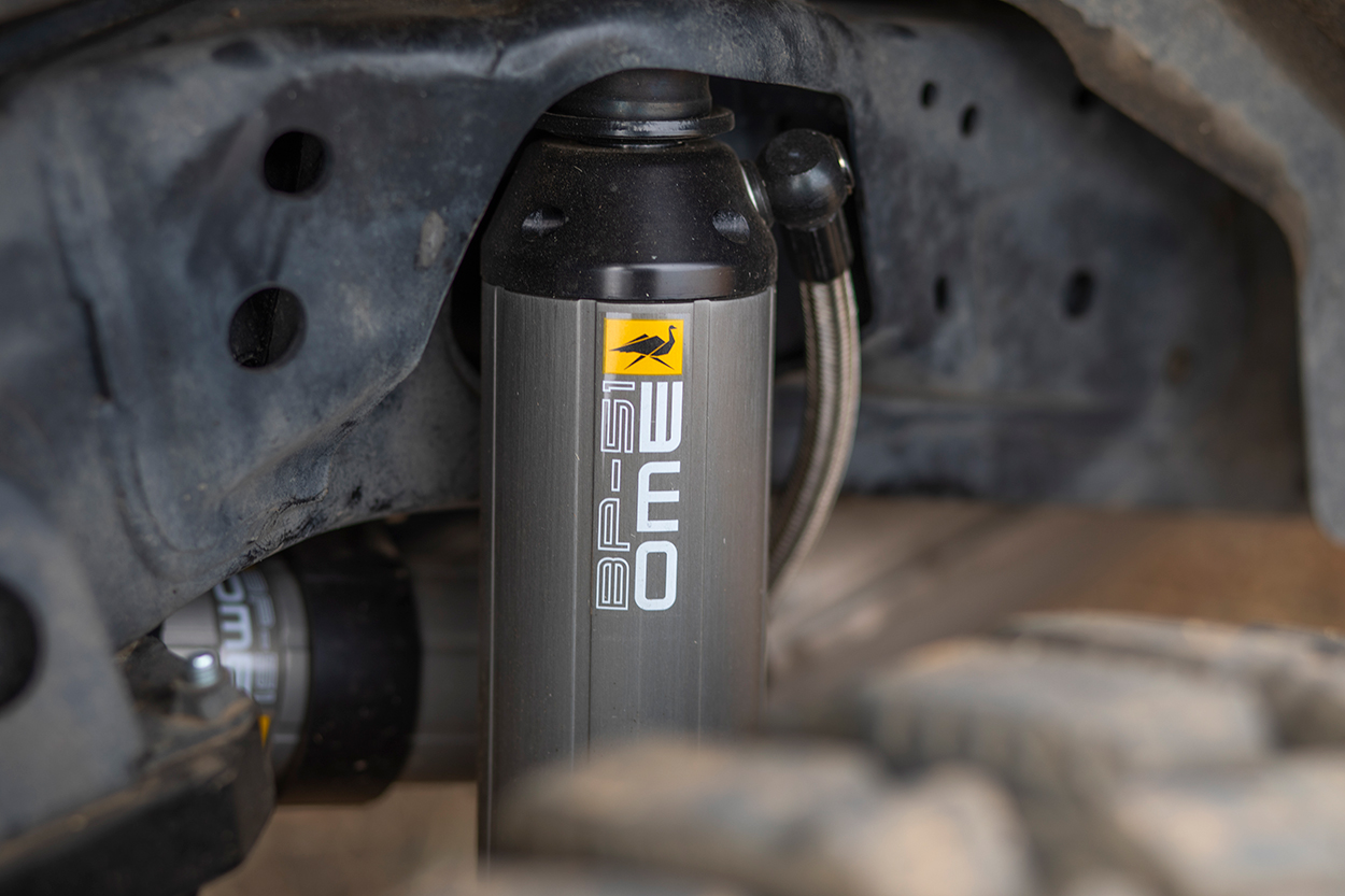

I just went to adjust my rear BP-51s to dial up compression a bit ahead of a weekend 5 person trip. The only time I have messed with this is when they were installed. Its been 3 years or so. I can't get the rings to move without rotating the entire shock. I don't have all my tools with me or I'd try a strap wrench in the shock body. My other hand isn't enough. Should it really be this tight/difficult to adjust? In the OME videos they don't even show using the other hand to hold the shock body.
I haven't had them for a few years, so my memory is fuzzy, but don't they have two "tunnels" where you can place a small bar/screwdriver through the shock to stabilize it?

I didn't notice that but maybe. I'll be down at my shop tonight where I can take a better look.

I think this image shows one of the "tunnels" in the black collar.
