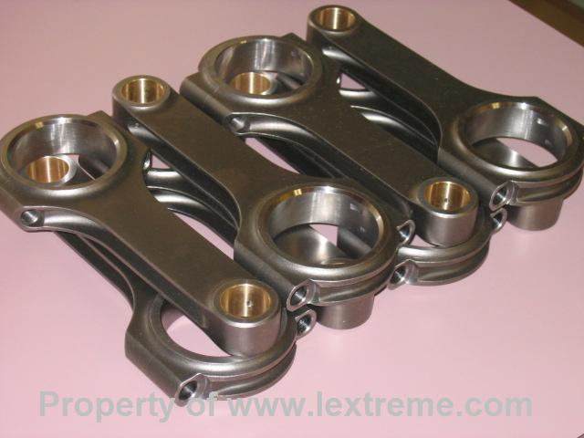

Just means you'll have to add the cost of some Lextreme Forged H Beam Rods at $650/ea plus installation!
Holy Crap...$650 EACH?!!! Hmmm...guess I'd keep the boost low and take my chances.
You think the rods are expensive, I found the website with those and they also have a custom stroker crank. Takes the 4.7 out to a 5.6 or something like that.
The crank was only $7,000.
I think I would just buy a new Tundra 5.7 under warranty for that much hassle.

I also don't buy into the weak rod theory... but then again, I don't want to be a web-expert because everything I know about this I have read. I do think though that the 4.7 in the LC is much differnt from other 4.7's in the Toyota lineup. I get the sense that the material of the rod more than makes up for the size. Remember, you can have a big old bulky rod made out of crap material and it will fail too. I am doing more resrach into this. I will admit if I am wrong, but I have trouble believing 5 psi will cause dmage to this jewel of an engine....

The engine in LC use the same connecting rod as Tundra. They are well known to break under high boost. This is proven in middle east and they would not turbo charge V8 LC anymore unless you update the internals. Even TRD supercharger system could blow this engine when the pressure spike above the rated 6 PSI.
Well, I wonder what was undated in the engines that make 270hp+? I still have a hard time believign that 5psi would cause signifcant dmaage to the con rods.
If anyone has as source fro detailed engine if, I'd apprecaite a link. ANd Why are the aftermarket rods so epenseive? $650 per rod X 8 is $5,200.:eek:
A set of custom rods from Lunati, Manley etc., isn't more than $1500
