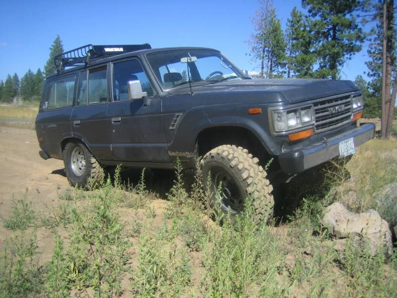

Finally got my 33's
What do you guys think?
