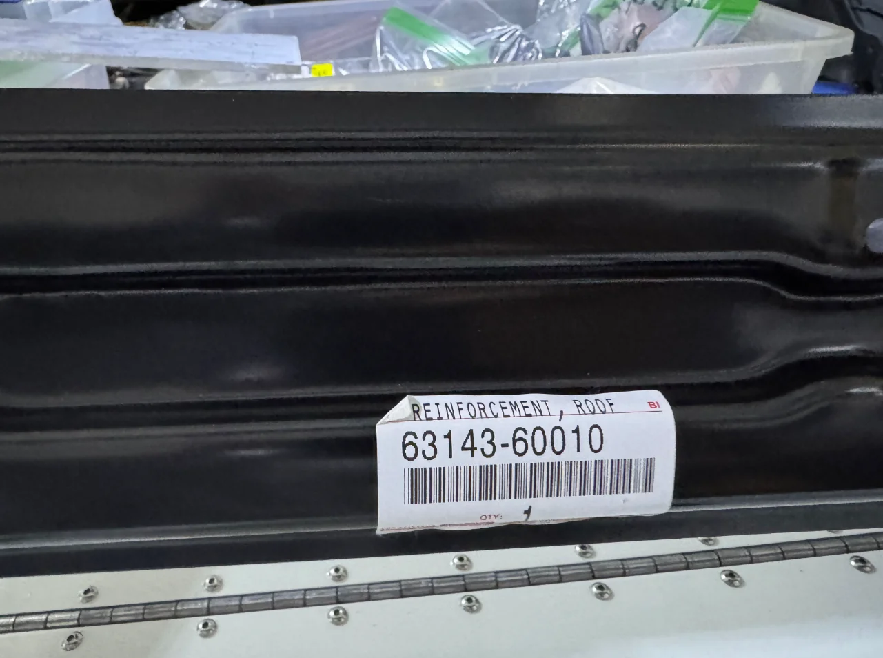

  • #2 - 63143-60010
    • The unicorn!
      • All US dealers show "in-stock" - none can actually produce one
      • MegaZip shows "in-stock" - but on perpetual backorder
      • ToyotaPartsDeal shows "in-stock" - claimed to have shipped it, never did, claim they cannot source it
      • Japan4x4 - Dave has ordered this through his sources and seems confident he'll have it in his hands next week
        • EDIT: DAVE IS THE MAN! He was able to track down this part!
    • EDIT: This bar is very close to the #3 / #5 bars, however it has a smooth top, there the other ones are contoured to match the roof strakes
      • The width and curve of the bar is identical to the #3 / #5 bars
      • The #3 / #5 bars are slightly taller at the ends of the roof skin, ~1/2"
      • Because of the way the bars have to be cut for installation, I believe a #3 / #5 bar would be completely usable for this application

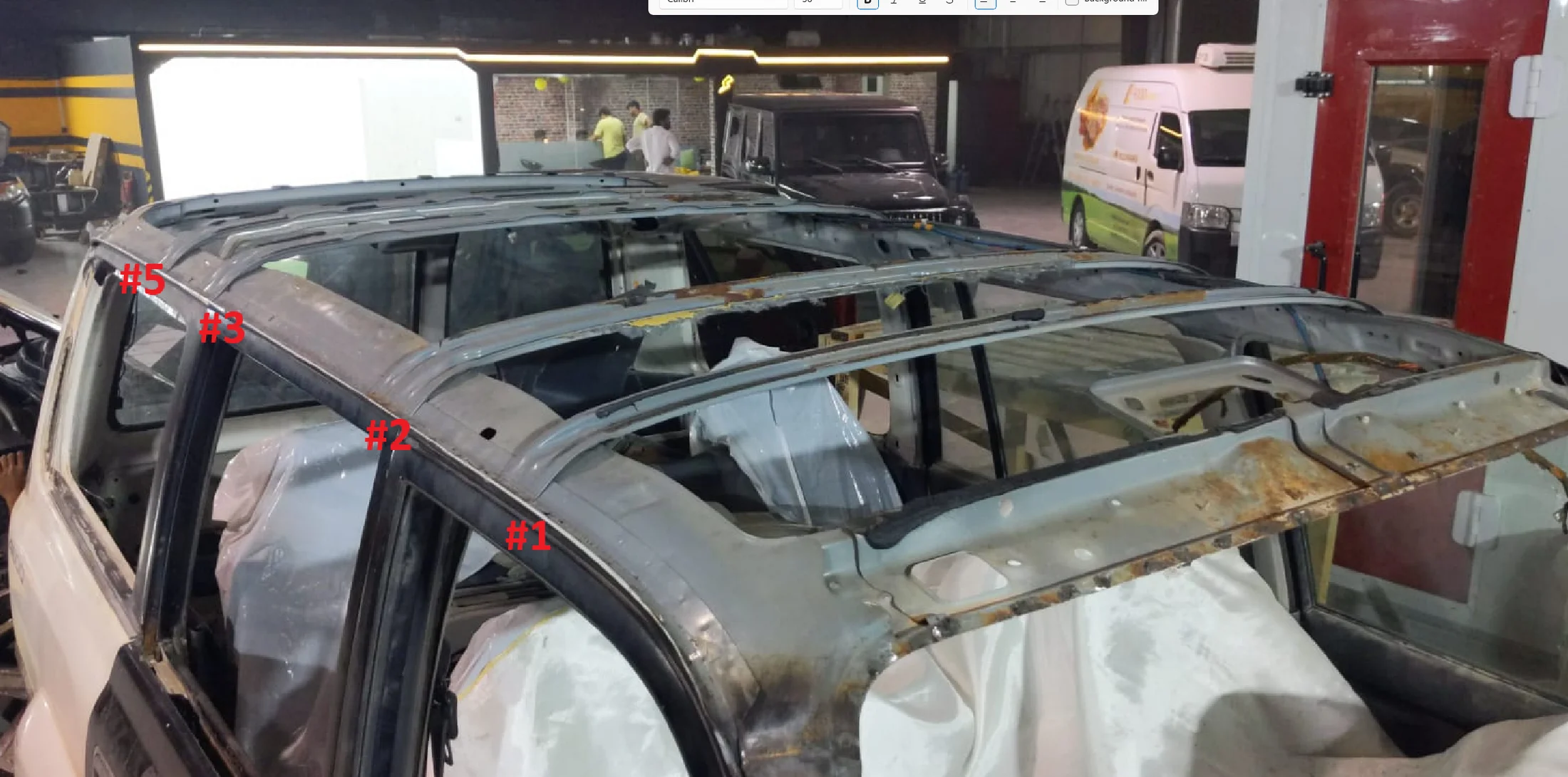

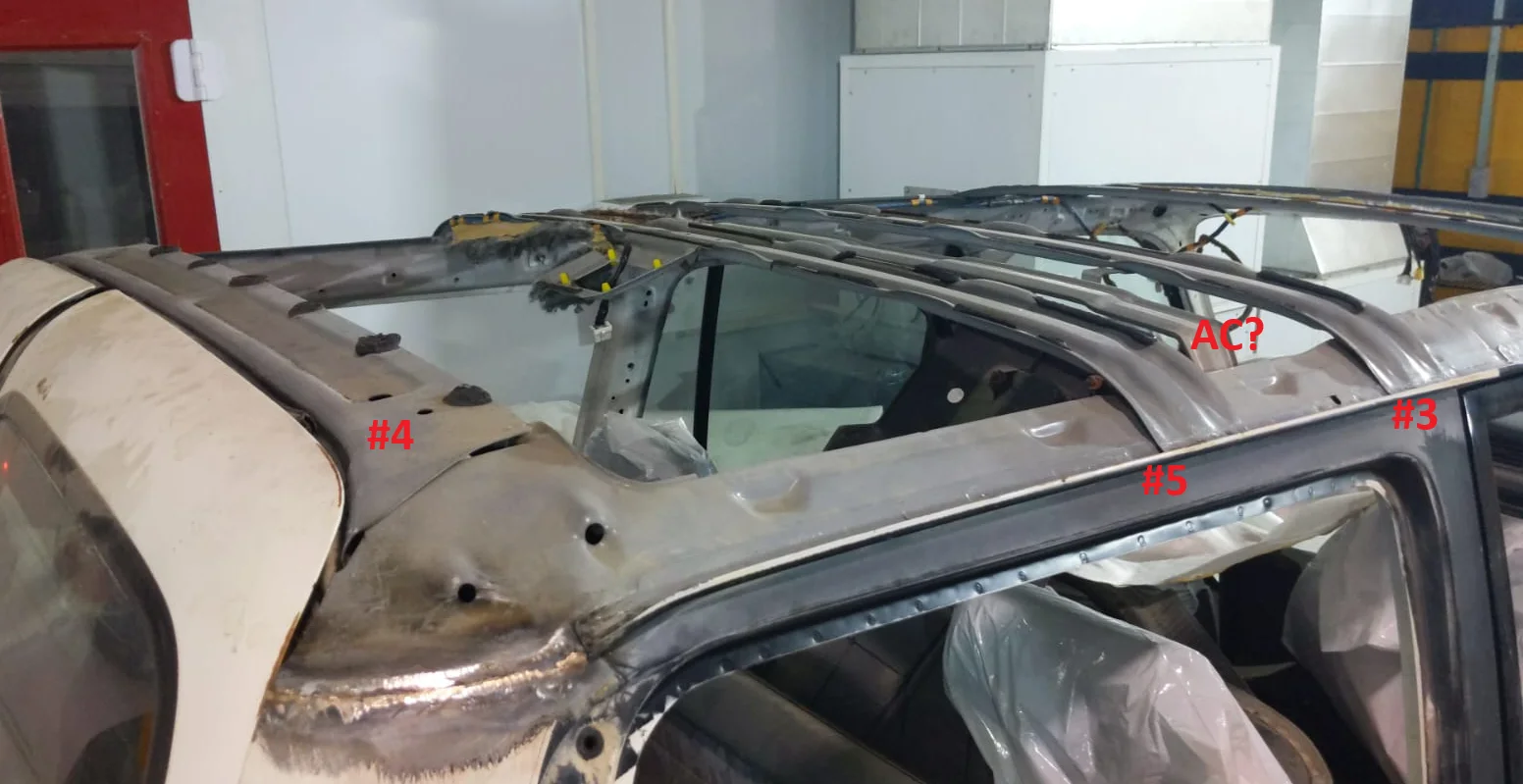

These are the best photos (Credit @John Young and his Holy Truck build) I've found of the layout / installation of the bars. They are installed under the roof skin at the drip rail.
John's truck appears to have an additional bar between the #3 and #5 bars. I believe this is for a Rear AC system, but that's just a theory. I don't see it existing on any of the other sources I looked at.

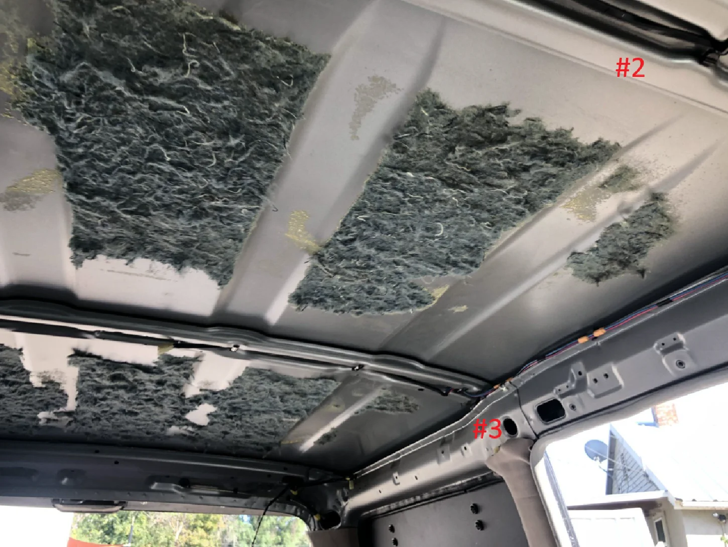

This is a photo of an Early 80 with no sunroof. Note that it's missing the #5 reinforcement bar. (Credit @swankstar from his Locked 84 build thread).
I don't intend on removing the roof skin for this project, so my plan is to secure the ends between the roof skin and the body side rail. I plan to use a body panel adhesive (SEM 39747) to attach the bars to the body rail, and a vibration control material (SEM 39977) between the bar and the roof skin.
Bars #1 and #2 have divots in the body side rail that correspond to the location of the rails. There doesn't seem to be anything to locate #5, so I'll be going off the location in John's photos.

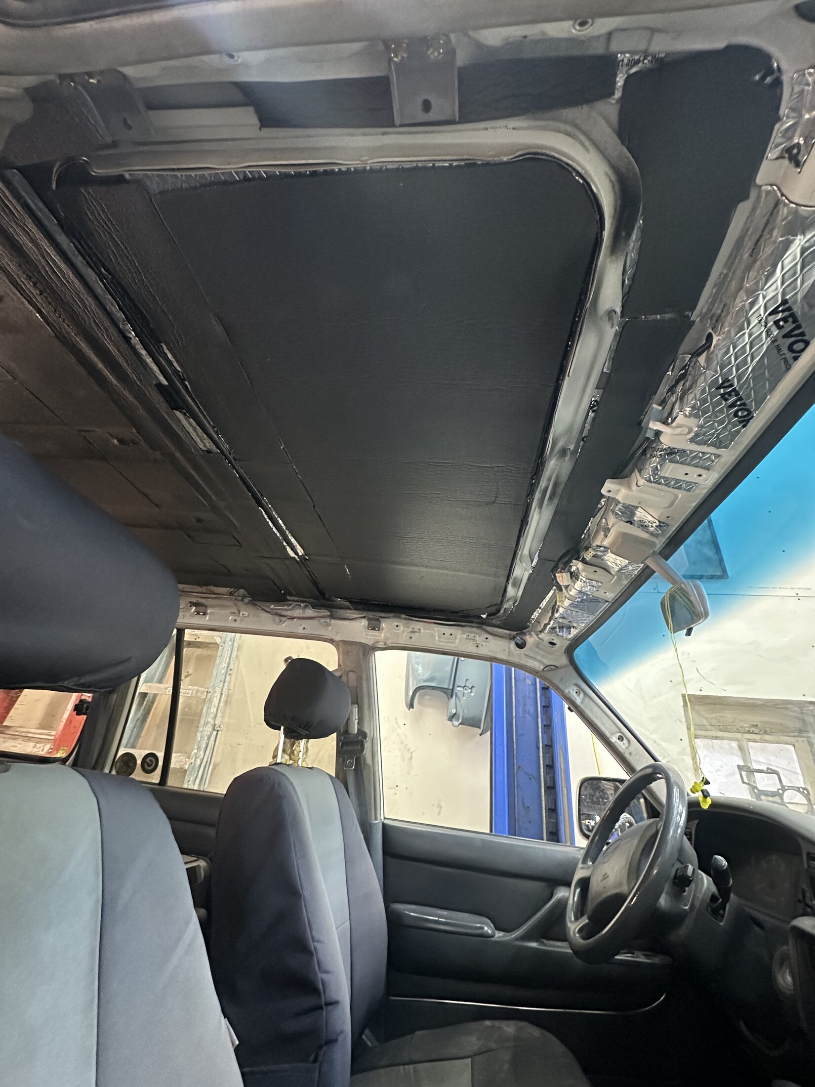

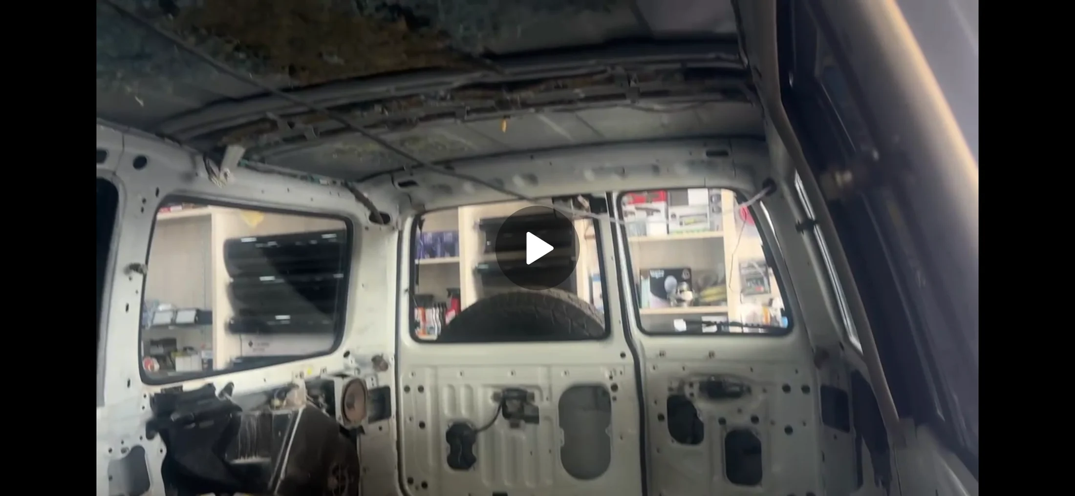

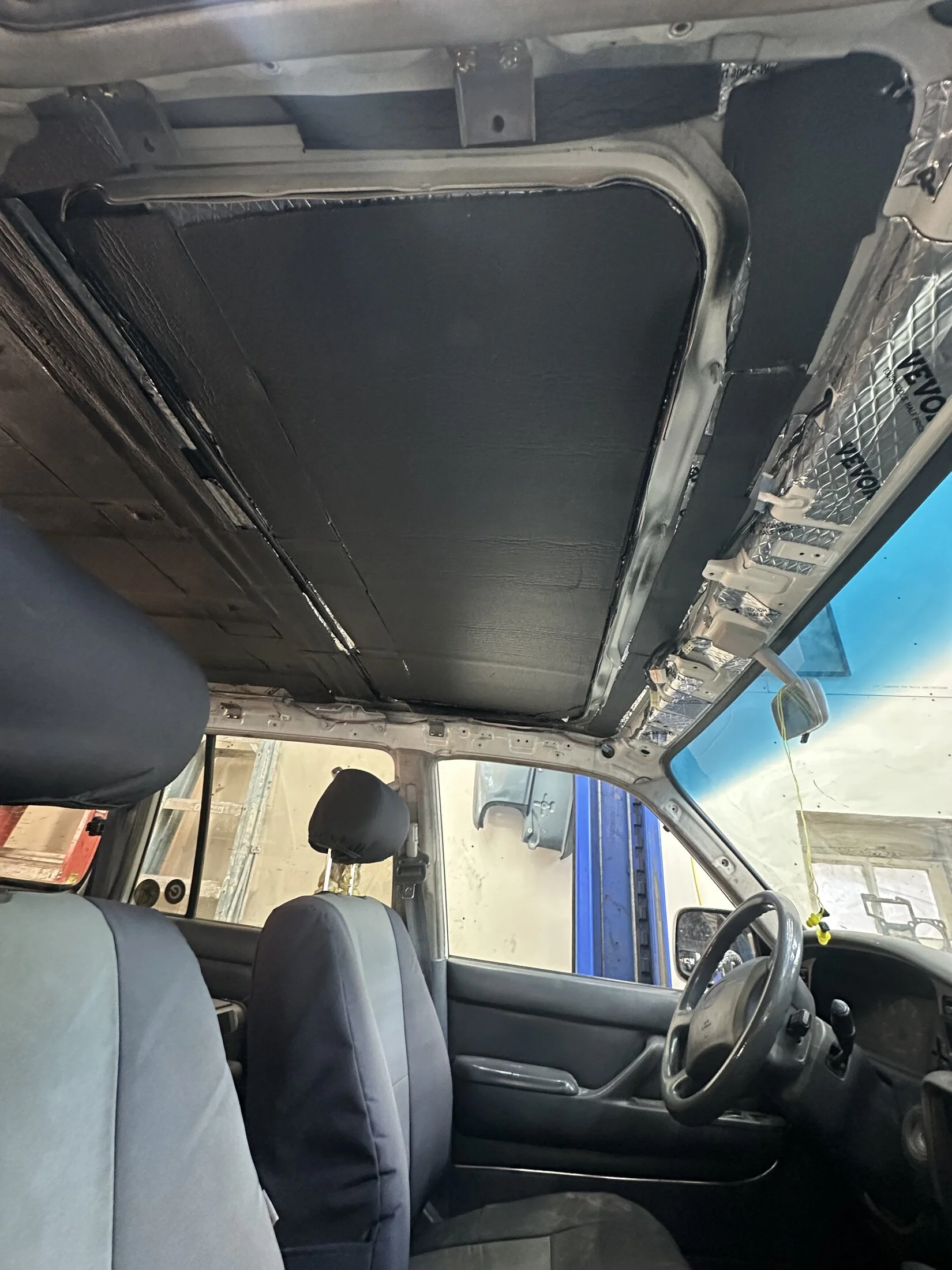

Hi RM. I believe you're right about the aircon support member. The holy truck was a or rather is a 1997 just to fill in that blank. I also have a 1996 diesel 80 that just got a bunch of sound insulation and I may have some photos of that that show stuff from the inside. I will have a look. Incidentally, the holy truck is arriving in Savannah, Georgia. In a couple of days. My son and I are attending to drive it from Savannah to Las Vegas and then back to Florida. Essentially fresh off the boat. This may or may not be a good idea.
The rear aircon is something that for some reason they decided not to do in North America. But it's kind of common in Middle East trucks. Not quite sure about what goes on in Australia
Here are the first couple of photos that I found. This is from a 1996 omani diesel lady. I'm using voice dictating on my cell phone to do this. But I kind of like the idea of a diesel 80 lady.
I hope this is of some assistance

My pleasure. Here's the actual video in case you want to look a little more.

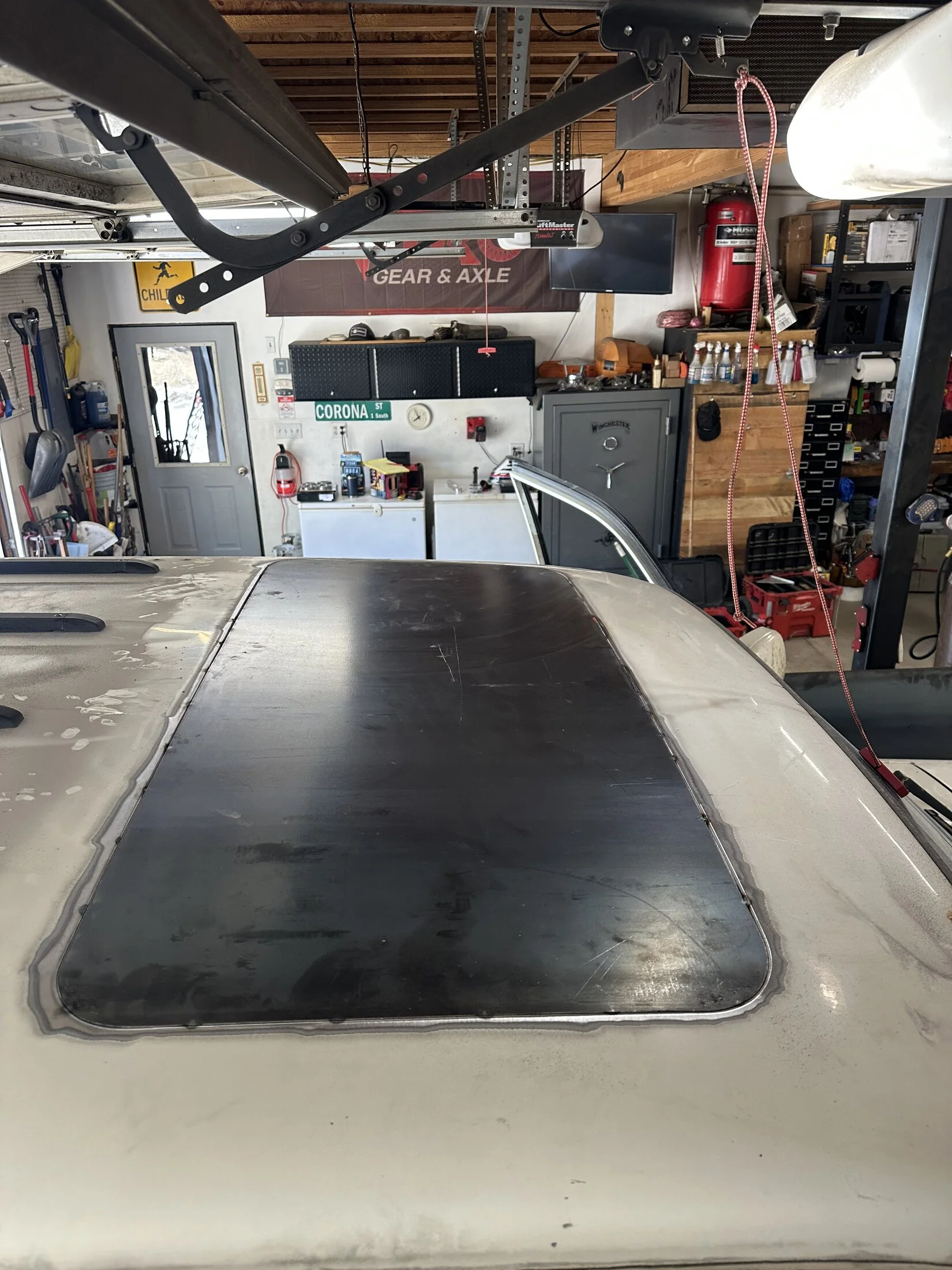

I’m going to reinstall the stock headliner until I find a non sunroof one. The patch panel stiffened up the roof a little bit so I didn’t feel the need to reinforce it more

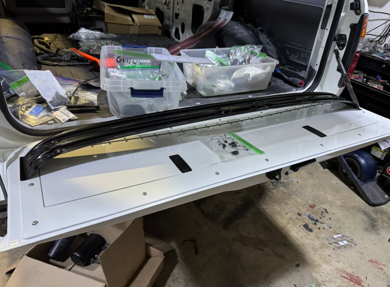

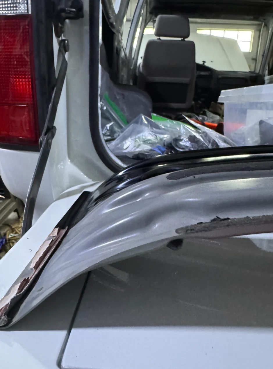

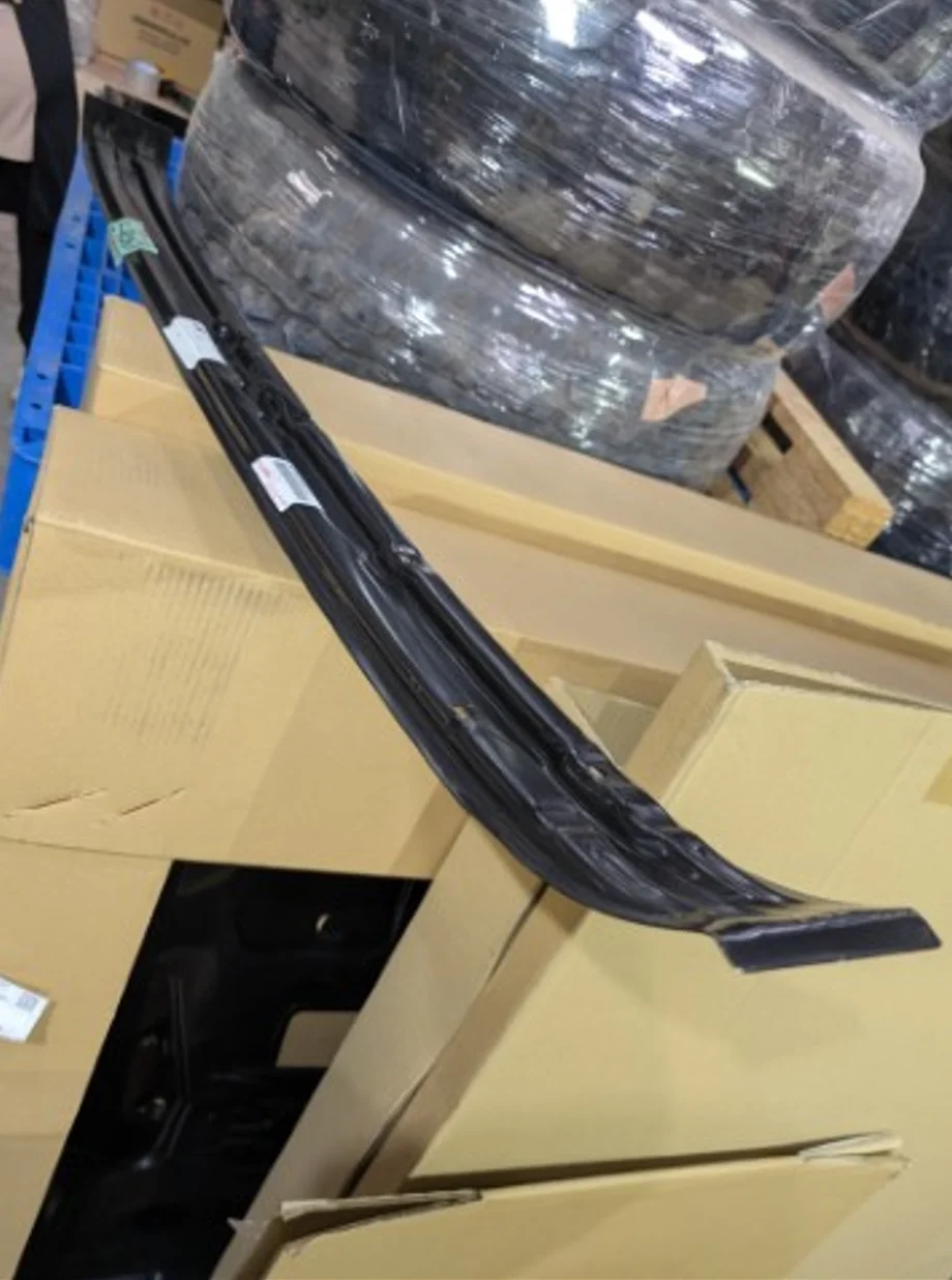

Here are some photos of the #2 bar next to a #3 / #5 bar.
The arch and width of the two bars match, however the "feet" of the #3 / #5 bar are slightly longer, making that bar ~1/2" taller overall. Because of the way you need to cut the legs in order to install the part, I don't see this being an issue at all. I would be willing to be that you could use the two interchangeably, as long as you flatten out the roof strake features.
-Rob
