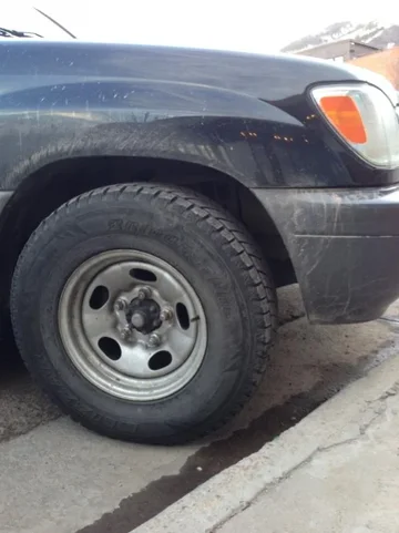

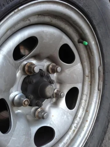

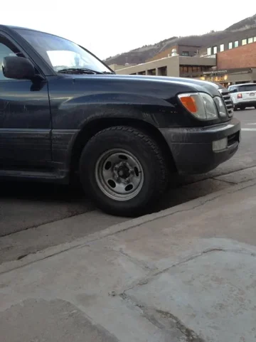

These are on a 100 here. Don't know what they are and haven't been able to find the owner to ask...
Dunno if these pics will post..... If not I'll try again ....
Good. This whole wheel delima seemed very, very complicated. I mean 5-lug or 6-lug?!? Crazy. Best just buy a whole new $80k LC and be done with it. Problem solved.
