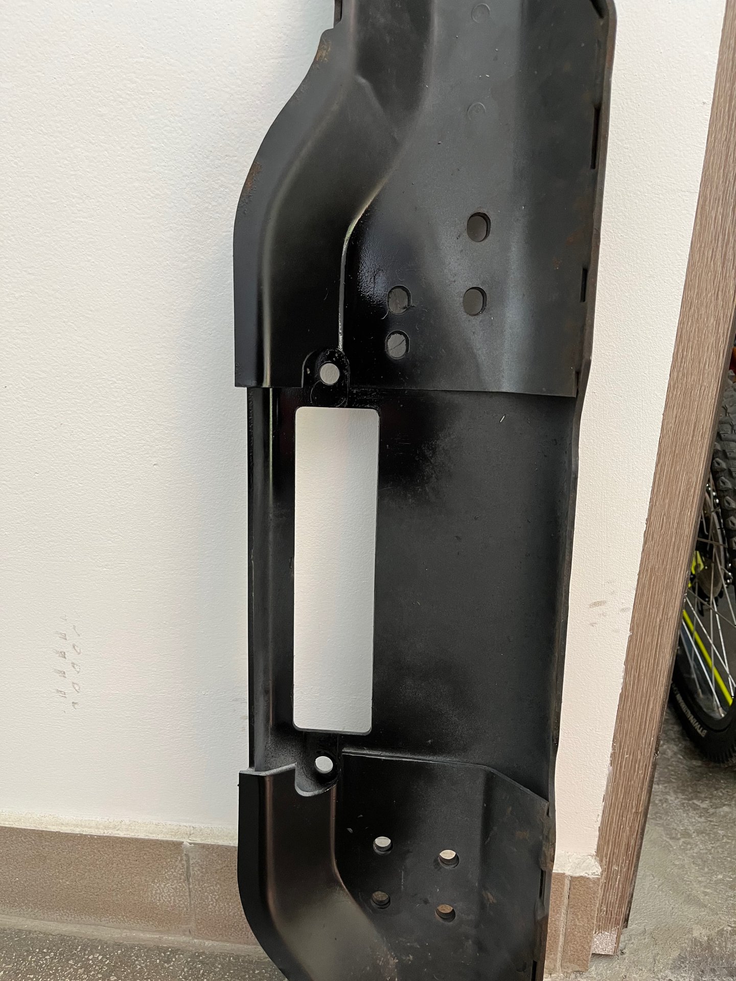

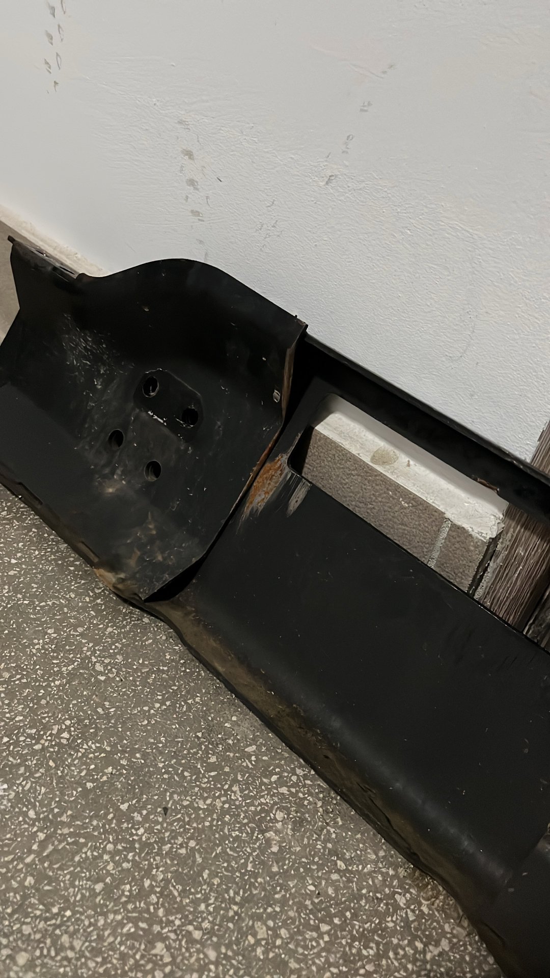

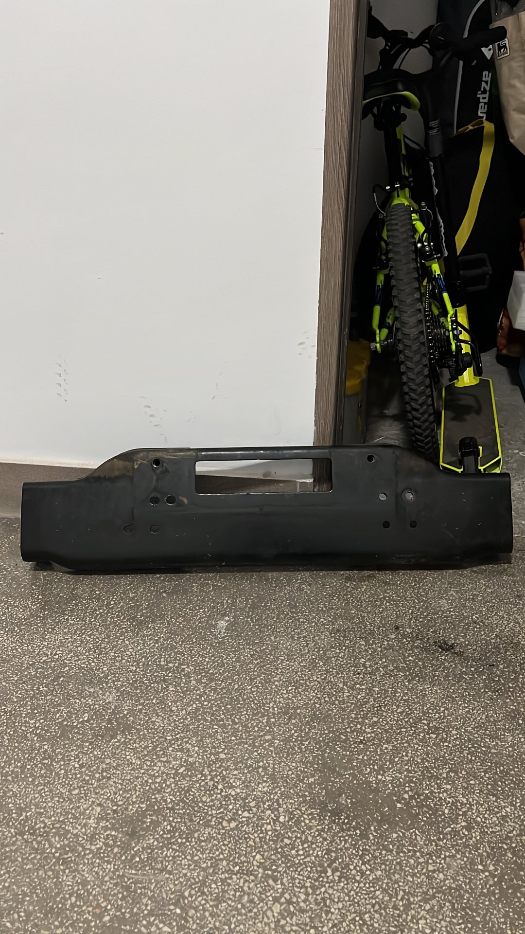

I Have no idea how Wit's end managed it, but the plate has welded reinforcements in the back.

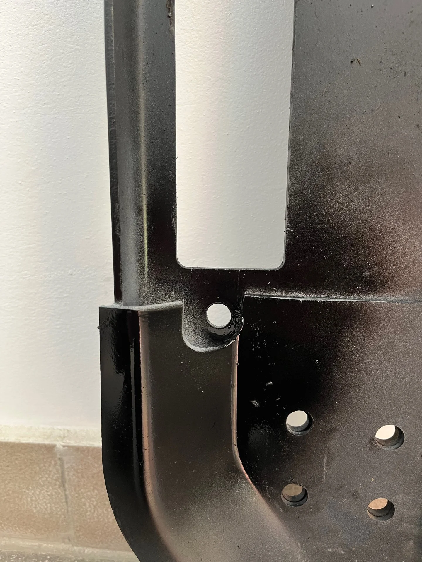

Made the conversion, the plate needs some steel machining for the fairlead holes.
Manual drilling should not be attempted, as it will most likely make uneven holes.

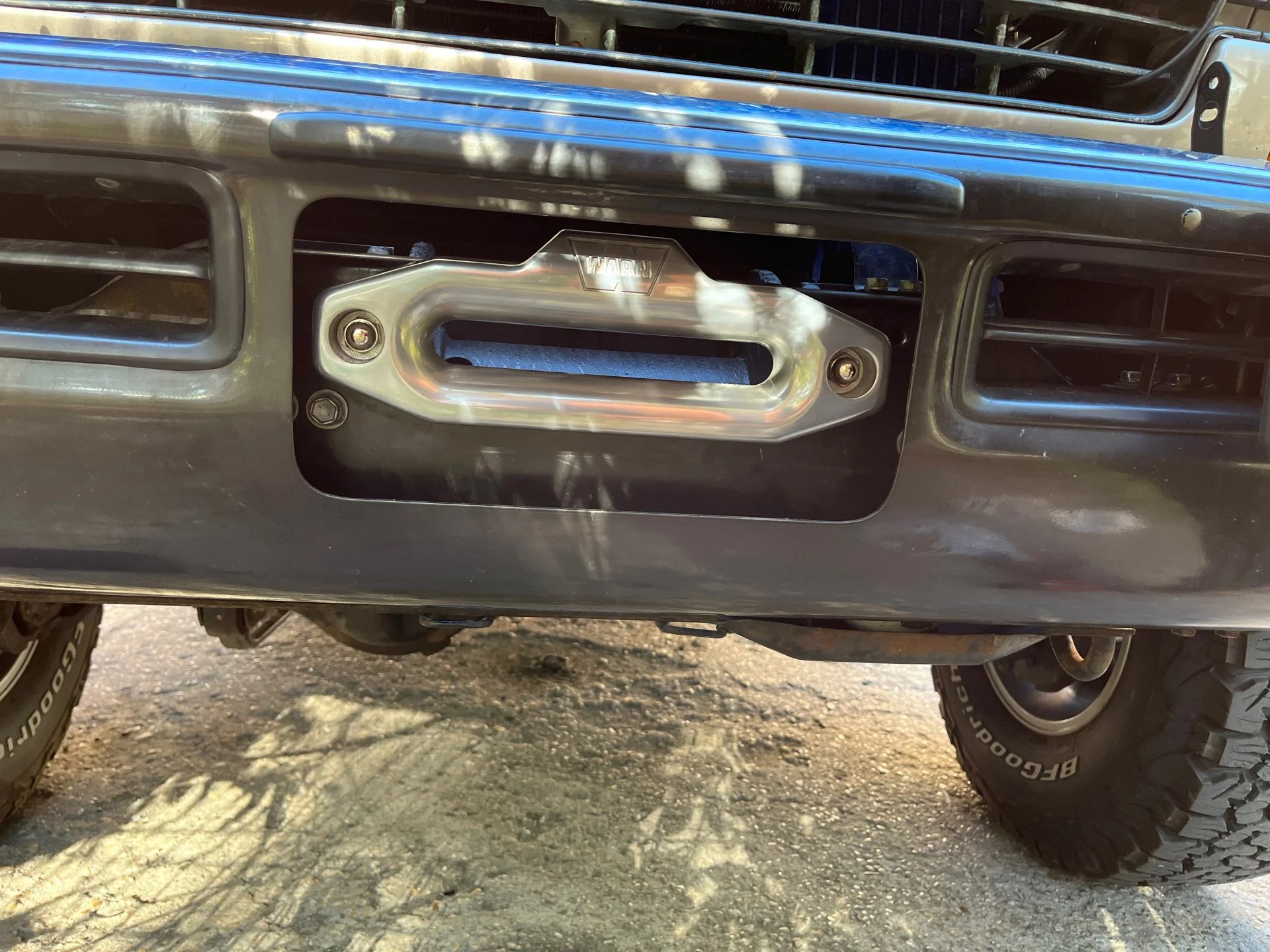

I used a Warn aluminum fairlead, it fits perfectly.
Before:
After:
