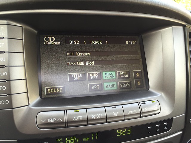

Not sure what you mean here by "actual phone capability" but it worked great with my phone. Calls, steering wheel function, even song titles came up on the factory Nav screen when playing music from phone.

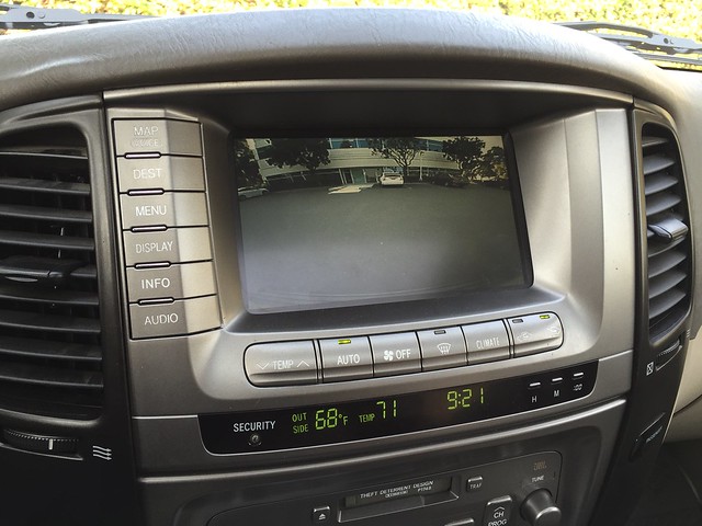

I've successfully installed both the Naviks reverse camera and the Grom IPD4 adapter.
