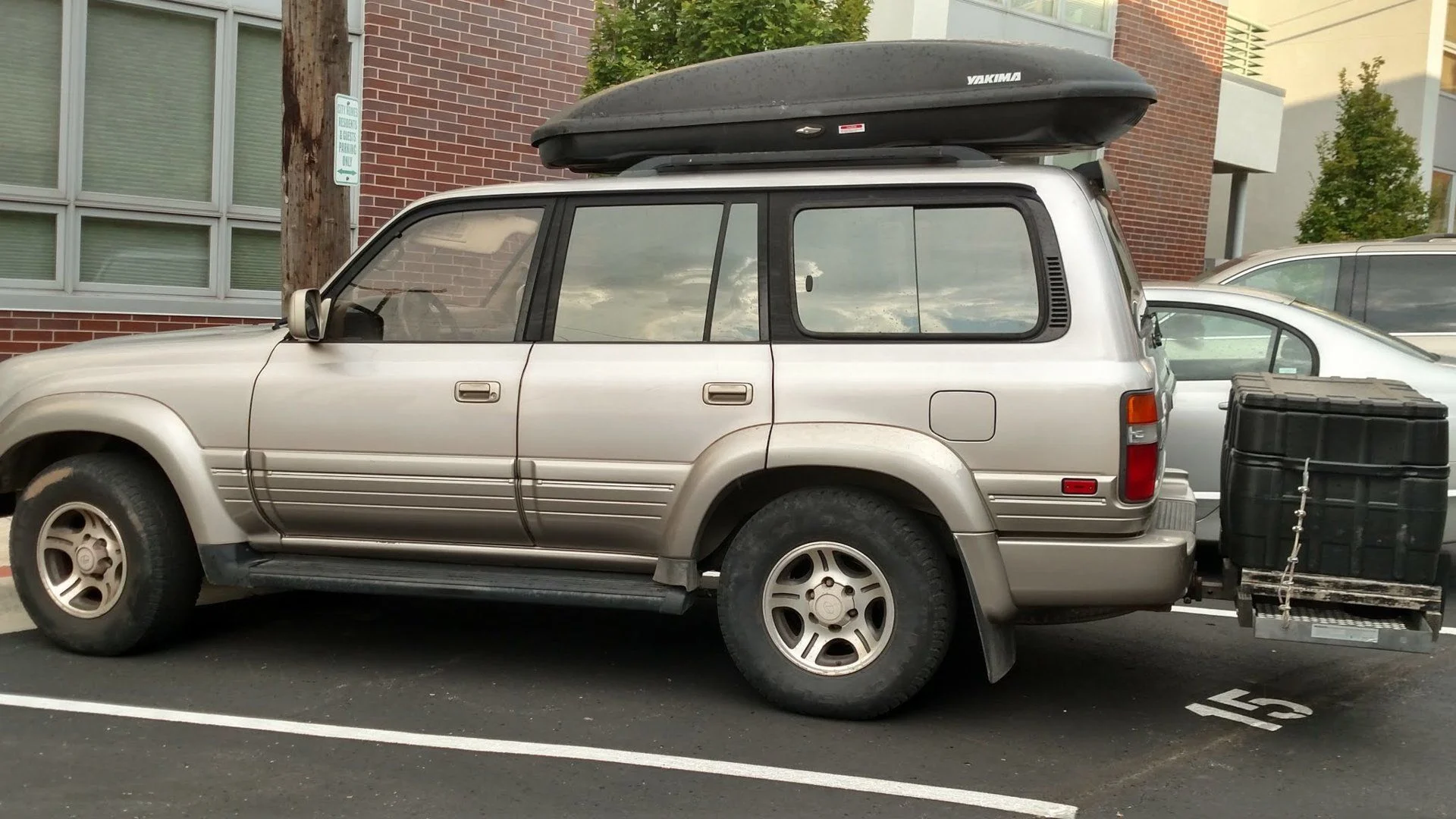

I've got a '96 LX450 with 145k and lockers. I've read that the stock LX springs are pretty soft compared to the LC springs. The rear end sags pretty bad when loaded up with friends and gear.

Not always, but even without the rear box, it still sags when a couple people are in the middle row. This picture probably doesn't show the sag as well as it could.
My rear coils have been repurposed under @kc_chevota 's rig, so unfortunately, I'm not much help on the parts side of things. If you can't find any of the Toyota specific coils locally, you may be able to fix your issue by doing airbags as @cjmoon suggested, or look into the "Old Man Emu" (OME) (or Dobinson) replacement height suspension. You'll gain .5"-1" in lift height, FYI, but it might provide a "sportier" (read: firmer) ride that won't sag as much when loaded down. Lots of good and trustworthy vendors that can help with product placement should you go that route.
