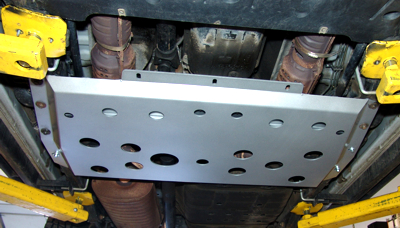

Mine looks like this and all of the holes are circle.
