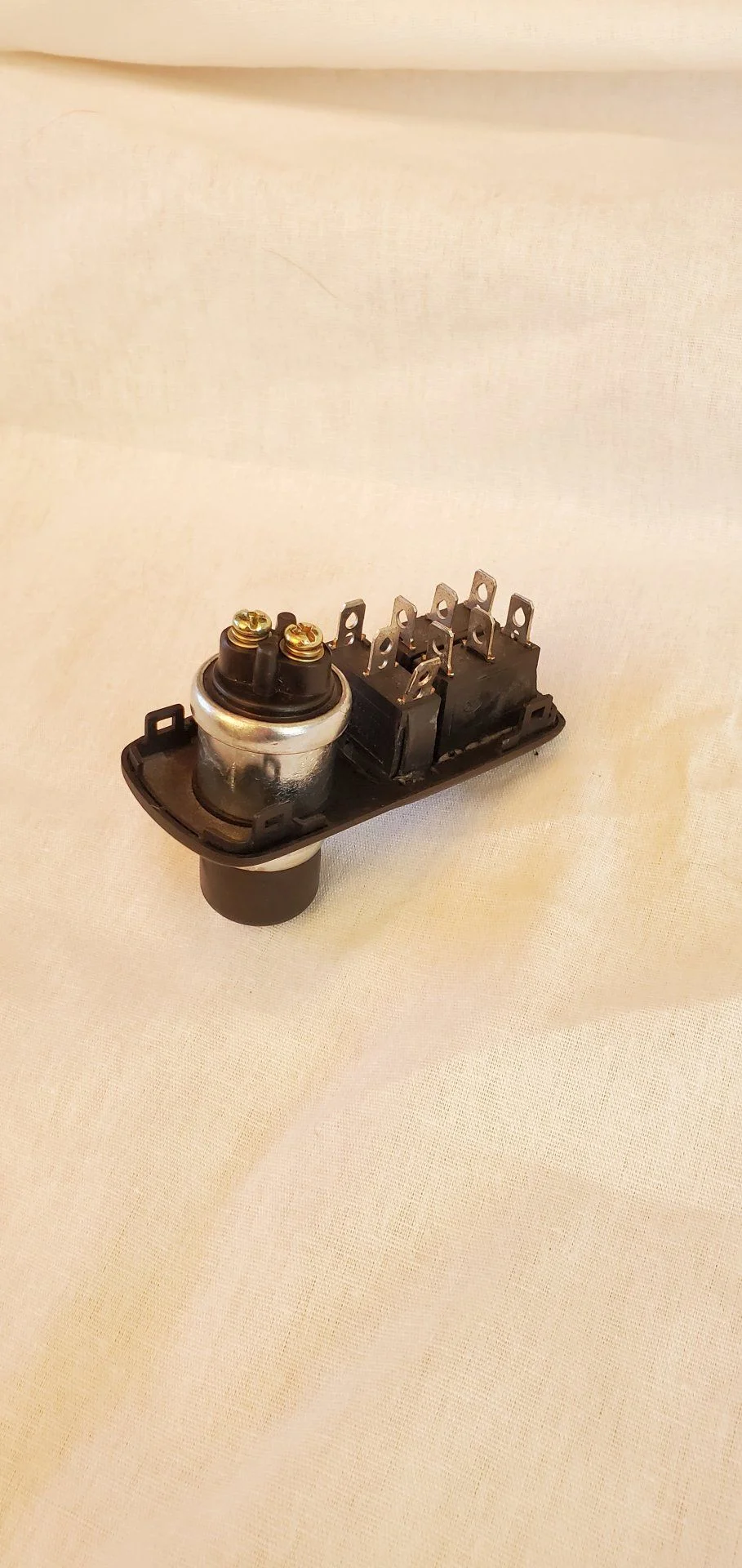

MIDIYA 12V 20A Horn Button Push Starter Switch Weatherproof Rubber Cover and 2 Terminals for Car Boat Track Switch Push Button Horn Engine Start Starter, Ignition Starter - Amazon Canada - https://www.amazon.ca/dp/B07F6FKTVK?ref=ppx_pop_mob_ap_share
( I ended up buying a lower amperage version of the switch at my local Harbor Freight and it was a lot easier to squeeze down and press)
4oz. Original Gorilla Glue, Super Glue - Amazon Canada - https://www.amazon.ca/dp/B07W8LJBWP/ref=cm_sw_r_cp_apap_ARt5NuKeua5wK
Gorilla All Purpose Epoxy Putty Stick, Adhesive, Sealer, Waterproof, Non-Rusting, Hand-Mixable, 10 Min. Set Time, 2 ounce Tube, Gray, (Pack of 1), 4261702: Amazon.ca: Tools & Home Improvement - https://www.amazon.ca/dp/B08XWNJG5Z/ref=cm_sw_r_cp_apa_i_0SRR5XR8RVWPA3WX51B6

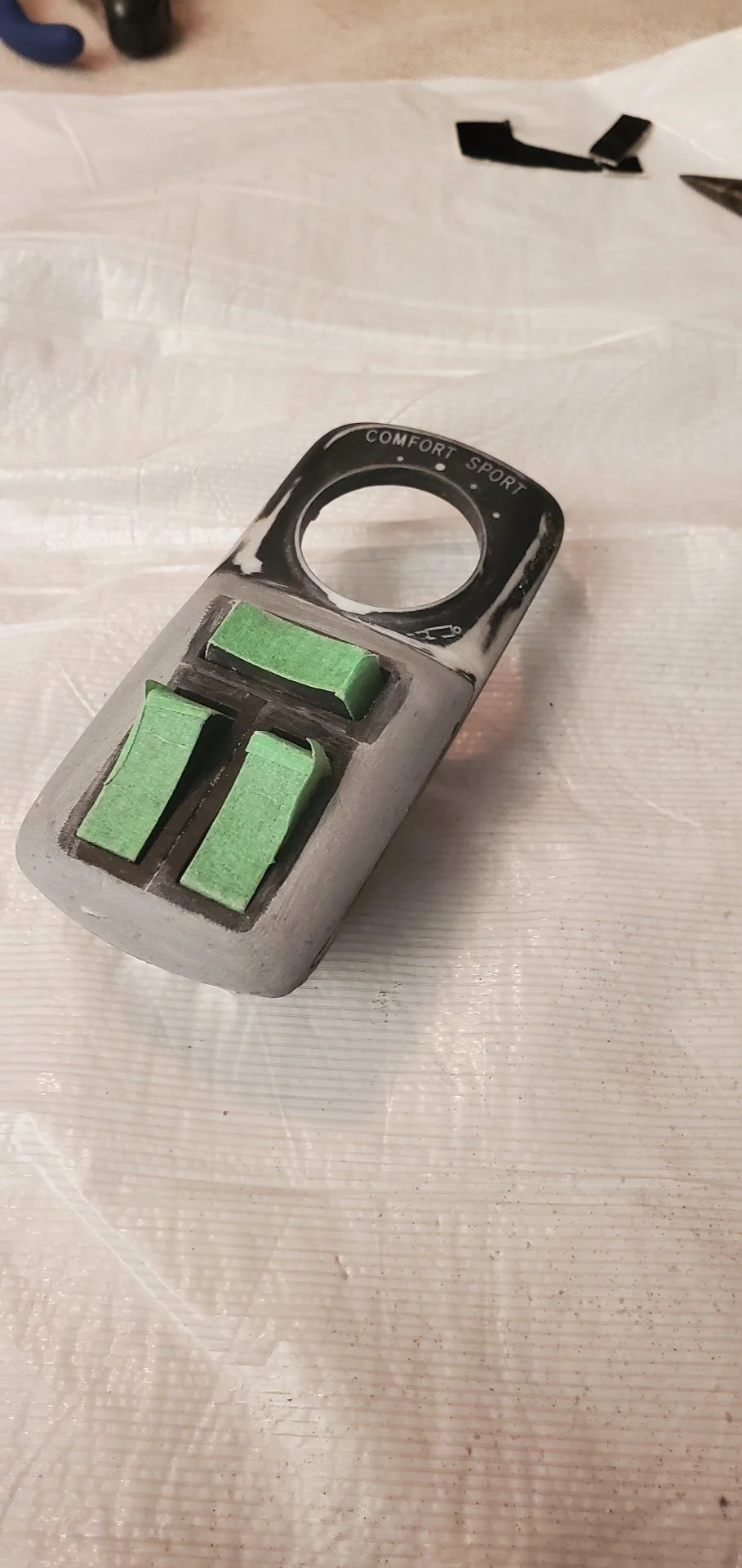

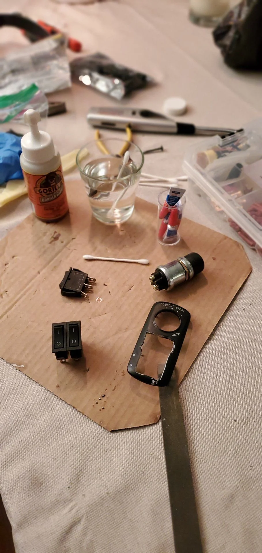

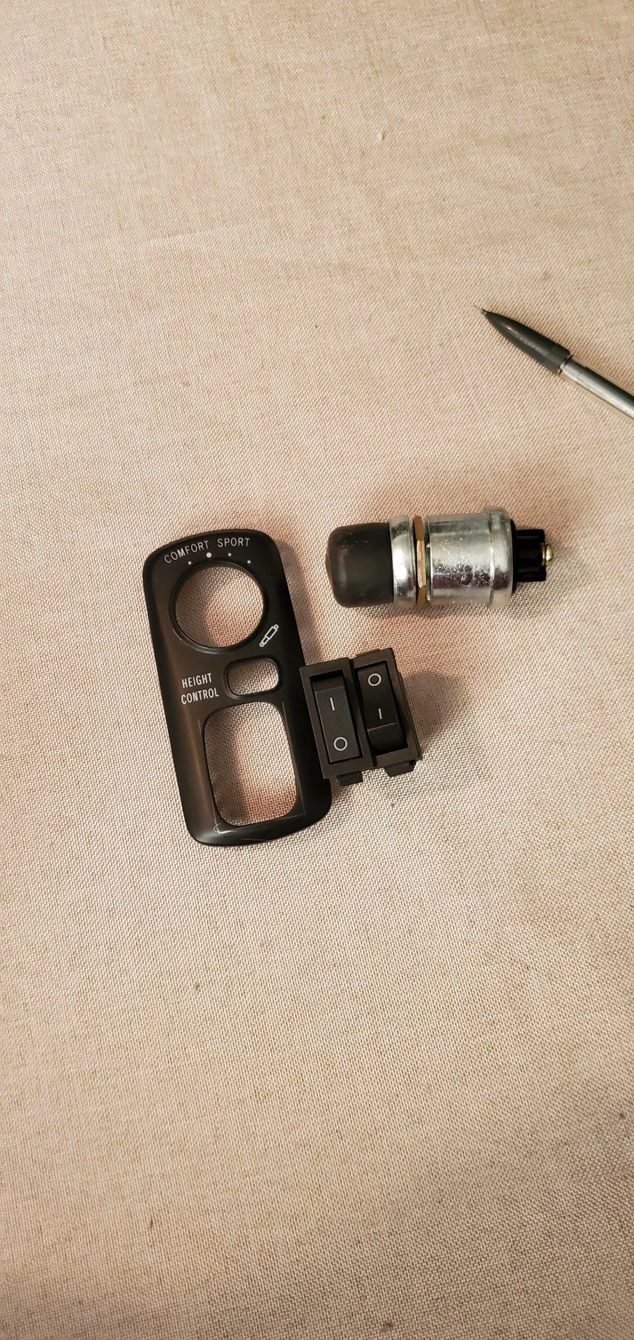

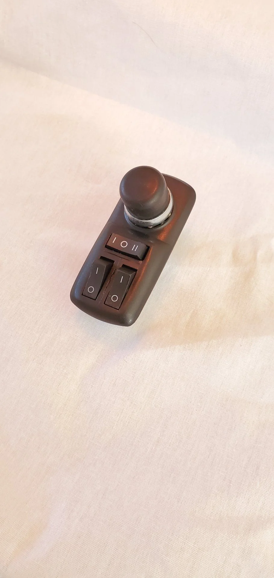

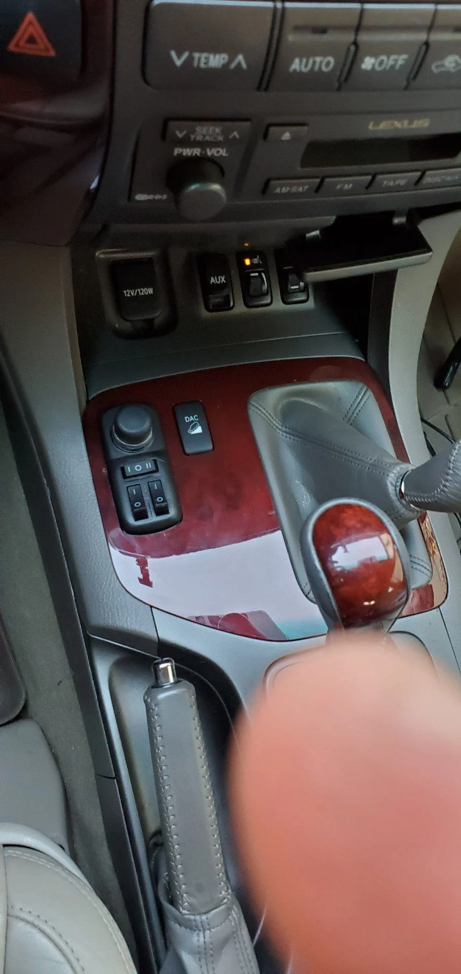

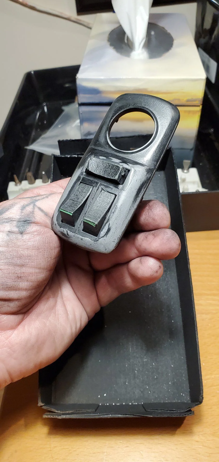

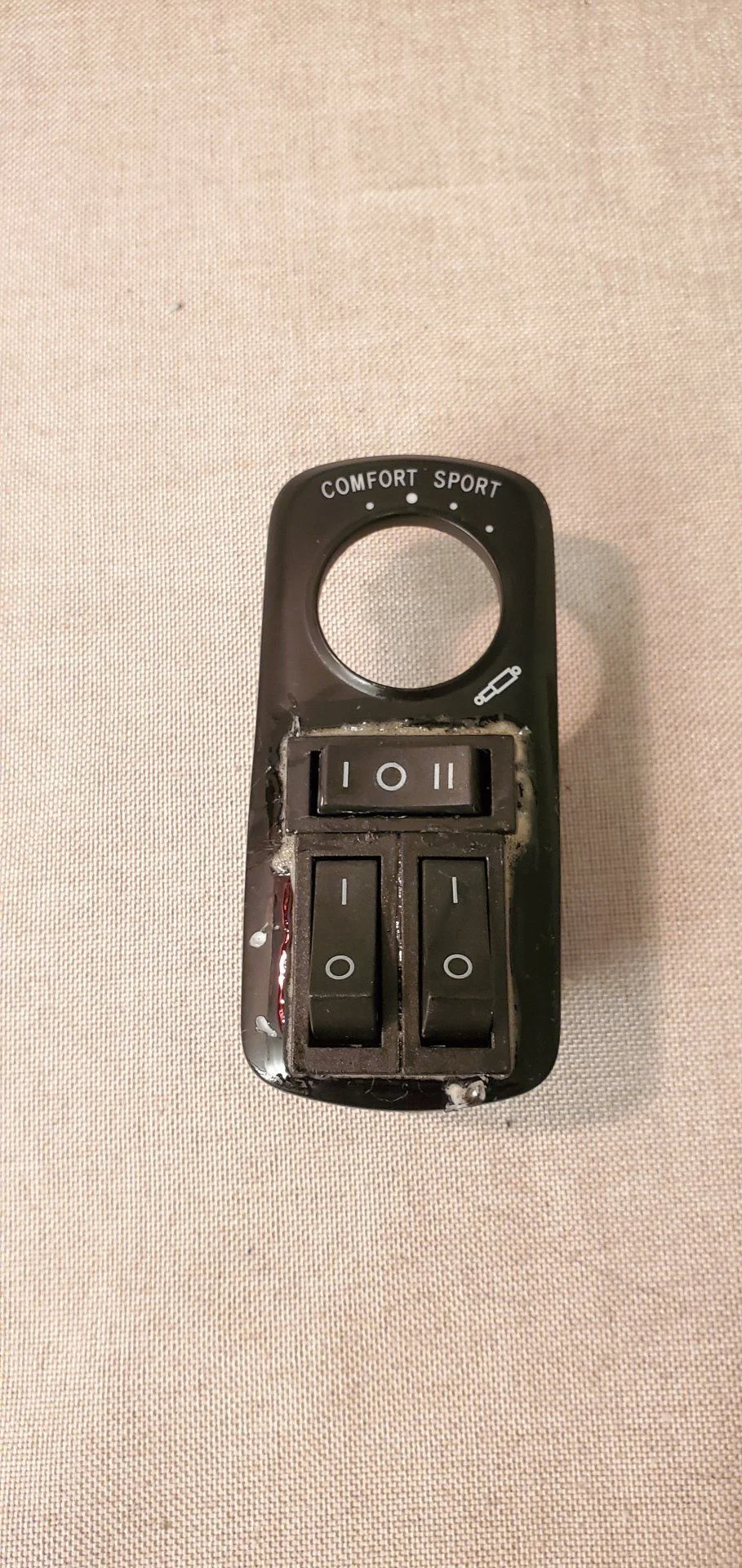

To cut out the hole order the switches first, measure then cut plastic w red hot blade from candle. Sandpaper.. Glue. Patience. Epoxy, sand. Epoxy, sand. Patience. Black primer. Black epoxy gloss black. Use painters tape to cover switches.
I hope this helps anyone w a lift and no longer using their switches looking to make a stock switch plate. Any questions ask.
