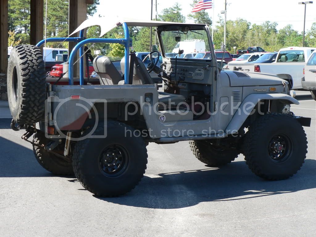

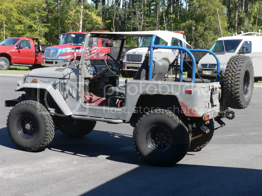

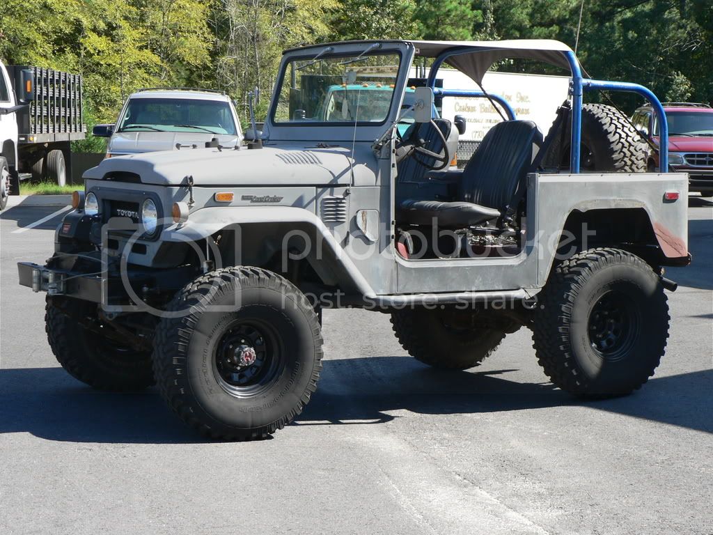

I have a set of Alcan springs on my 1974 FJ40. I LOVE them.
Here are a few pics of what my cruiser look like befor the rebuild. I have a set of custom long springs (5" lift kit) and a front shackle reversal. I am running 35" BFG Mud T/A's
pics:
