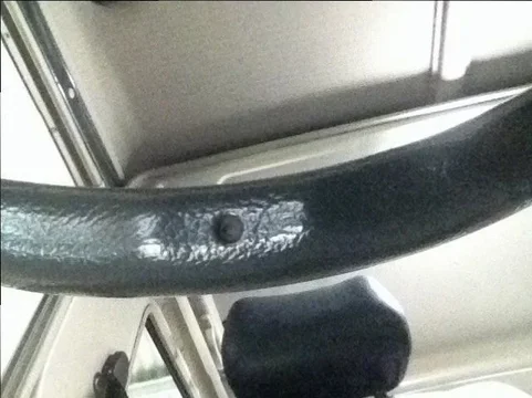

Hello,
Depending on the wheel model you have, there should be 2 -3 ports, probably used to inject the plastic in the mold, and roughly 1 mm in diameter, on the back, i. e., the part facing the dash. You might be able to squeeze glue/resin/you name it through them.
Hope this helps.
Juan
I have same problem with upper portion of steering wheel and on inspection I found those 3 holes, ??
On my 60 series I had the same issue. It drove me nuts. I drilled some holes on the back side and injected gorilla glue. It worked great. Anything that was poking out was easily removed because I wrapped the wheel with masking tape before drilling the holes.
If I was to do it again I might mix the glue with water so that it wasn't so thick.. Water also helps the glue to set.
