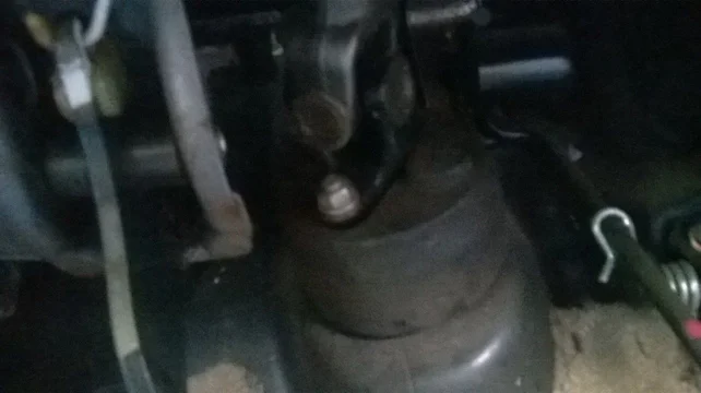

I played with the ujoint on the center shaft right before the firewall as in the picture attached and I move the steering wheel slightly back and forth and the joint does wiggle more than I think it should plus underneath the rubber dust cap going into the firewall it wiggles or sounds loose under there.
You can buy the center shaft from Toyota that includes what you would need to replace that area. Does this sound like what could be my issues... since last year getting the truck and adding bigger wheels it has been getting a little worse as the months go on though I didn't notice it last year.

I personally would just replace the intermediate shaft. Welding or modifying it seems a little sketchy if it's already failed.

link to the TTORA thread? Apart of the first rack swap out/in I, mainly because of corrosion, replaced the entire steering shaft assembly from where it attaches to the rack to the steering column and it solved the looseness/rattle you describe.

I have a youtube video link. Engine off, No key in, Park
I am guessing that much movement is not normal with engine off and in park
Several area's for knocking noise there. Make sure spline steering coupler is tight on the pinch bolt. Underhood Column Ujoint....grab both ends of the shaft, pull, rock it. Steering rack could have loose pinion to rack clearance, replace it or brave reshim the pinion. Steering column inner plastic sleeve ujoint? Rubber bushing in the firewall can also amplify steering inputs/vagueness. I see you mentioned new rack bushings, I just ordered some. Best to let the suspension hang with the heavy wheels on it and grab at 3 and 9 while an assistant looks for steering drama, some mechanics think steering/suspension inspections happen on a 4 bolt lift with the weight on the vehicle, some only being paid for a wheel alignment take it a step lazier and never even slide the jack from behind their head to in front of their head and unload the chassis. That's pathetic to send someone down the road with safety issues because your lazy and not greedy, greedy are most alignment shops....
