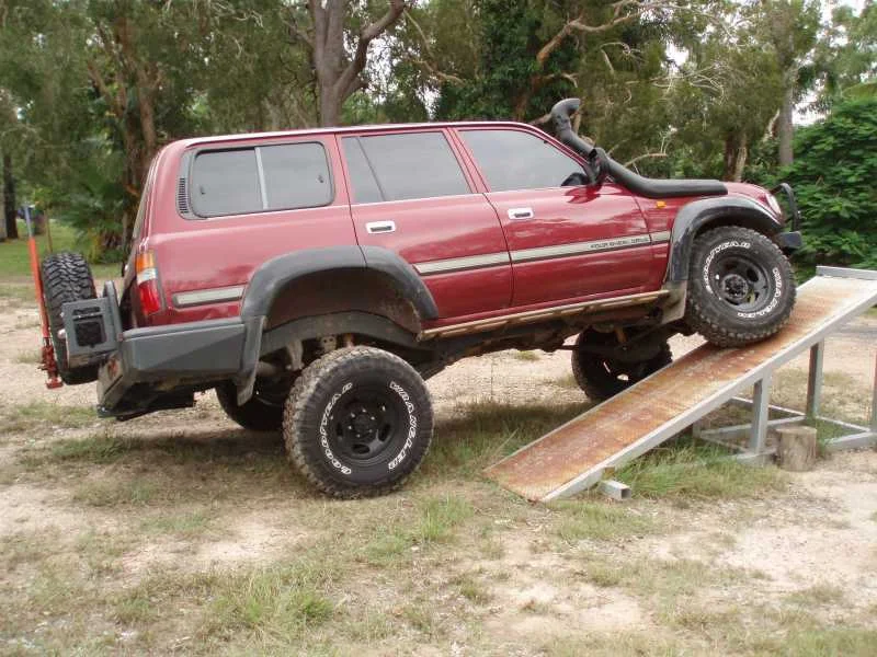

Here's what they look like powdercoated black (compulsory:flipoff2:) and fitted with 285 MT/Rs.
:cheers:Mick

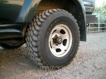

Here are some aftermarket 16x8's with .25" less backspacing than the factory steelies. US Wheel Modular 94's, $70 a piece from summitracing.com.
Edit: Resized pic
