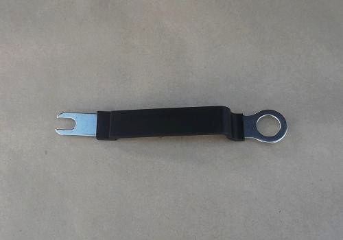

Tom,
The part that is broken is not the section with a wire, but the next section of busbar that bolts directly to the glow plug busbar. It appears that this piece is one single piece of copper with no sensor, so can I replace it with heavy gauge wire and not mess up the super glow system? Here is a pic of the actual part removed and my replacement fabbed:
Were there no small wires going to the broken piece? If not then you will be fine with your new part :)
That glow plug is all used up! There is an insulating piece missing too that might have been the reason it all burnt out in the first place. You will need a new one of those.
Good to hear. Yeah, this part has no wires coming from it.
I bet you are right...maybe the failed glow plug terminal caused this issue over time.

Tom,
The part that is broken is not the section with a wire, but the next section of busbar that bolts directly to the glow plug busbar. It appears that this piece is one single piece of copper with no sensor, so can I replace it with heavy gauge wire and not mess up the super glow system? Here is a pic of the actual part removed and my replacement fabbed:.............

Amazingly, the glow plugs that I ordered from Australia on Monday, showed up today.
I installed them as well as my new wire link, and the engine fired up faster than ever. Thank you guys for all the help!
