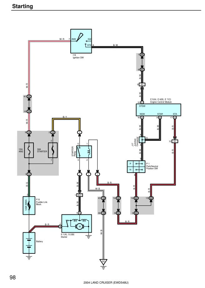

I have this from the 2004 FSM, I would think it would be pretty much the same...except the relay pinouts would be like below...
I used the following test procedure on the relays...

Going by the top diagram if you make a small fly lead and link between pins 3 and 5 it should activate the starter as this bypasses the relay, you will just need to disconnect it to stop the starter from carrying on. The lower diagrams you link pins 1 and 2.
You can put a test light across pins 3 and 4(lower diagrams)and it should light up as bright as if you put it across the battery when cranking this will test the supply to the coil in the relay.
Test with a test light for a permanent supply to either pins 1 or 2 it is pin 5 in your upper diagram this is just like a switch so one side will have a permanent supply the other side just goes to the starter solenoid. One side of test light on battery Negative the other will probe the connections.

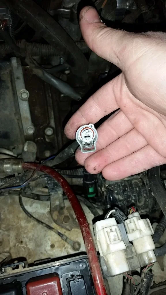

JUst FYI, don't have a test light currently...need to add that to my arsenal...but I believe I have tracked down the problem with your help. Ran my additional tests...relay is a-okay. Voltage drop of .02. Found which pin socket in fuse box had permanent power and thus other side should be the one going to starter... Applied power to that pin socket with no result. So I believe I somehow managed to break that power wire while replacing the starter. Final test, I inserted my jumper wire into that pin socket and replaced relay...and the truck turned over with the key...
So yay, the problem is the wire from the relay in the fuse box to the starter...and boo that mean I have to once again dissassemble down to the starter in order to find where the break is, as I'm sure it's where I was manipulating the wires around the starter... Only good news, is I can do that in under an hour now...

On the top diagram there does look like there is a connector or something like that inline on that cable it's labeled ed1, there is no key provided to explain what it is, just glad it's wasn't on the coil side, that's where the fun would of began for you.
Yep, you and I are on the same wavelength...I just got inside from cleaning up. It's alive!!! In the FSM there is a page to reference that connector location. And I had enough sense to at least check that carefully before I tore the thing down again. Started looking around and found a grey connector hanging out of sight under the fuel filter. It plugs in right next to the fuse box and viola...a lot of time and work spend for a single unplugged connector. I don't know when or how it got yanked out, but something caught it and it did. And it couldn't have been any other plug...something unrelated to the starter...no, it had to be only thing that could be unplugged to make me thing the one thing on the truck that I had touched was in some way messed up. Oh well, she's starting and running again now.
