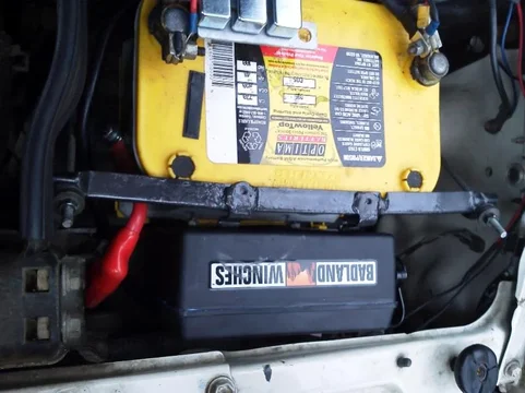

Next came the wiring. I wanted a divorced solenoid box located higher up in the engine bay, away from all but the deepest water during crossings. We decided to mount the box in the little space between the battery and the headlight. We looked at the cable lengths coming from the solenoid box and determined that the black and yellow (its black but has a yellow insulating boot on it) cables needed to be lengthened to 6 ft in length. A quick trip to the auto parts store for two cables and 4 new ends got us what we needed. The rewire was fairly straight forward (remains to be seen if I did it correctly lol) and we started work on the mounting bracket for its new home in front of the battery.
We took the existing bracket that comes mounted to the back of the solenoid box and hammered it flat for easier reshaping. We decided to weld it to the battery tie down bar so the box would be secure but easily removable if a headlight needed to be changed. We then bent to it fit the tie down bar and made our welds. A note here: both pieces of metal are pretty questionable metallurgy, so should you go this route- burn it in slow and cold. We blew a little hole in the tie down bar getting the heat right.
Once the boogers were ground off and the bracket was painted, the bracket was reinstalled on the back of the box. A little RTV was added to the lid to seal up the box nicely, and the box was mounted in its new home under the hood.
We were extremely happy with how sanitary the install looks, and the box fits in there next to the Optima battery perfectly.

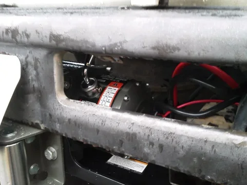

I removed the vent insert in the bumper for access to the control lever. Glad I reclocked the lever- there's no way it would have had enough clearance.
Here is the divorced solenoid box mounted in the battery tray.
