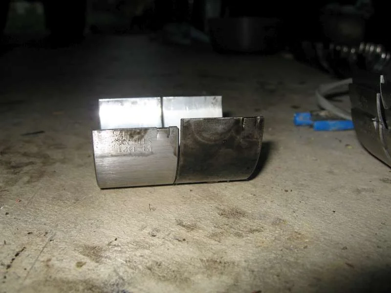

and here are the pics of the bearings
the 6 others look like the bottom pic all worn looking

that one that is all black got burned up from lack of lubrication.also look at the backside, totally spun around, lack of lubrication there. ive seen that before, the bearing was practically welded to the rod. you might want to get that rod checked out by a machine shop, it could be damaged from the overheating. maybe they were the wrong bearings, and excessive crush caused them to deform like that, and there was not enough clearance resulting in lubrication not reaching it properly. thats a shame, what a way to kill an engine, after only 2000km.

the rod is fine nothing stuck to the bearing matting surface. The crank is good no out of round or damage, the reason for the bearing bieng stuck was the metal rolled over the sides and got pushed into the oil cavitie/passage in the rod.

but i have a feeling the rod bearings i got were smaller than regular or the wrong ones they dont really measure up to the old ones there off by a little which makes me think they were the wrong ones

Did it look anything like this? (correct bearing on the right)
attachment.php
SOR kept insisting they sent me the right part until I research it on my own and proved via the EPC that their listings were wrong - they sent me B/2B bearings:

armurer man thas what i couldn't figure out they fit but too well there too small and the guy behind the counter insisted they were correct thanks so much man for the pics i wasnt sure cuz the bearings are manged and worn but now i sure they were the wrong ones/size
what are the numbers on the smaller bearing? they look to be the same as mine
