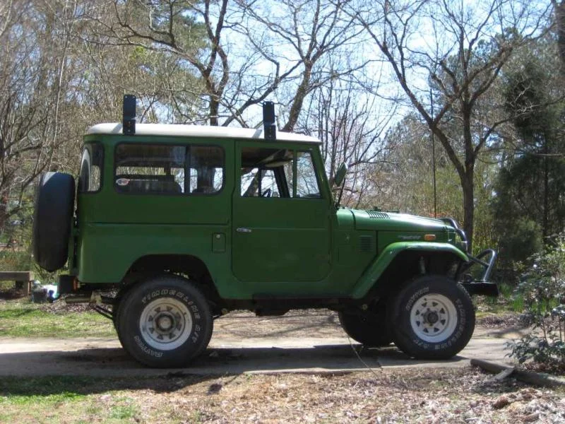

I have a BJ-40 with a 2B and went with the 2.5 lift. I run 31's and love the setup. I wanted a 4 inch lift but decided to try the 2.5 and if I wasn't happy I was going to just get longer shackles. My cruiser is only driven off-road and wanted a lower center of gravity because I would have to put her back on all 4 wheels by myself. As far as it being a more comfortable ride, my fj-40 with a 4 inch lift is way more comfortable(they have different body mounts). As for transmission or engine wear with bigger tires, I don't think this is an issue at all. So if I was going to drive it around town and not really wheel it, I would like the look of a 4 inch lift with 33's. Here is a pic of the 2.5 lift with 31's. Doesn't look the best but it very functional for what I use it for. Two slightly different angles for you to see.
That looks pretty good. like I said I don't want to over-do this and I had the same shackle idea as well. If you saw the truck in person you'd understand why I'm thinking 2.5". Just seems like the right height for it. Plus I have an M101 with no lift or SOA done so will line up a little better

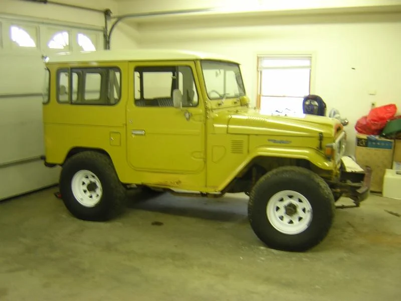

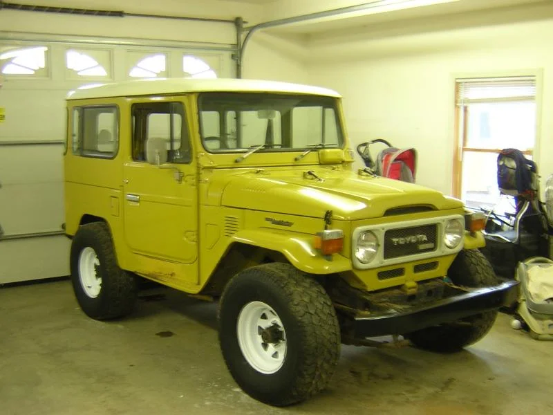

pics of the BJ. the left rear spring is flat....and I mean FLAT. This shot is the good side. Figgering it'll be 4" above what is here now with just a 2.5" lift. Sorta happy with that but now the 4" people are gaining interest.
That 4" with the 31's doesn't look goofy at all.....would leave a bigger tire option but does open up vibration issues with the short driveshaft on the 5 speed in it
These pics are 31x12x15 or something to that effect. The swampers I have are 31x 9.5x15 I think. Maybe 10.5 but really not that wide. The tires in the pics are stuffed in so you can tell the sagging is ridiculous.
