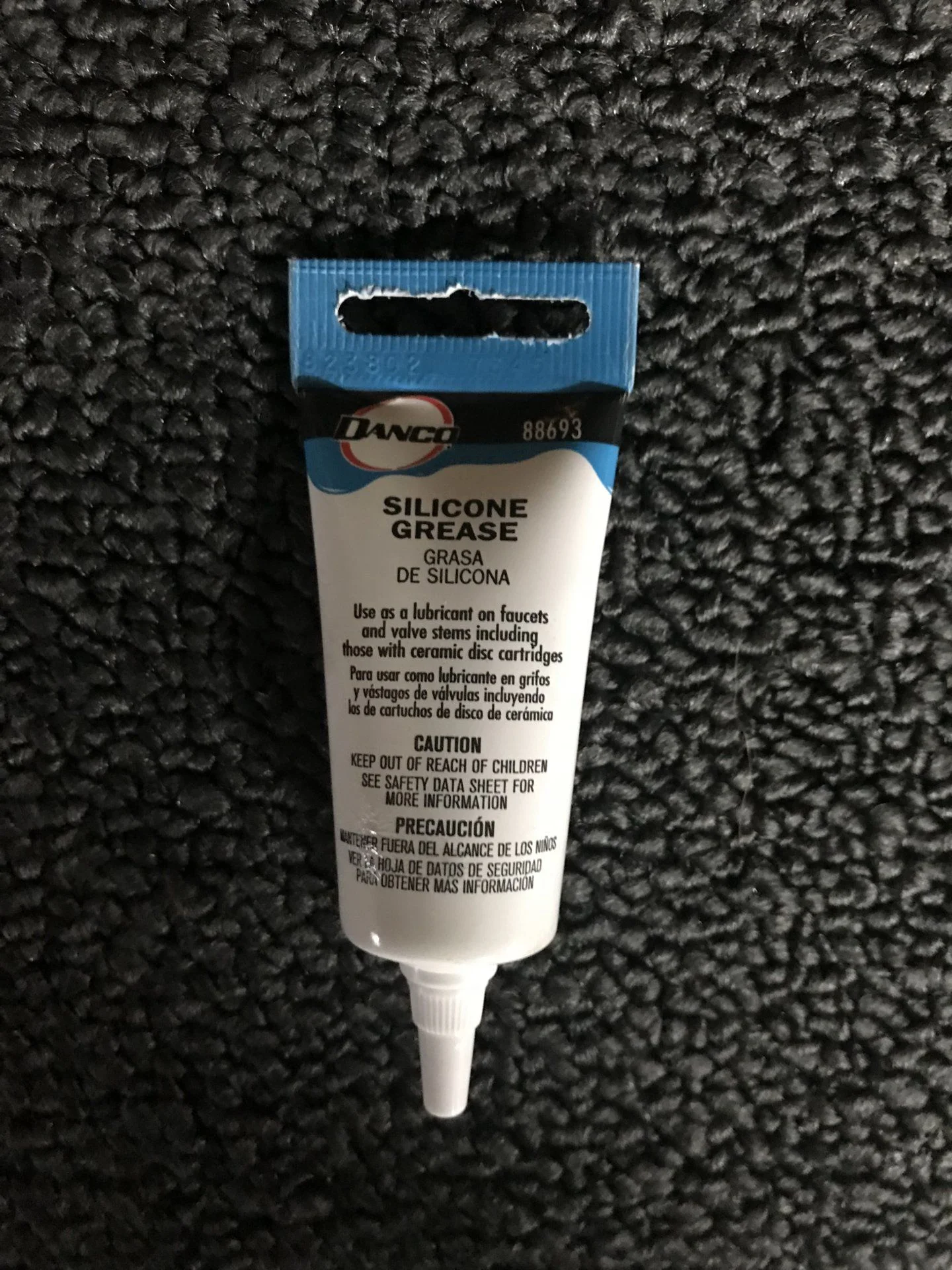

I had a clicking/fluttering noise coming from behind my instrument cluster. In my FJ62
Pulled the speedo cable and replaced it with an OEM part, noise was still there.
Spoke to a buddy who is a Toyota Master Diagnostic Tech and he recommended using SILICONE GREASE on the speedometer itself. I put a descent sized blob of the grease on my thumb and jammed it into the back of the speedo where the speedo cable enters the speedo assembly.
Noise gone, quiet as a mouse.
This grease can be found in the plumbing section of any hardware/home improvement center.
