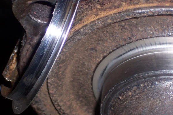

I had a leaking rear hub on my full floating axle- there is one seal in the hub that seals the axle, and a larger one on the outside of the hub that fits into a seal that bolts to the brake housing.
Both of mine were shot, but I only needed one to keep grease in. The inner surface on the spindle I replaced with a speedy sleeve. Worked perfect.
The old sleeve is on the left, the new one on the axle. I don't recall the measurments.

It seems on your truck where the seal rides the surface is worn out, which is what happened to me. The seal in the back of your hub no longer makes good contact on the surface, the seal surface eats the seal, and the seal leaks.
(The old seal surface is just sitting there on the left side of the photo as a reference.)
I don't remember the size of the speedy sleeve, but I got it at Napa. It wider than the original seal surface, so once it was installed I cut it down with some tin snips and filed it. It worked great.
And sure, the axle was rusty and pitted- that meant that the axle just held more grease. ;-) The speedy sleeve was very snug against the axle, with no play.
