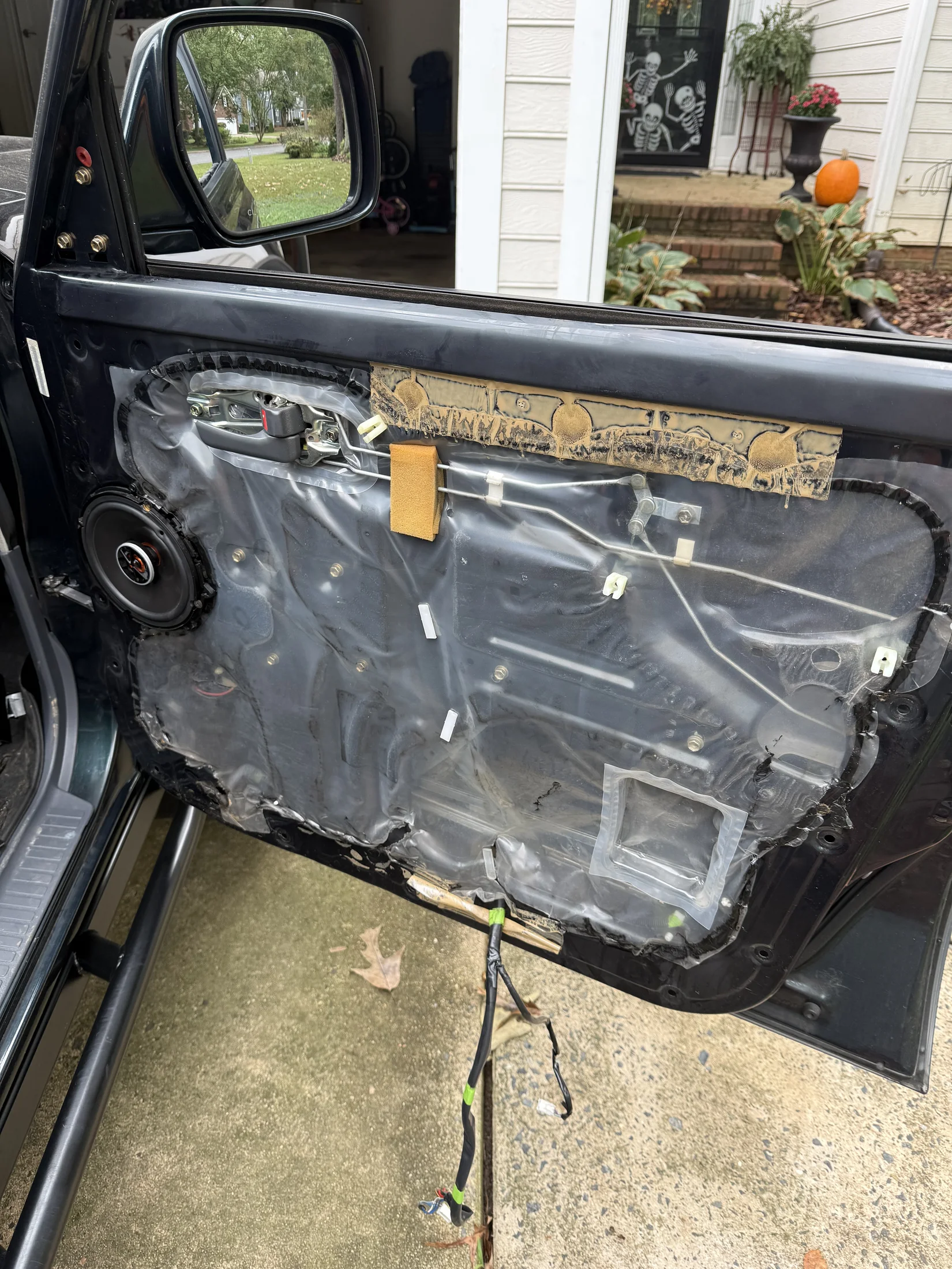

Front passenger speaker is crackling when engine is running. Anyone have ideas or experience with this issue?

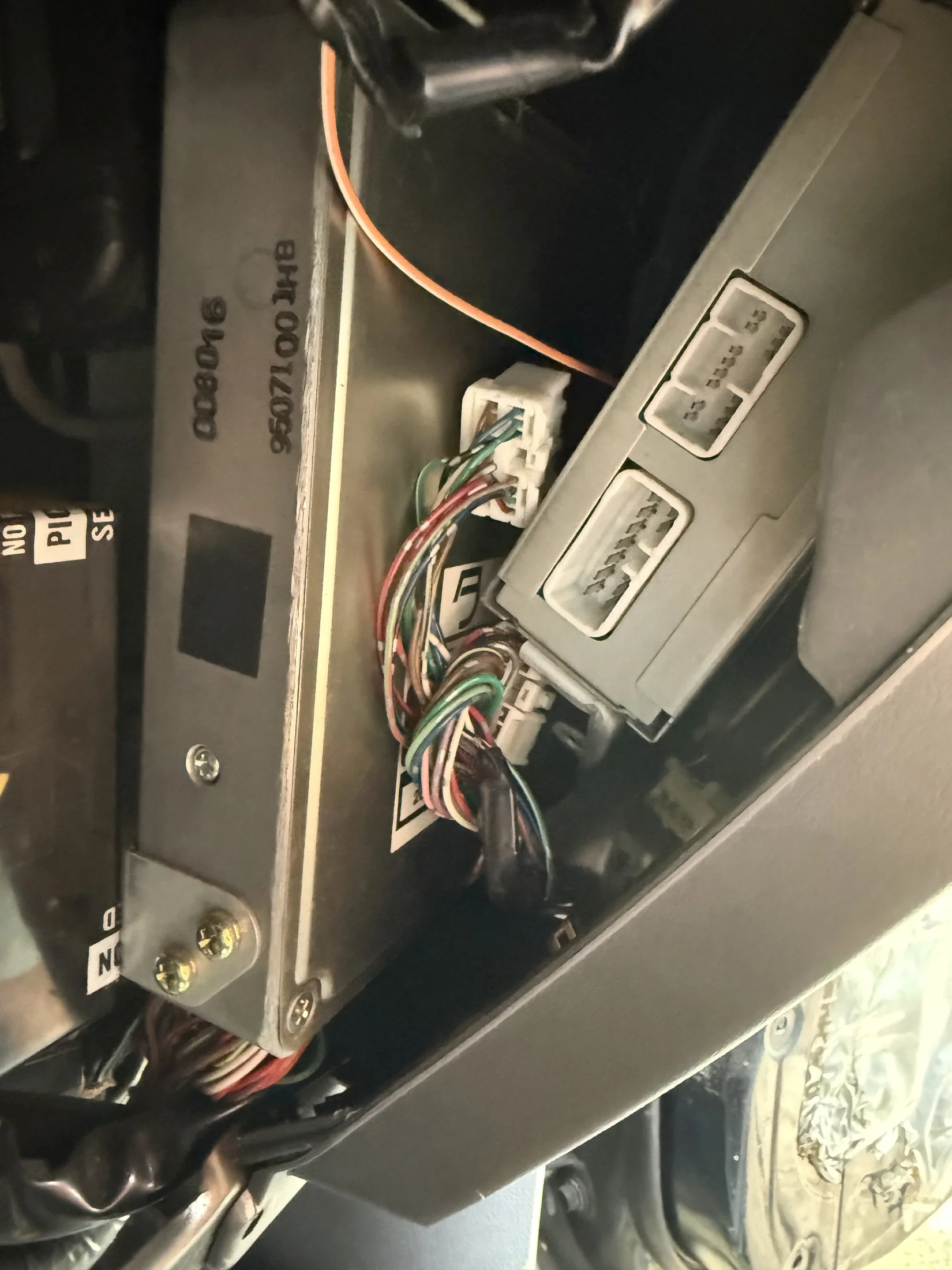

Speaker sounds blown but when stereo is on without engine running it sounds fine at all volume levels. When installing this head unit I had to hard wire everything (per crutchfield wiring diagram) because a previous owner had butchered the factory harness. I’m not sure if the factory amp is bypassed or not. Everything sounded great for over a year until last week.
Fixed. Tore apart the door to find a loose speaker wire and also disconnected the amp.
