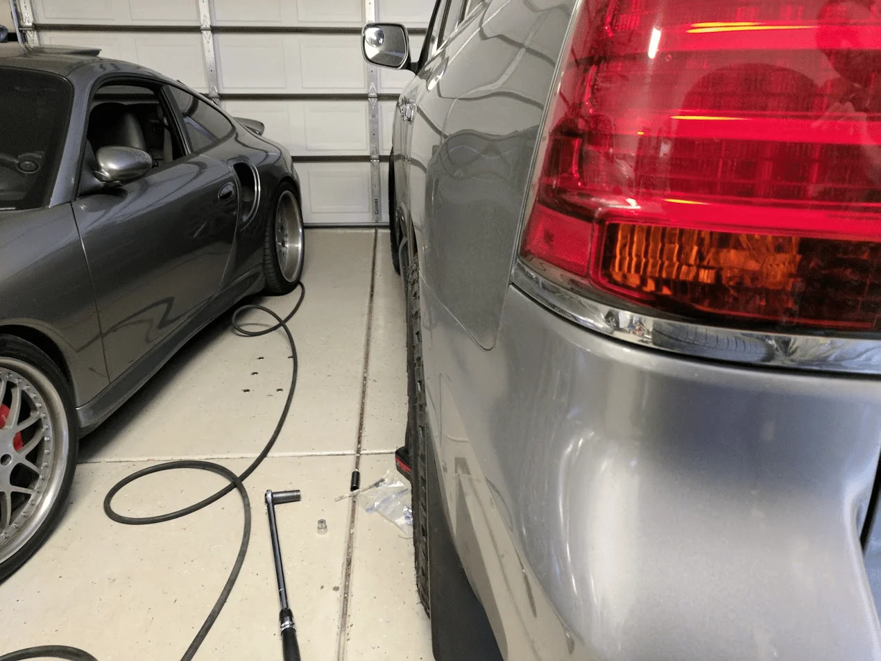

I run a ~35mm offset with my stock 20x8.5 +60mm wheels, 1" spacers, and 33.2" x 12.3" tires. I can feel a bit of pull and scrub, especially when fully laden and towing, with pedal to the metal climbing 7%+ grades. I'm not lifted at all, and the steering will pull in these conditions. Ideally, I would have preferred an offset of ~45mm.
The market also has .75" spacers which would have put me at a more ideal offset. Yet IMO, .75" spacer adapters are not safe, as there's simply not enough "meat" for a .75" piece of metal to carry lugs IMO. Which is why I'm using 1" spacers.
From a scrub radius and fitment perspective, a 1" spacer is preferred over a 1.25" spacer when used with stock wheels.

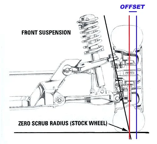

@TeCKis300 is right. I'm re-posting something he mentioned on another thread that opened my eyes to the whole offset/scrub debate. I think this should be converted into reference diagram for anyone deciding on wheels and tires.
Wheel 0 Offset Point (Estimated)
31.2 " (Stock)60mm
32.7" (RW)50mm
33"48mm
34"40mm
Using this as a reference, you can decide what compromises you want to make with regard to positive or negative scrub.

That seems off 🤔 So on my 100 (though the calculations are the same) I run 295/70R18s (nominal 34.3") on +60 OEM steel wheels. The offset required to meet factory scrub is -13mm. So that table doesn't seem to be consistent, as that would mean I need more than -20mm. Are my own calculations incorrect?
Unfortunately on the semi-float rear in order to maintain hub-centricity with the steelies I can't space more than 7mm, which I've done. I could use maybe another 5-6mm, but I've called it good being a bit negative-to-factory scrub.

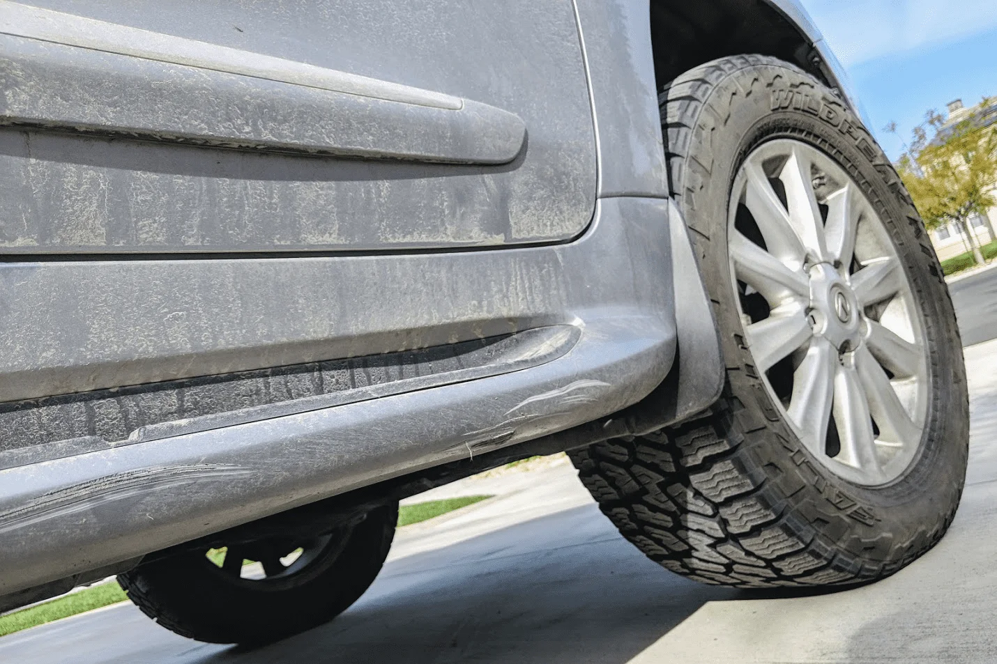

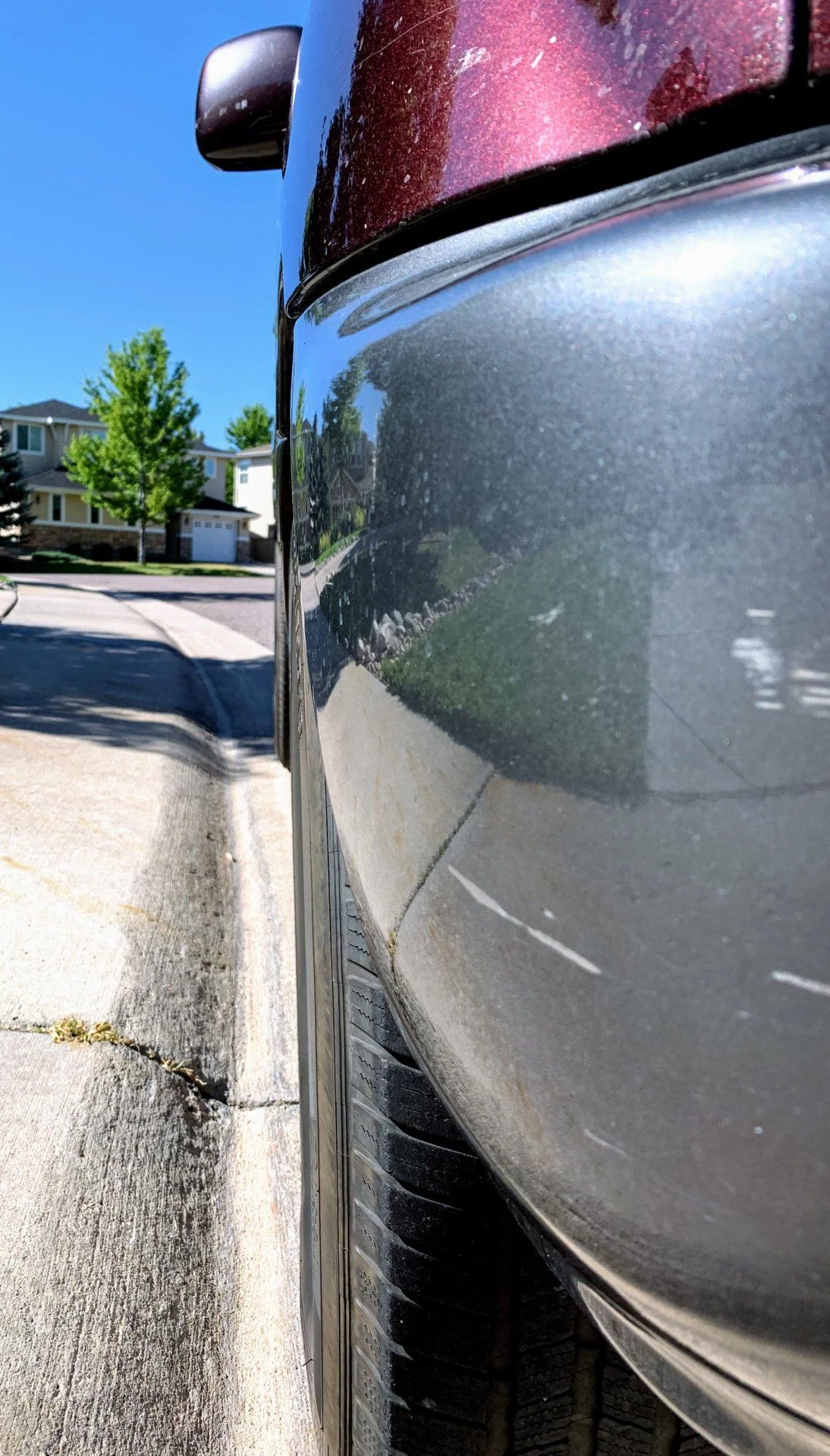

As a point of reference, my stock 20x8.5" 60mm offset wheel, with 1" spacer (~34mm effective offset), and 305/55/20 (33.2"x12.3") tires. Pretty flush with the side of the body and I've not had any issue with rocks kicking up damaging the paint on the vehicle. Or the trailer I tow.
You can also see where it's helped keep terrain off my side steps in particular, because the tire is the widest point by a tad. I would have sustained more significant damage if my tires were inset in a pinch or side sliding situation.

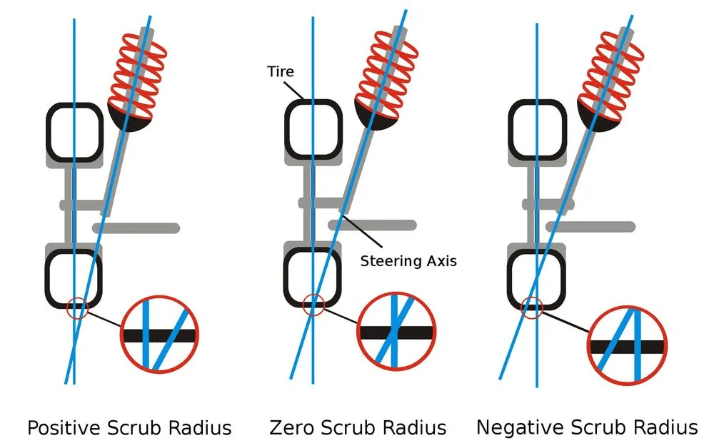

Kingpin angle, aka steering inclination angle, is the black line in this graphic. Critically, note how it intersects the mid-point of the tire at the contact patch. That is the "hinge point" of the tire as it steers.
Here's what scrub radius looks like when KPI doesn't intersect that point. The resulting effect is that the tire will scrub and lose traction as it turns. Potentially causing a loss of traction in low grip slick road scenarios. You'll notice it in tight turns in a parking structure for example with the tires squealing. It will pull on the steering as significant acceleration or braking force is applied. Steering effort will increase.
Right...but do we know the actual value of the angle is? Asking because my own KPI constant might be off and is critical for proper scrub offset calculations.
